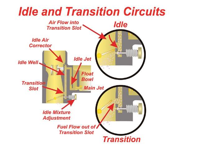

Eddy carbs will handle up to 10 psi they say keep them at 6. Stock mech pump will be around 5-8 fluctuating from cam and rod. If your eddy is floodung you either have too big of primary jets or ykyr timing does not match your air mix. Eddy carbs are good reliable street carbs. And typicly take very lite adjustment. Also check you thrortle linkage to make sure you not going wide open at 1/4 throttle. Also most avs eddys can take dual feed lines this would also help if jets are too big and or idle circuit is too rich. Save a ton wirh simpme stuff unless you just have ro have a holley. Hopefully they have fixed the power valve thing those used to all ways blow out on me usually right in the middle of a race or showing off too lol.
