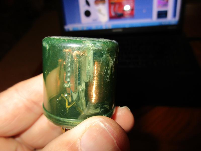

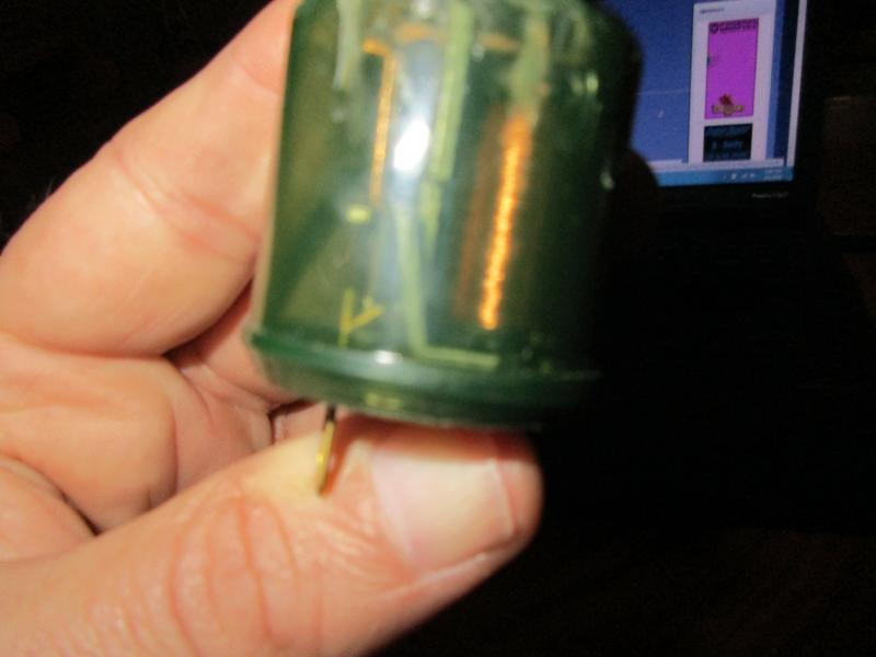

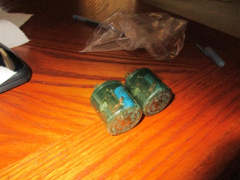

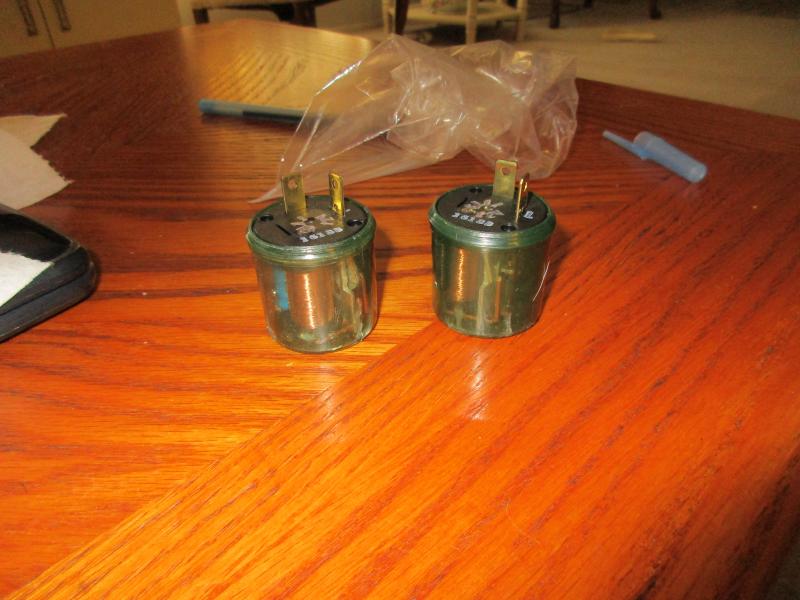

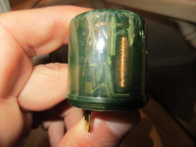

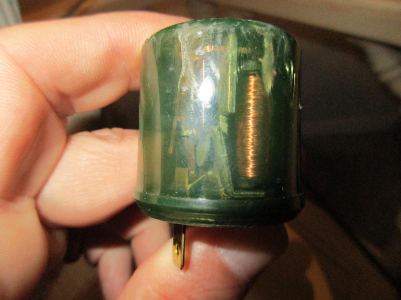

I put the old flashers in. Drove car and signal lights work normally now. The Heavy Duty Flashers failed. The pictures show a metal strip burned up in both of them. Thanks for the help guys
