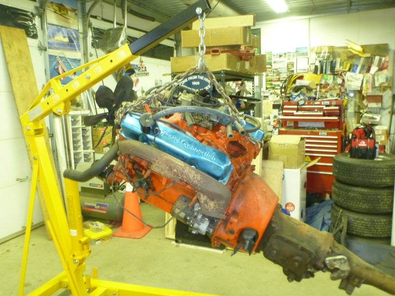

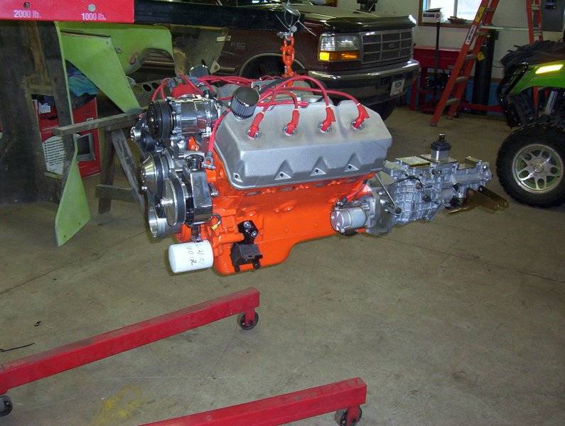

I use them all the time. Hemi and 5 speed all in one. Just use good bolts and make sure to use all the threads.

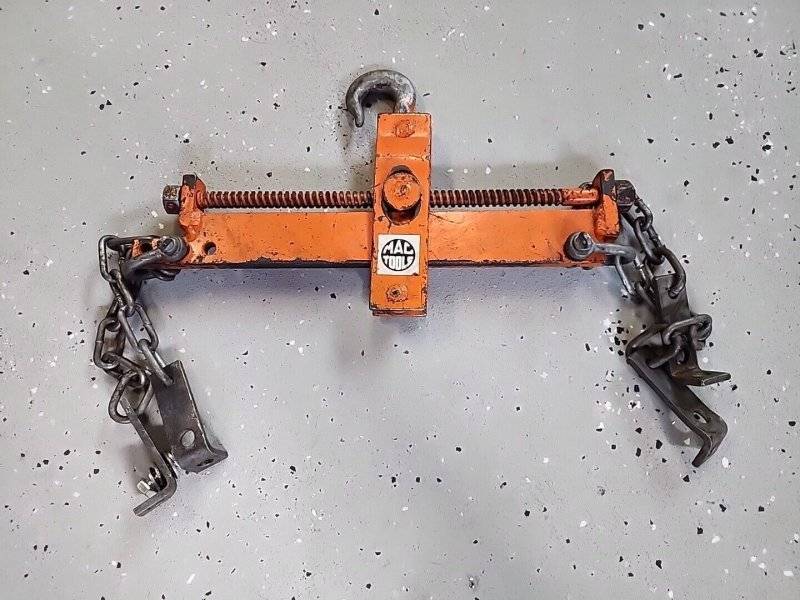

I've used them a bit, but I prefer using a leveler attached to the heads or intake-head bolts. As has been said, it's the not bolt strength to worry about anyways, but rather the threads in the soft aluminum. Send the bolts as deep into the intake as you can and worry-B-gone.
I have used them
and simply dont trust them
I bought an engine cradle that I can crank the balance and thus the angle of the engine as I need to
