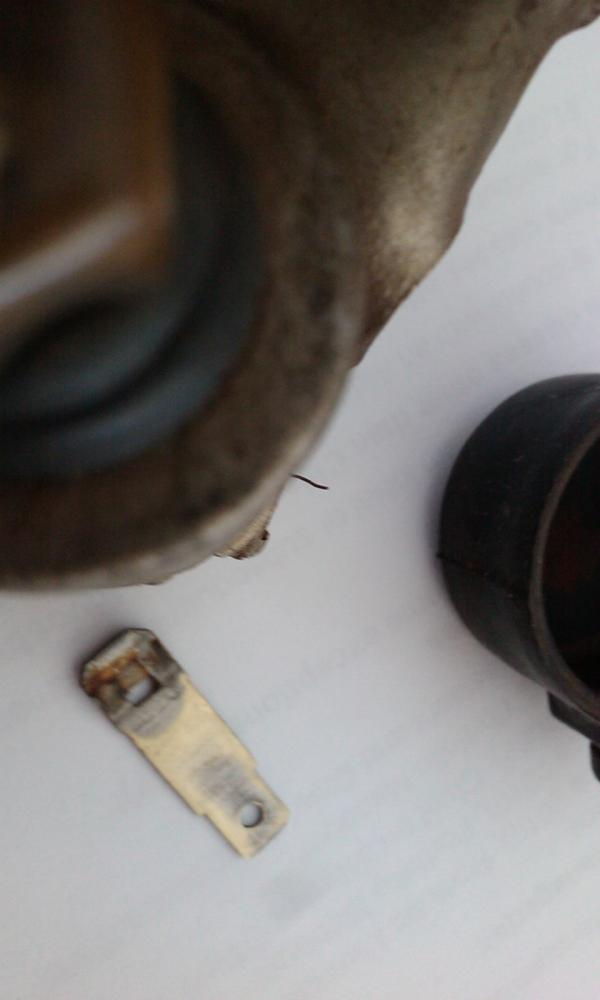

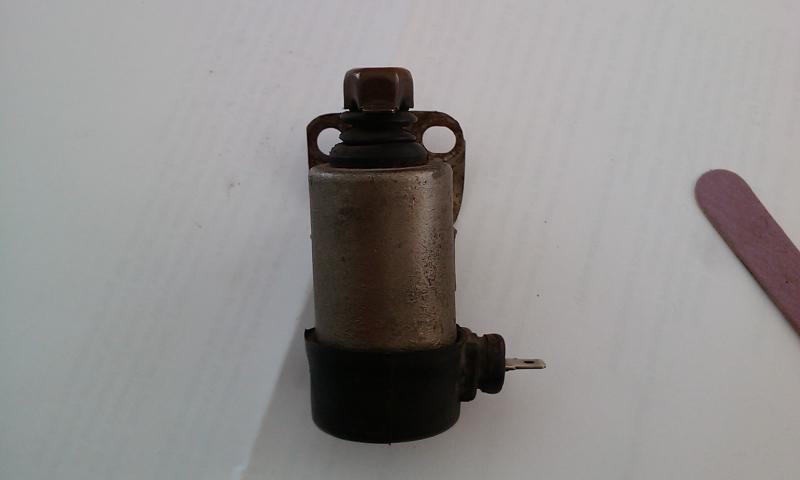

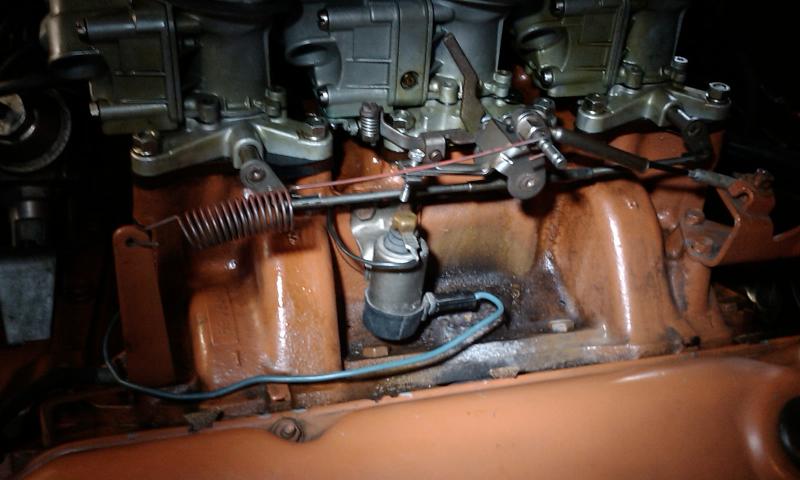

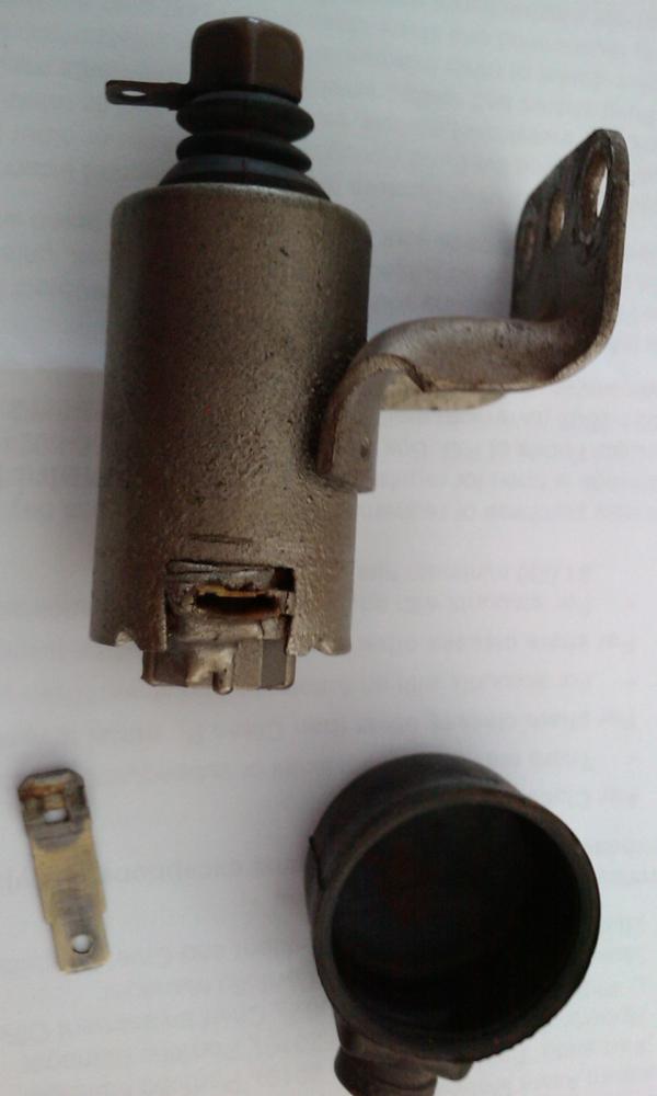

Started my car today and when it came off high idle it would barely run (very low idle) so after investigating saw my idle solenoid was not working, pulled off the connector and the spade that goes into the solenoid came with it (oh **** i thought).

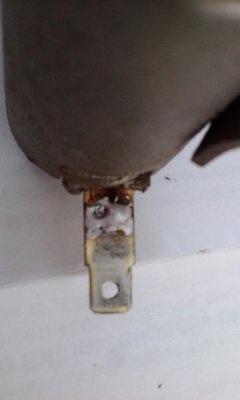

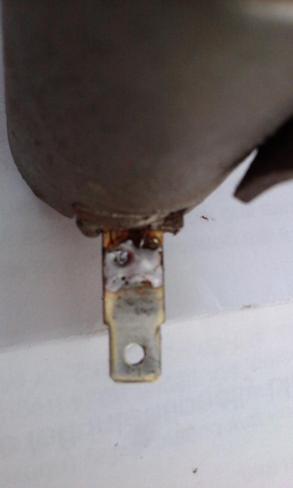

pulled it off and found the wire that was attached to the spade and tested with power supply and it worked so I cleaned up the connector an tinned it with solder, re installed it and soldered the wire to it.
All is now good again in mopar land.
