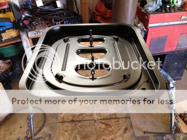

nothing wrong with a clone. mine i guess falls under a modified clone look. lol does have the real deal parts, air cleaner, hood, 4.10 dana.
Nice! Where did you get the correct air filter base that seals to the hood?
link to hood seal http://www.dalescudashop.com/1912blioffho.html
mines an original base, they are very hard to find but do pop up every now and then for ridiculous prices. i think that is probably my favorite part on the car. just looks so cool.
here's a reproduction that is very close to an original. only a small percentage of people will ever walk up to your car and know the difference.
http://www.shakerhood.com/products.php?id=RoadRunnerParts
this is a great site for info if your into A12 cars http://a12mopar.com/yabb/YaBB.pl

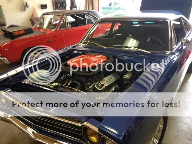

68 Hemi GTS my GTX will be almost a twin to yours B5 with black vinyl top. Same rear tires Dana 3.73. I also like the colored headlights, thought about doing mine in blue.
Gary, just read your post about the 6bbl set up purchase. If it were me I'd buy the metering plate & bowl gasket sets for them and you should be good. I suppose you could hook up a electric fuel pump to the set up before you install the intake and bench test it for leaks. Would be easier to work on.
here is my buddy's 70 w/ blue high beams for reference...I actually prefer amber lights w/ a blue car...my old 71 in the background
