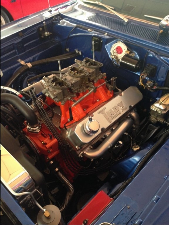

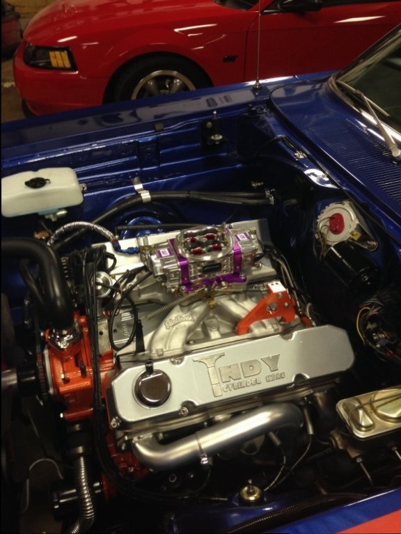

I went 10.95 with mine first time to the track this year with the new motor. tech guy said no more passes unless I put a roll bar in or come back for no Et race. I may go out this sat for the no ET deal, I currently have a 1050an carb on a tm6 I've been playing with. Would like to see how it stacks up to the 6bbl.

Just curious, how old of a TM6 is it? Did you weld up inside intake bolt holes & grind the runner straight?

early 70's intake, i more less put it on the car to play with the 1050 carb i built. i did some port and plenum work on it. I'm not real concerned about the indent's, if i get serious about a single plane I'll step up to an indy or TF. The TM6 didn't cost me anything to try so that's why its on there. i figure I'd run it at the track for an idea of how it works. Butt meter says it strong but its hard to tell on the street as fast as the car is. I'll probably put the 6 pack back on for next year. it looks a hell of a lot cooler.
i also run a 4412 center, and the 10.95 was driving it to the track and running through the mufflers. :thumbsup:
I got good results from my TM6, welded the outside dimples & ground the runners. Of course had to angle drill the intake bolt holes. The combination with an 850 DP & my 452 low deck worked really good. My heads were 906 or 915 ported by me.
