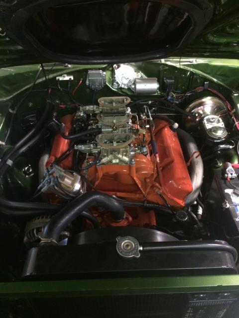

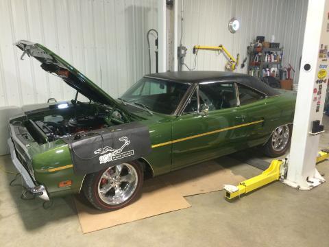

IMG_0988.jpgI gotta add that I originally thought his cam was a little big, but after retuning it I see it is just about perfect for what I was looking for for mine. BTW heres some pictures of Jeff's car.

View attachment 252535I gotta add that I originally thought his cam was a little big, but after retuning it I see it is just about perfect for what I was looking for for mine. BTW heres some pictures of Jeff's car.
