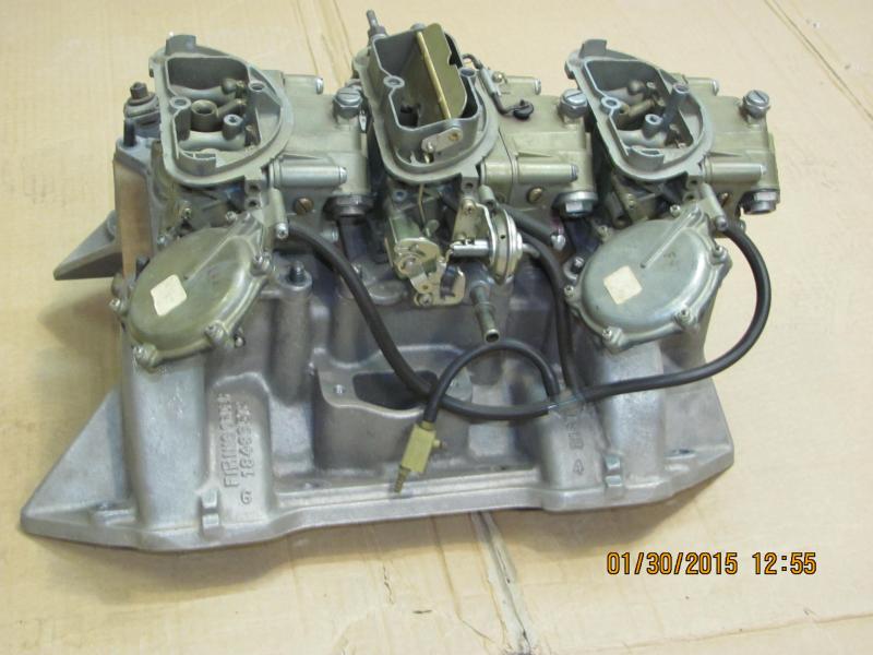

Sorry to hijack my own thread. Lew has been of great service and all his advice has been spot on. I also just purchased a new 6 pack and am looking forward to getting on and running. In our case the timing was a huge culprit. I also believe the milder the cam the easier it will be to tune. We have yet to drive the 70 RR because of wet weather here. As soon as we do I'll reprt back. I don't expect any surprises. I believe it's now to the point of small amounts of tuning. IMG_20150324_164432.jpg
carbs look good! i've messed with these things since 1970. i've ran them on 383's and 440's. i've tried the stock vacuum carbs, mech carbs, and corvette carbs. learned mostly the hard way because there isn't any good tuning info out there. a lot of bad internet advice. you don't need to throw a bunch of money at gadgets and carb services. always keep in mind that a 6-pak isn't a race set-up, but the near perfect street/strip intake combo. unfortunately i'm not running a set now but hope to get back into it in the future. i do miss the 6-pak!

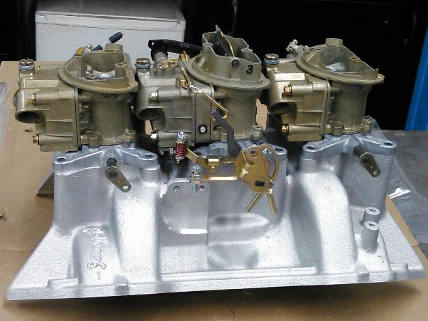

Here's a pic. Unfortunately this setup was put together almost 40 years ago. Don't know where the valve came from. Sorry
