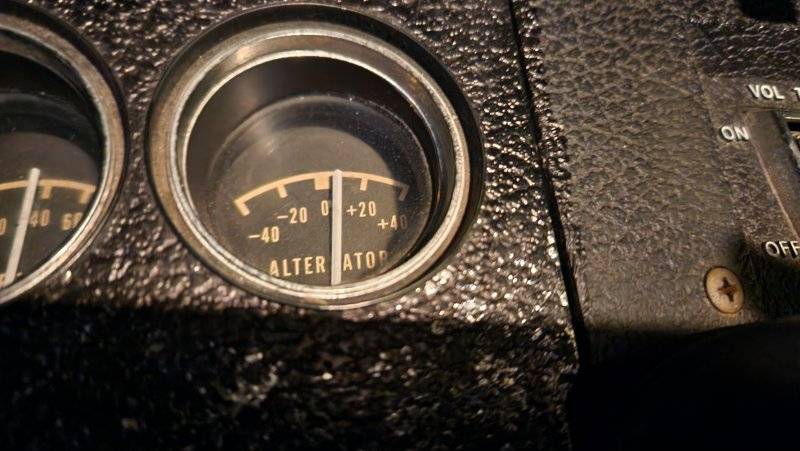

My car starts out it's drive pretty well, but then the more I drive, the lower the idle gets... then the car acts like it wants to die. Putting it into neutral and resting my foot on the gas pedal seems to help a bit. This is after just a few minutes of driving. Other symptoms that may or may not be related:
1. Speedometer intermittently bounces to +20-30mph and back, getting worse the faster I go. On the freeway, it spins waaaaay past 100mph and back, super fast. It's kinda funny but not.
2. Voltage gauge seems to read a bit lower than I remember. When I shut the lights off, it jumps to +20 for a sec, then back to what you see in the pick below. That seems normal-ish, I guess as demand on alternator is suddenly reduced.
I've driven, worked on, and built a ton of cars, but never worked on anything this old, so I post silly things because I'm not familiar with what systems of these cars are related/dependent on each other.
Ideas? Do I run a voltage check from the post on the back of the alternator? At the battery? If I need an alternator, how do I know which I need (I do NOT trust my local auto parts store)? I think I've read there are single and double post. Internal and external regulators? Sheesh, old cars LOL. I'm spoiled and used to just buying the ONE part that fits my cars... :lol:
Thanks, in advance!
My voltage gauge at idle and while driving:
That's an ammeter and your description of operation is totally normal.
The speedometer issue is unrelated.

Knowing it's not a voltage gauge makes me feel a bit better that it's not reading higher. I've never had a gauge in a car reading amps, so I have no idea what to expect from it.

A proper Ammeter reading would be with needle centered at 0. It will show a little charge after starting, then should settle to 0. What is the condition of your battery?. Depending upon ignition type a weak battery/charging system could cause your issue. What is your voltage at the battery with engine idling?

Amp meter readings seem normal to me. If it was showing a minus it would be cause for concern.
