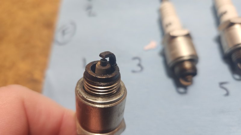

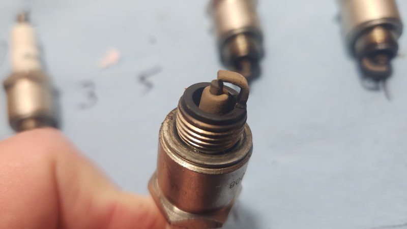

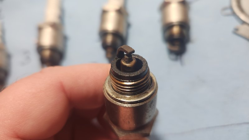

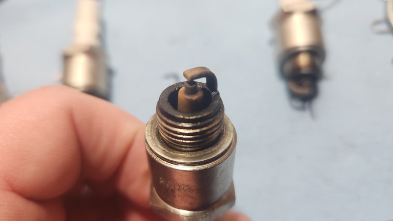

FINALLY had a chance to get out to the car tonight. Here are the plugs starting cylinder 1 going to eight.
One of them looks to have oil on one side which makes me think I have a leaky valve stem seal.
Hopefully tomorrow I will find time to do more testing. It seems I lost my vacuum gauge so we'll have to go get another one.
Plugs should be a '5' heat range in NGK.
These are Champion, or something like that.
I just put NGKs in. NGK V Power Copper Spark Plug 3332.
I'll look up their heat range, but they were listed as OEM equivalent for my engine.
Or specifically: Champion RJ-12YC or Autolite AP-85 or AC R43S or Mopar P34P OR I use either Champion UJ-11G non projected center electrode gold Palladian center electrode OR Champion HO-8A non projected center electrode platinum fine wire, cut back design. Both are excellent design, broad heat range. 3/8" reach......smooth starts, excellent idle properties (@ ~ 1200 rpm)......there is nothing that says "you must use projected center electrode plugs".....I use what runs best.......regardless of what the general consensus says.....including what my "buddy" thinks........
