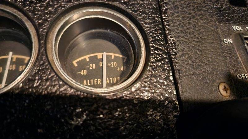

1. Speedometer intermittently bounces to +20-30mph and back, getting worse the faster I go. On the freeway, it spins waaaaay past 100mph and back, super fast. It's kinda funny but not.
2. Voltage gauge seems to read a bit lower than I remember. When I shut the lights off, it jumps to +20 for a sec, then back to what you see in the pick below. That seems normal-ish, I guess as demand on alternator is suddenly reduced.

My voltage gauge at idle and while driving:
