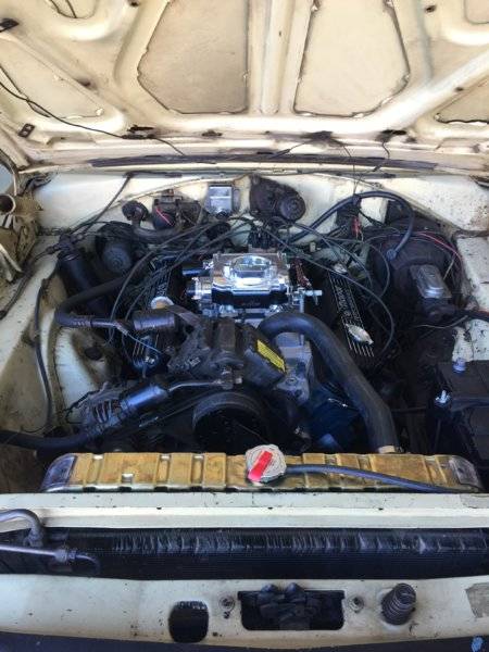

So it looks like the Igniter connects to my Ignition #1 wire where I just added my new electric choke.
I would like to fuse the new electric choke & Igniter circuit. The choke should be less than one Amp.
Question how much current does the Igniter draw nominally? I dont see anything on this anywhere......

She is ready to fire up. I DID have a lot of trouble getting the dizzy cap over that honken Pertronix rotor. Its a snug fit........ I assume a snug fit will be or. My guess is that rotor spring contact is FULLY compressed............. its a stock tan no window dizzy cap too.
Should go on as easy as with a points set. Did you get the hall effect collar pushed all the way on? The rotor sits in it so if it wasn't all the way down the rotor will be too high. Shouldn't have any resistance putting the cap on...
Thanks man...Ok I will yank it out and inspect it darn....

Yup appreciate the help. When I get back to work on it I will check it out. I swear I pushed the collar all the way down. The rotor is noticeably larger but I did not measure it at the time....
No go the cap does not fit without full spring compression. Ring all the eay down and the magnets ARE in alignment on both pickup and magnet. I am wondering about this cap its old. Going to see if a nee fits any better.
Maybe the rotor is being held up by the collar? Is it fitting down inside the rotor cutout or maybe hanging up?
Ok well I guess I did not seat the rotor down all the way. I took it appart 3 times and the third time it clicked down. That was all it needed. Thanks so mucj Threewood for encouraging me to check it out. It didn’t seem right but then again many things dont on Mopars lol.
