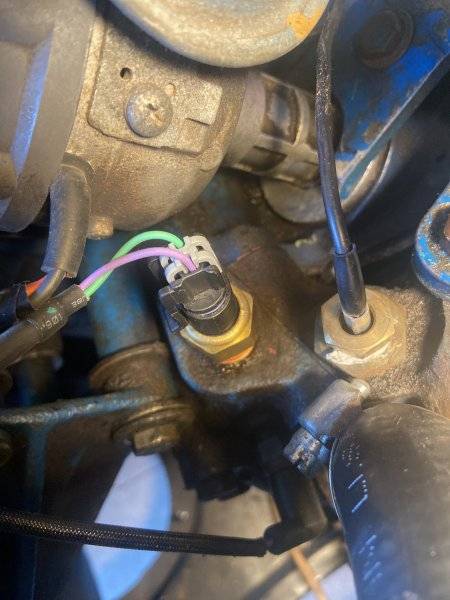

Thanks for all the replies. I discovered a few things in the meantime that confirms much of all the input I have received. Turns out the OEM gauge was connected to the water pump housing, drivers side 1/8 NPT sender and so still operates perfectly. The larger one on the passenger side was actually driving the electric cooling fan that was installed by the restorer. This one has been replaced by the Holley Sniper unit, so now the cooling fan does not operate. The good news is that the Sniper can also control two fans so I have added a relay/fuse panel to take care of that. BTW, the engine fired up successfully for the first time in a year with the new Sniper EFI installed!

pic of sensor installed?
