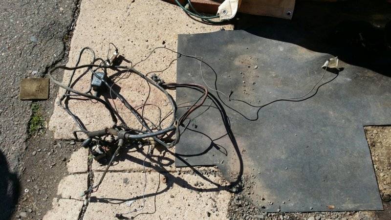

Old engine bay wiring, might have to reuse it.

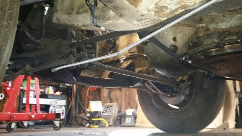

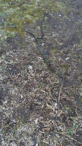

One of the old transmission lines

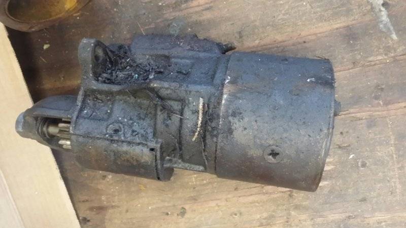

Old starter

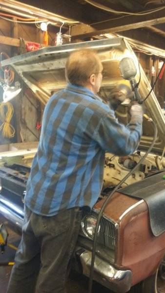

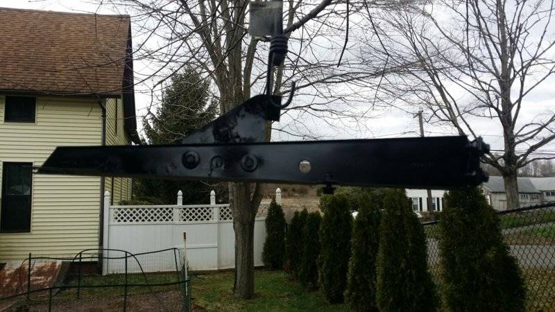

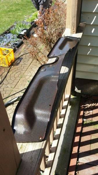

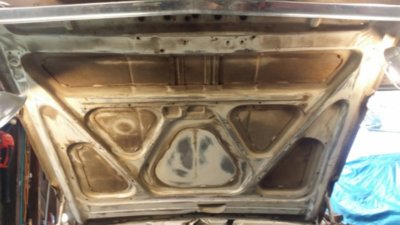

New Update- Today March 27, 2020. Starting to sand the hood to prep it for primer then paint. Sanding with a sand wheel, and what we can't reach with that we will use a scotch brite "scrubby" pad. All in all, what we can't get with the sanding wheel will be done by hand.
My stepfather sanding the hood to prep it for primer
After some sanding, here is the result. There is still plenty more to do, this is just the start

Awesome work Eric!:thumbsup:
Thank you for the compliment Hank, I appreciate that. More work to be done today I think, update on that later or maybe tomorrow. I'm just the documenter in this project my stepfather is mostly doing the work, since after all it is his car. And just about everytime I ask him if he wants help he says no thanks anyway. But obviously if he needs help I'll help him out.

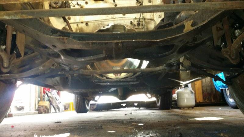

That master cylinder looks like it might be for a 4 wheel drum setup?
Did you take the lower control arms off?
Be careful with the trim on the front of the hood.
Almost impossible to find that piece.

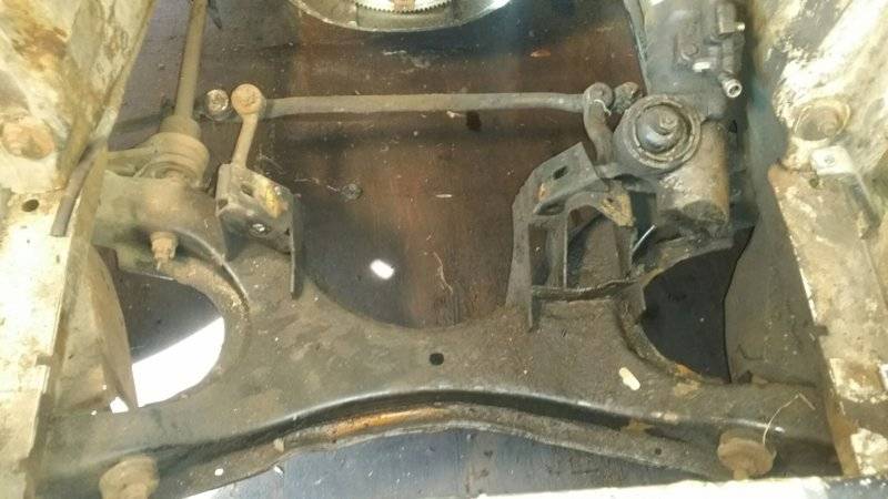

The master is indeed for a 4 wheel drum setup yes. The chrome piece was taken off already very carefully and was discovered it has a couple small dings in it but no big deal. As for the control arms, they did not come off no. Decided to leave them on as they are a nightmare to get off and the inner control arm bushings looked very good
Yes, but the bushing on the front of the lower arm is likely in need of replacement.
If it's 50 years old, almost definitely.

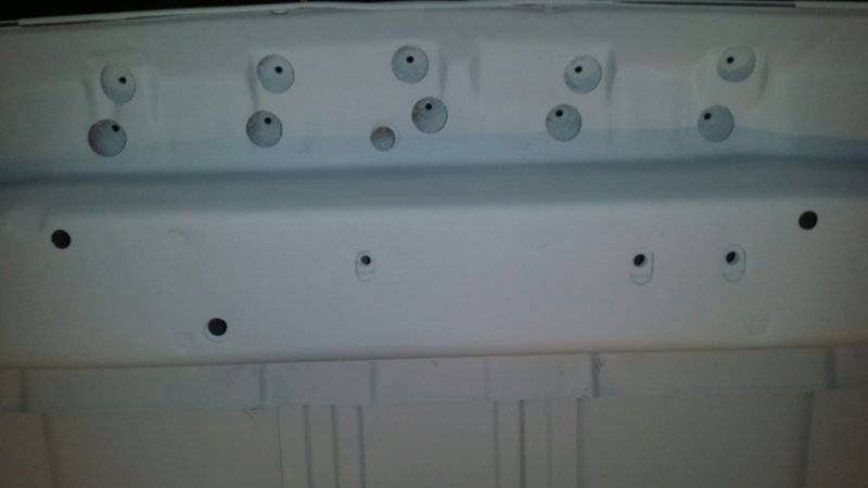

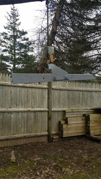

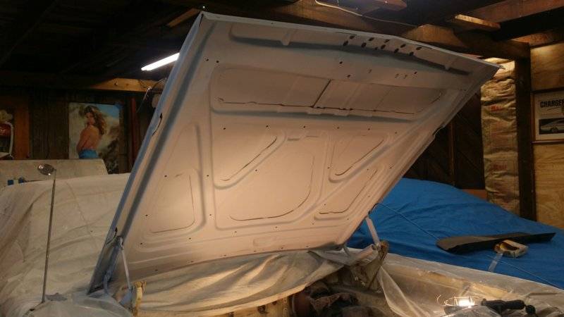

Hi everyone, the Dodge letters on the hood are now off and the hood now has 2 coats of primer on it. The primer was put on yesterday March 28th, 2020. Need new letters as half the studs are broken off as you can see from the picture, but bagged them to save them for now.

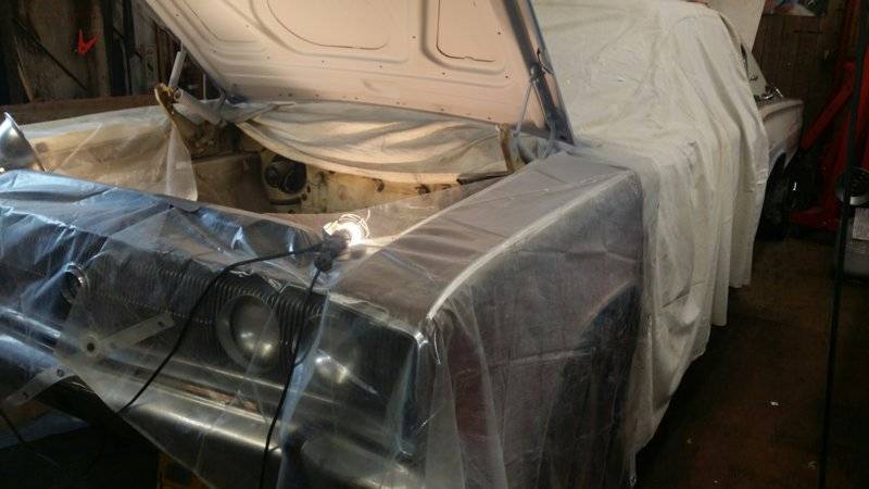

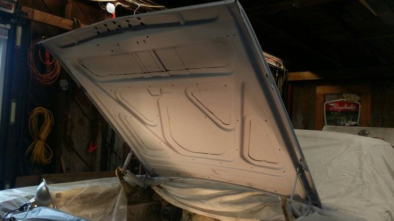

The car is covered and protected just in case
This is after 2 coats with the can above, I think it looks pretty damn good.

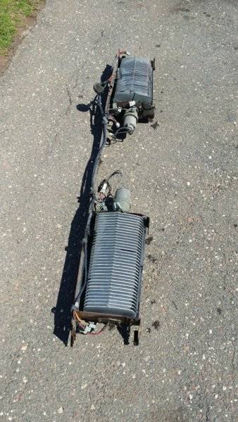

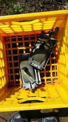

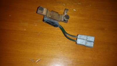

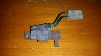

The headlight motors were tested, and they work! These parts in the picture did not work, was looking for some. No need, found some thanks to a friend.

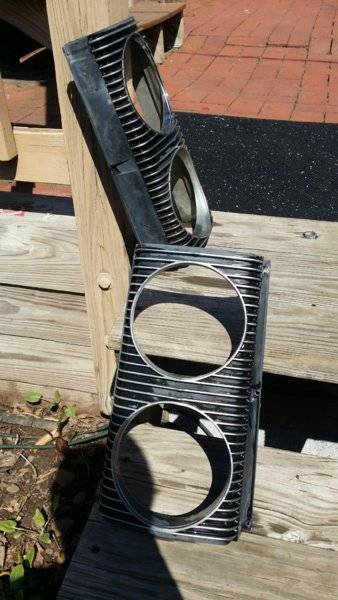

Update- Yesterday March 30th, 2020. Taken all the front lights, chrome and other components off to power wash them and to start getting ready to prime that main area.

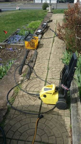

New Update- Today March 31st, 2020. Power washing the parts today that were taken off yesterday. Pictures before wash are below.....
