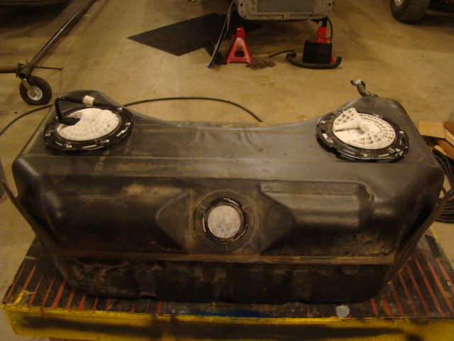

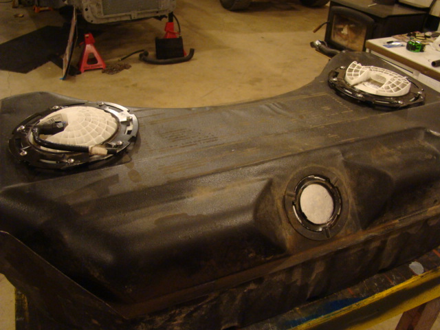

New fuel pumps installed, out of a 06 magnum. Also have the gauges out of a 06 magnum so the:
Fuel gauge works
They will run at the right PSI
No return line, due to constant circulating between the pumps.
Pump housing is desighed to reduce starvation problems
I love me some modern mopars dont get me wrong, but loose that tank. It is way more hassle then it is worth, trust me. If you never plan on doing anything but a stock motor it will work. I put $2000 fuel systems in new mopars all the time. You can improve that tank a ton with a new 392 fuel pump for under $200. I would swap it out from the start if I were you.

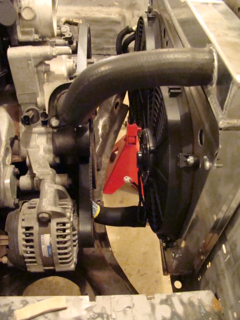

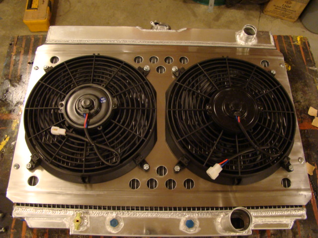

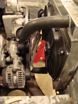

Got My new radiator, its a Champion 3 core made for a 1970 mustang. fits nicely, with both hoses on the passanger side. Used a upper hose from a 05 300c on the bottom. and modified the bottom hose to work on the top.
I Made the shroud out of a piece of stainless steel. DSC04321.JPGDSC04324.JPG
