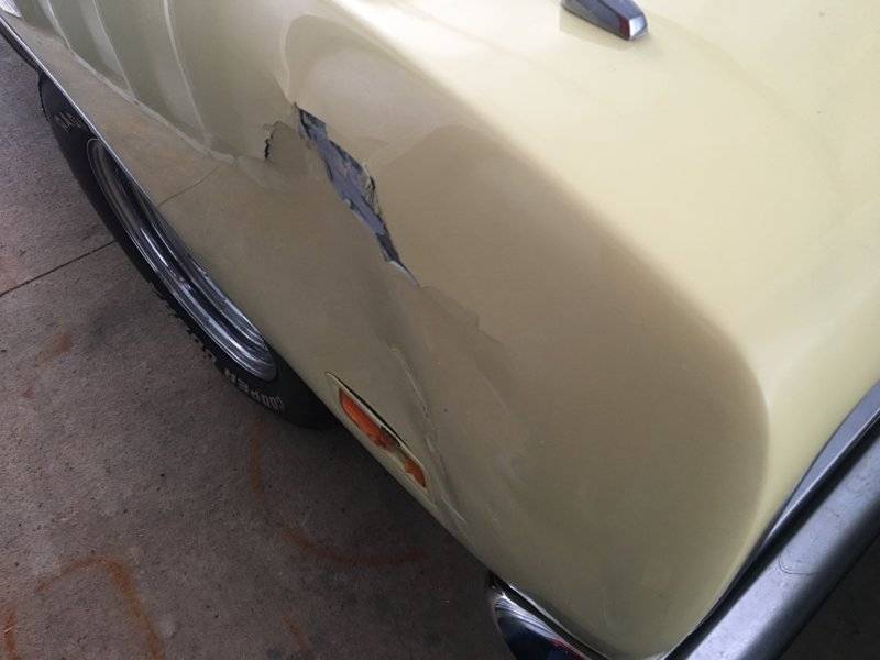

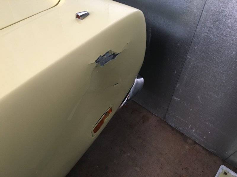

      I've seen a dent just like that removed from paintless dent removal, its just finding a good one. can't even see it unless you know its there took about 45 minutes and $300.00 I wouldn't touch it could cause more damage with a little too much push

        My son had good success with a basketball. Insert stabilize then inflate. It's pretty easy to control. Might be with a try.

          Yep, why I stopped with the plunger bit in a hurry.
          The hairdryer at first did take what I'd estimate to be "half" the dent out just by getting it hot, but then stopped doing anything.
          The plunger bit was quickly abandoned once I saw that the dent (or at least a good portion of it) was popping out, then right back in.

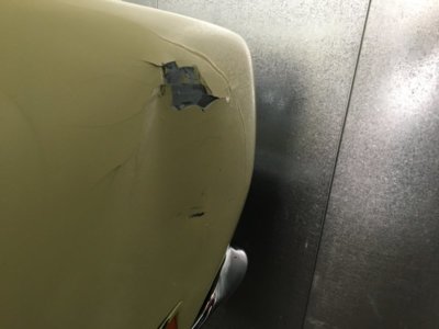

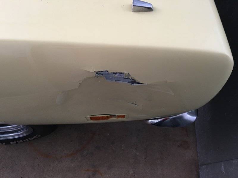

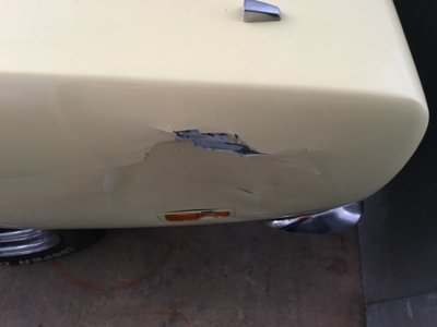

          1st I have seen this Ed.
          Let the PDR guy try. A good one can really surprise you as long as he isn't working near or under filler.
          That said, The ding is very fixable , you have the paint code, A good body man will blend the color staying away from the door and clear the qt. If you have a good painter its going to work out fine.

                            Paintless Dent Removal should be able to take care of that with NO sign that it was ever hurt. Like was said, you need to find a guy who is very well versed in the art, even if it involves taking it to a large city out of your area. I've used several guys with fantastic results. A few I've declined to let touch the cars based on their apparent inexperience or indecision about how good the repair would turn out. One involved a motorcycle tank that had a 2x6 fall on it during an earth quake. The corner put a pretty good crease in the tank. The tech was stoked to have something out of the ordinary and took it on as a challenge to his expertise. Came out perfect... I think it is money well spent to find the right guy and avoid all the problems associated with paint matching. You always have that as Plan B, if necessary.

                              Used Paintless Dent Removal on my wives Stratus. It was right in the middle of the back door. Looked great. Then about 5 years after, that the area started to rust.
                              No rust on the rest of the car. It was like the paint separated from the metal.

                              You mentioned Hagarty, problem solved..... they will easily shell out enough to fix the dent, and paint the entire side to match. Find someone who can handle it
                              if you have to search the planet for a super talented pdr artist.......... he aint working cheap, he may or may not achieve the desired result, and he may not even exist....... if you're gonna spend time, energy, and money; just give it a proper dent repair.
                              remember.... these pdr guys are fixing late model stuff on car lots, and the metal they are used to working with is pretty flimsy.... most of them are hacks, I've seen it all

                                The PDR is worth a shot. We have two very talented ones up here. They’re expensive and worth it. I had a couple of dents taken out of my wife’s beater Pontiac and one out of her new Hellcat. You couldn’t tell where they were on either car. I’ve seen more hacks in the paint and body trade than PDR.

                                  The appraiser was out last Friday. Seemed like a nice enough fellow and told me enough about his experience (he has several years practical experience) that I felt ok with him doing it. I told him all I knew about the damage and especially lobbied him about what my friend had warned about (paint matching).
                                  Without hesitation, the fellow agreed and told me the respray would no doubt include the entire roof, along with the quarter "to the nearest demarcation line" (meaning folds/seams I guess).
                                  He asked if I was ok with Hagerty cutting the body shop the check, assuring me they would not be paid until I was happy with the work.
                                  I think it's going to be ok. Waiting on the process now.
