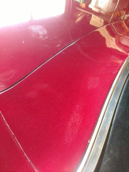

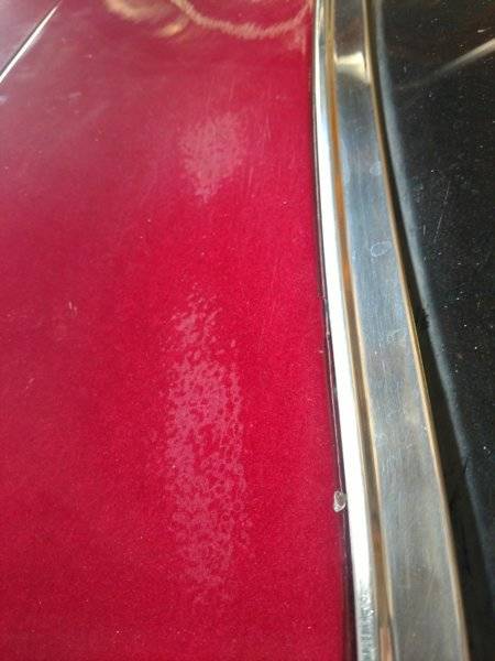

I don't want to piss on their parade, but there's some leftover residual, well, residue left at the base of the roof
on all four corners. It almost looks like collected small pools of clearcoat? Kinda like the acrylic mama used to
put on the kitchen floor, if that makes sense.
I got to get something a bit stronger than what I have to get that off.
Thinking polishing compound maybe?
I don't think that's what it is.Could be where they blended the clear coat. Could be adhesion promoter. In any case, if you try to buff it off, it will leave a sharper line where the two meet. It will be more visible. They should have found a line or edge to stop instead of blending the clear coat.
I would bite the bullet and stop by their shop with it and show them what you see. Now's the time to fix it, not later.
Hard to explain exactly - more like random splotches of what looks like a milky/hazy, very thin plasticky substance.
I'll see if I can get the camera to capture one...
EDIT: Now that I look at it up close, it almost looks like they tried to shoot some clear over the old paint in that area and it didn't adhere?
\View attachment 791507
Yes. As previously described, the original (11 years old!) paint job that was half-assed by the previous owner was base/clear, Sherwin-Williams paint.Is it a base coat/ clear coat paint job?
