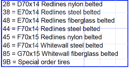

I just used it on my '68 (St.Louis) and noticed I have 43 for tires and you have a 48, which I assume is a typo for 43? Excellent job on this decoding reference, though.
Yes, it was a typo on my part. Nice catch.
where I have 48 = E70x14 Redline fiberglass belted,
It should be 42 = E70x14 Redline fiberglass belted
Thank you for the correction.
I'll see how I can correct it.
I believe your tires would be
43 = 7.75x14 Whitewall steel belted
Thanks again.

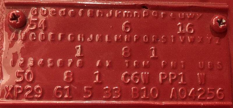

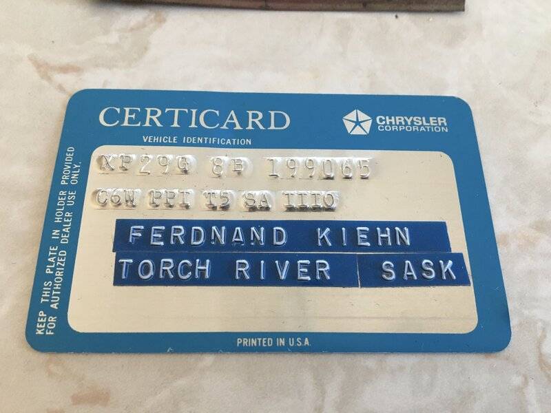

Excellent info and my car is a Hamtramck, MI car. For row 1 the tires I have code 33.. somewhere I heard that was a 7.35x14. Dad drove this car out of the showroom and recalls it having redline tires.
also wondering on the second line of the certicard can someone tell me what the T5 SA IIIO mean?

Excellent info and my car is a Hamtramck, MI car. For row 1 the tires I have code 33.. somewhere I heard that was a 7.35x14. Dad drove this car out of the showroom and recalls it having redline tires. View attachment 1123559View attachment 1123560also wondering on the second line of the certicard can someone tell me what the T5 SA IIIO mean?
I have kind of a wired build...
was ordered sold and the story behind this is the guy who ordered it backed out due to finances. So sat in the showroom. Was ordered as a 290hp 383 2bbl, but when dad saw it and bought it had all the 383 magnum stuff on it. He bought it from the dealer as a 4bbl car. Also was ordered with 2.76 gears which was good for him as he would travel some 500 miles for university at the time usually go home once a month. In the eight years he drove the car he put 148,000 miles on it.
T5 = Automatic transmission
SA = Standard axle i.e. not SG Suregrip
IIIO= November 10th. Same as SPD of B10
Tire code 33 = 7.35x14 white walls.
A Magnum assembly also requires the correct cam and valve train as well as the 4bbl exhaust manifolds. It's more than simply adding a 4bbl.
2:76 gears were standard with the 383-2bbl automatic.
Nothing weird at all. Looks like a pretty standard build that may or may not have been modified by a dealer.

Thanks for the info! It’s really neat to find this info after searching for 20 years.
Weird thing is car had hp manifolds.?? But yes I agree likely the cam wasn’t changed. The original engine went missing back in ‘79 so I don’t have it to check. Just have another 2 ‘68 383’s that are non hp’s. Although when the engine blew in ‘79 maybe the hp manifolds were added then? I only showed up in ‘83 so I can’t say. Dad had sold the car to his cousin in 79-80 the car got parked in late 1980 and sat in a wet barn so we don’t know exactly what was changed from then till I got it back in 2000.

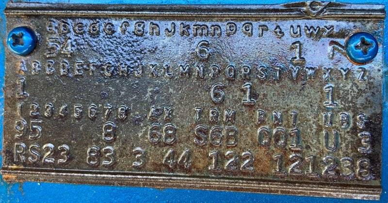

Your car shows a5 and b4 like mine. I just bought this GTX. The decoder shows a5 as center front seat and b4 as bucket seats. I don't understand which seats this car is supposed to have. I guess I'm asking what a center front seat is. Thanks.
Buckets were standard (S6B on the tag).
Optional was a console OR a fold down armrest 'buddy' seat that went between the bucket seats. b/5 indicates the fold down arm rest.
Click the link to see an example.
https://www.hamtramck-historical.com/images/dealerships/DealershipDataBook/1968/68_Belvedere0008.jpg
