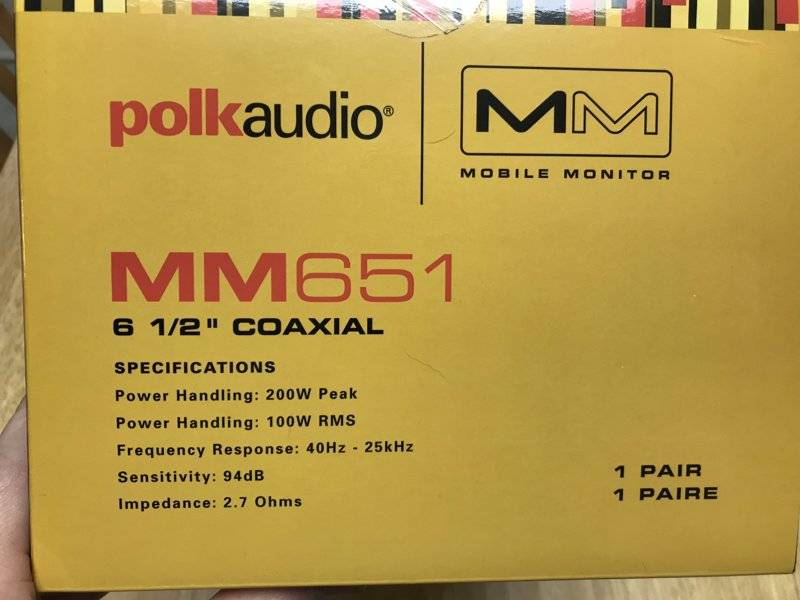

So these speakers sound like crap with my head unit. Sounds like the head unit is maybe the problem?
What head unit do you have? One, they are probably under powered, and two they are 2.7 (just say 3) ohm speakers. Most head units are only 4 ohm capable, so that is an issue there and you could have burned up your head unit. You would need an amplifier capable of 3 ohm operation and 100 watts RMS to operate those speakers correctly. Given that, they should sound pretty good. Also, what vehicle and location in the vehicle did you have them?
100WPC RMS(RootMeanSquare) 200 peak. 94dB efficiency. Think about the formula I wrote. W/these speakers:
94dB/1w 95=2w 96=4w 97=8w 98=16 99=32 100=64 101=128w and 102dB is 56 watts OVER the peak (momentary) power handling capability.

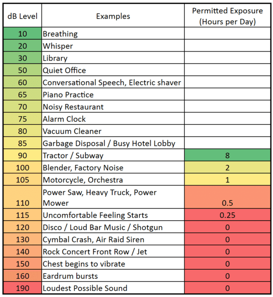

To get an idea of how "loud" dB (decibel) are, look at this chart:
JBL MR-22
4 x 45w
4-8 Ohm
If it (the JBL head unit and the PA MM651 speakers) sounded half a good as my 2009 Ram truck's factory unit/speakers at talking level, I'd be happy. But sounds like total crap a normal listening levels at 1 meter distance.
