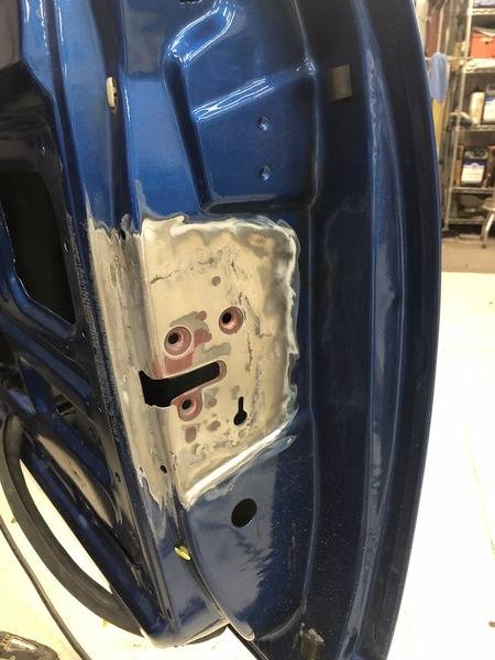

And then on to the part that really irritates me! The body shop was supposed to install the door lock modules from the SRT. They didn't. So cut and welded them in place, fabricated new linkage to work with the RR handle, and changed out the door lock cylinders to use the SRT trunk cylinders so linkage could be fabricated. Now the car uses the SRT ignition key for all locks, and the factory remote operates the SRT actuators.

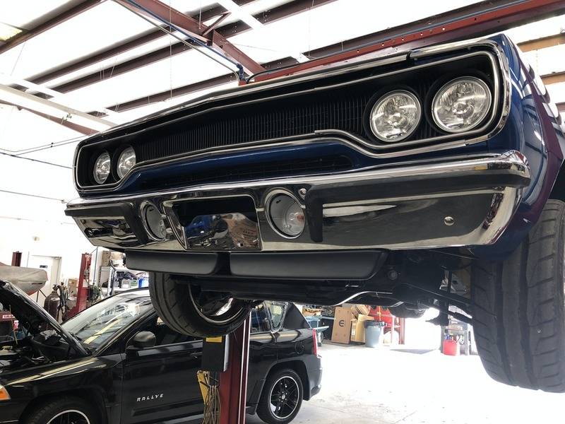

Was going to make a valance for under the front bumper to "hide" the radiator/cradle. Then I realized if it got damaged on a curb or from the road, I'd have to remake it! Decided to install the T/A Challenger plastic pieces. If they get damaged, easy to replace and no fab!
