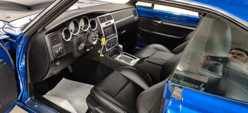

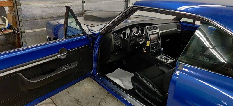

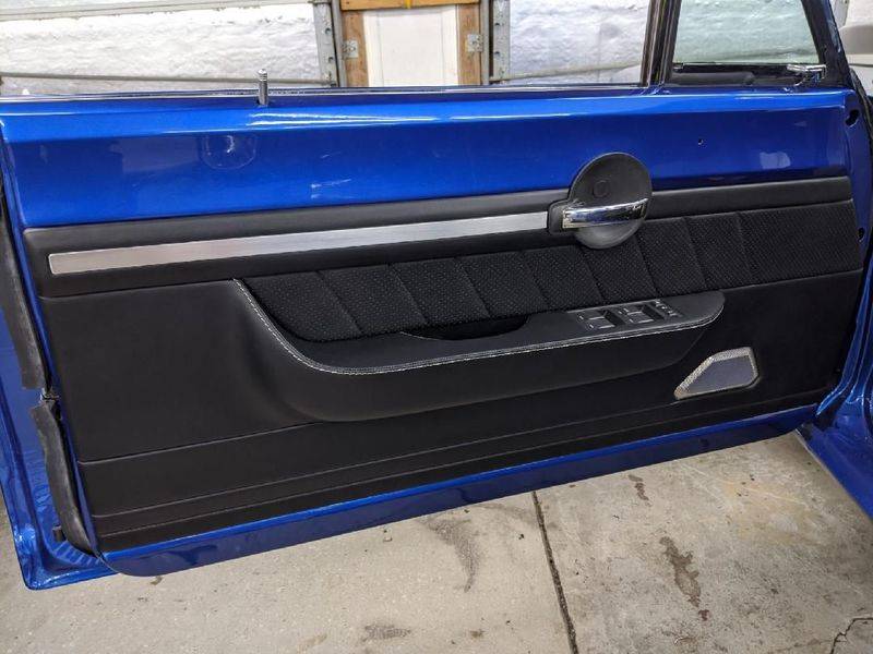

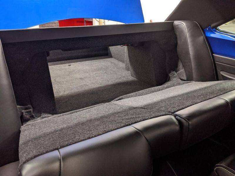

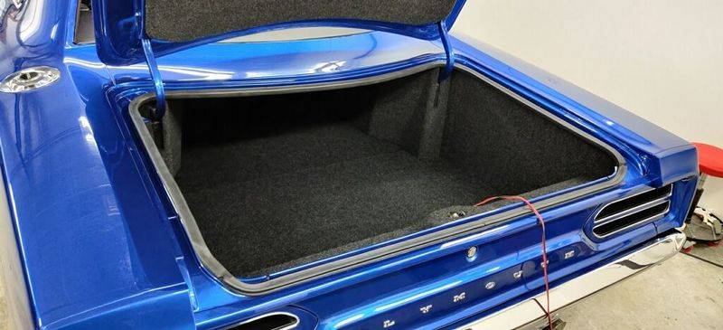

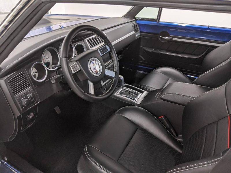

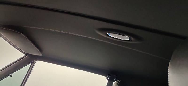

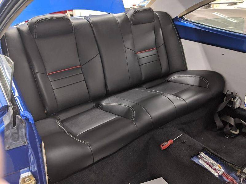

SRT8 Roadrunner conversion, NOT a body over!!
Few more. Supposed to be done next week.

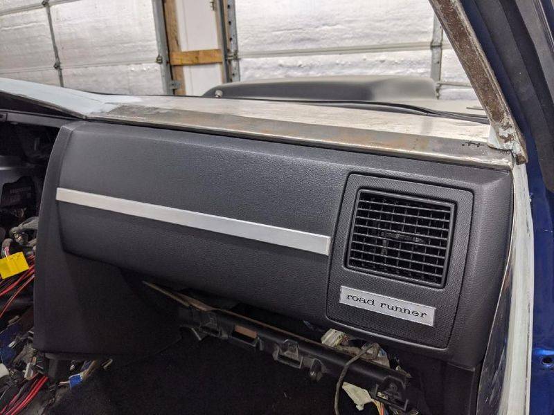

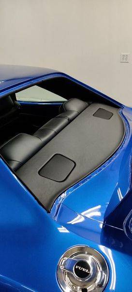

Excellent build ! Maybe I missed it.....how did you handle the fresh air intake box and filter? Doesn't look like it would fit under the 70 RR Cowl area …..
No box or filter. The owner wanted the cowl vents removed, so no place to actually pull fresh air from anyway. The opening is present on the firewall (screened), but without the box to direct it to the cowl, it simply pulls air from the engine compartment. Not a big deal, in Florida we keep A/C on recirculate all the time.
This is a modern engine, so no leaks and no fumes. The hood scoop is open, and would probably feed the fresh air intake pretty well if not on recirculate.
Understood ….

I like the installation of the Challenger fuel fill door in the top of the RR fender. A Side wall fill would have prevented fuel flow into the fuel line to fill the gas tank. How did you accommodate the existing Charger fuel fill line from the gas fill cap – thru the top of the inner fender well? Your pics show you used a 1 inch fuel hose from around the back of the shock tower….but your pics don’t show how that fuel hose connects to the fuel fill inlet pipe that connects to where the gas cap screws into fuel fill line. The Challenger fuel flip cap extends about 2.5 inches into top of fender – then transitions to the fuel fill line which is about 1.5 inch dia where the vent line is incorporated in…total distance from top of RR fender to bottom of this vent in the fuel line is about 8 inches which puts this well into top of the wheel well sheet metal. I see you were able to install the Charger plastic inner fender well…but I didn’t see how you accommodated the rubber fuel line to hard line above plastic inner fender at fuel pump inlet. Did you install a 90 degree hose fitting directly after the vent part of fuel fill pipe? Or do something completely different?
