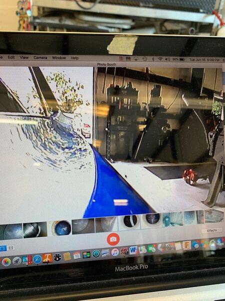

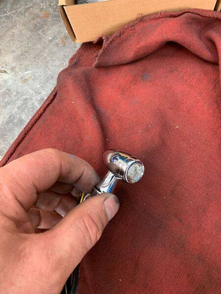

So the last few details getting done. I had originally planned to mount the blinker/blindspot cameras in the side mirror glass. Good idea, but the angle was wrong and couldn't get it where it was a useful image. Plan B. Found these little LED blinkers:

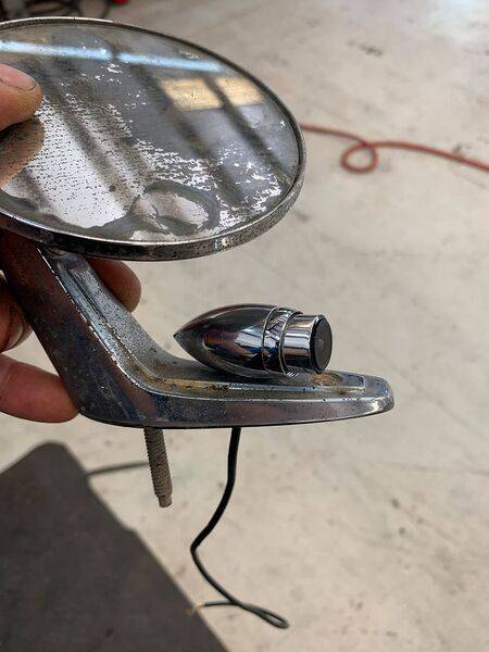

I gutted and milled out the inside to fit a camera, and then removed the base and used a hollow bolt slipped in from the inside:
Then test fit on a junk mirror:

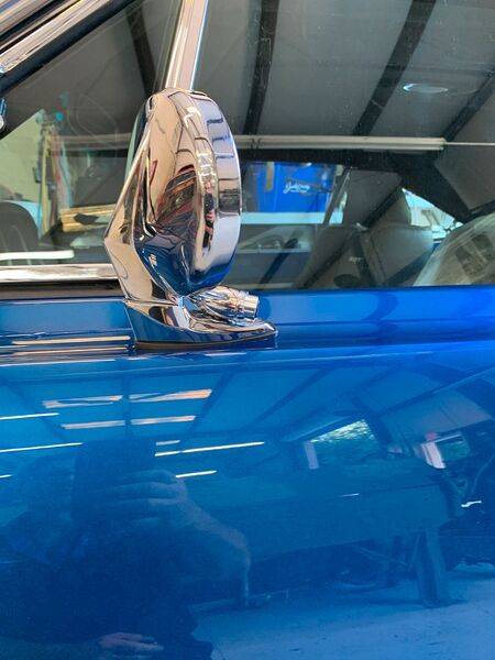

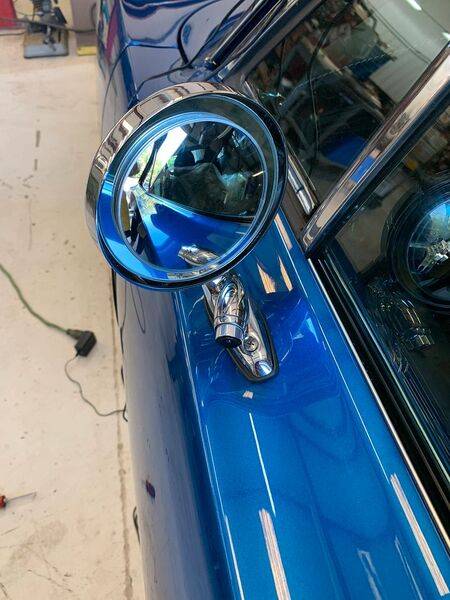

Then mounted up and adjusted. The outer bezel is loose in the pics so I can turn and focus camera. Not 100% on this, but feel it blends in pretty well and provides a solid lane and half of view:

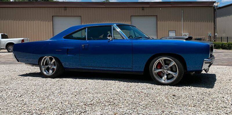

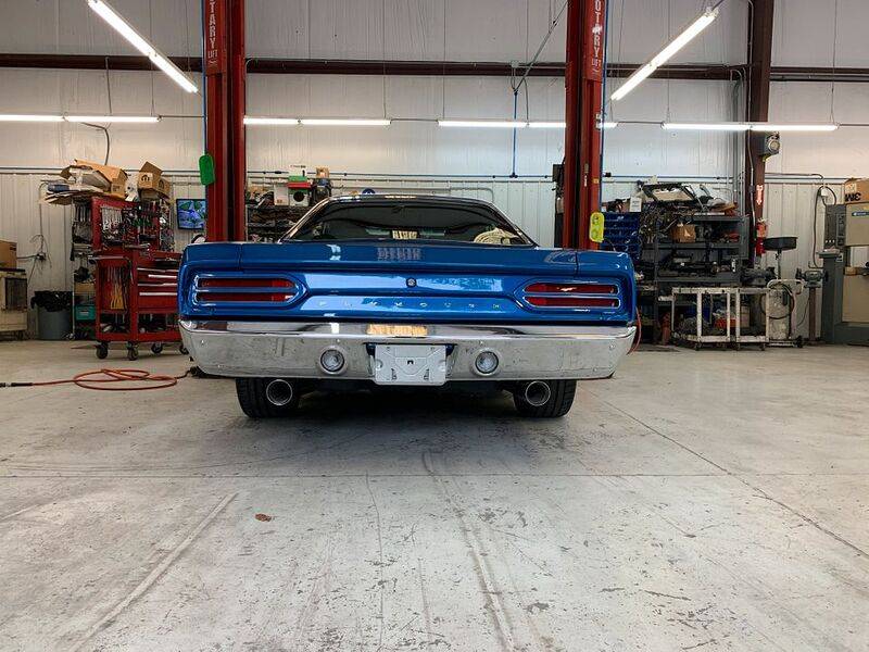

Finally able to do some road testing. My first impression is how incredibly tight the car is. Absolutely zero chassis flex. I work on the late model cars daily, and this one rides and handles at least as good, but seems to be better. Bumps, rail road tracks, etc are firm yet subtle, if that makes since. Again, super impressed with the ride and handling.
Air conditioning is probably what will make this car get driven a lot. 90+ outside, with ridiculous humidity, and I have to turn it down to the lowest blower speed and or turn the vents away. This is such a good problem to have.

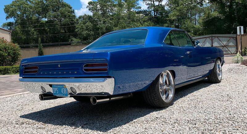

I did have to change out the rear diff. The 3.91 with the short 26.1” tire was just too much. 3k @ 80 mph! Ridiculous fun, ridiculous acceleration, but with the exhaust, just too much interior resonance. Swapped in a stock SRT 3.06 LSD, and much more civilized and comfortable. It is very difficult not to drive this thing 80-85 with traffic, so a gear better suited for that was necessary.
Couple little minor things to address, then this car is finally ready for the owner to enjoy.

Regarding the quoted statement, 3k at 80 with a 3.91 and a 26.1" tire is hard for me to understand because of my experience, seems low...
I put a Passon 5 speed in place of my 833 4 speed, so .70 5th gear and immediately switched out my 3.54 for the 4.10 in my Dana 60. Dropped from 3,500 @ 72 MPH in 4th w/3.54 to 2,750 @ 72 MPH in 5th w/4.10. Although 750 RPMs may not sound like a big improvement, it's night and day. I was "uneasy" spinning the 440+6bbl at 3,500 for a couple of hours on an interstate ride, but at 2,750 I'm totally at ease. That's with 315/35/17s that are 25.8" diameter. IF I decide my wife and I are going to go "road tripping" one or two years, I may put the 3.54s in, but more likely just go to a taller tire.

The late model Nag trans overdrive is only a .83.
I rounded that previous number. Was actually closer to 3250 rpm. Im now 2600rpm @ 80 mph.
