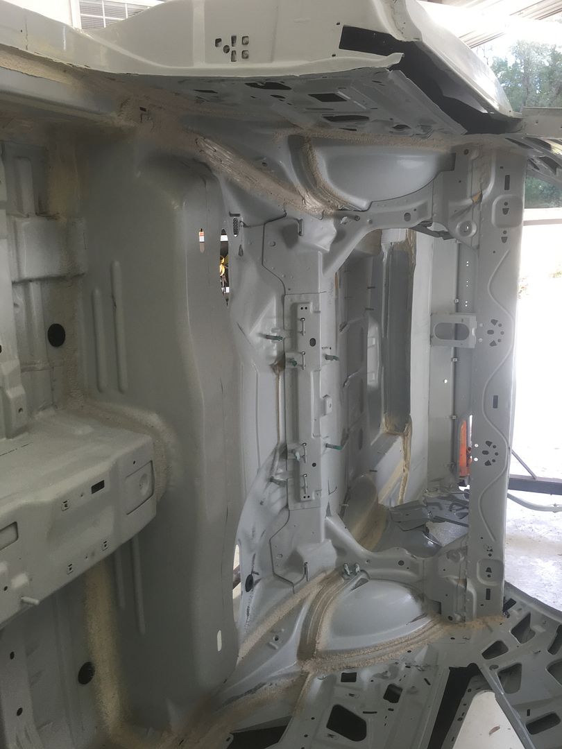

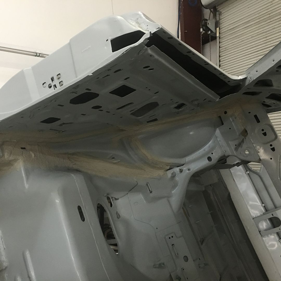

Thanks again guys! Got it up on the rotisserie with plans to seam seal. When I rolled it, and it started pouring out media, I knew I wasn't seam sealing today. Rolled, vacuumed, blew it out for hours. Recovered about 75 lbs. of media. Definitely won't be recommending or using that shop again. So no pics worth posting.
Did a little interior with a new seam sealer gun. It sprays it down like the factory (nice and ugly!). It's inside and covered, so not concerned with cosmetics, just function.

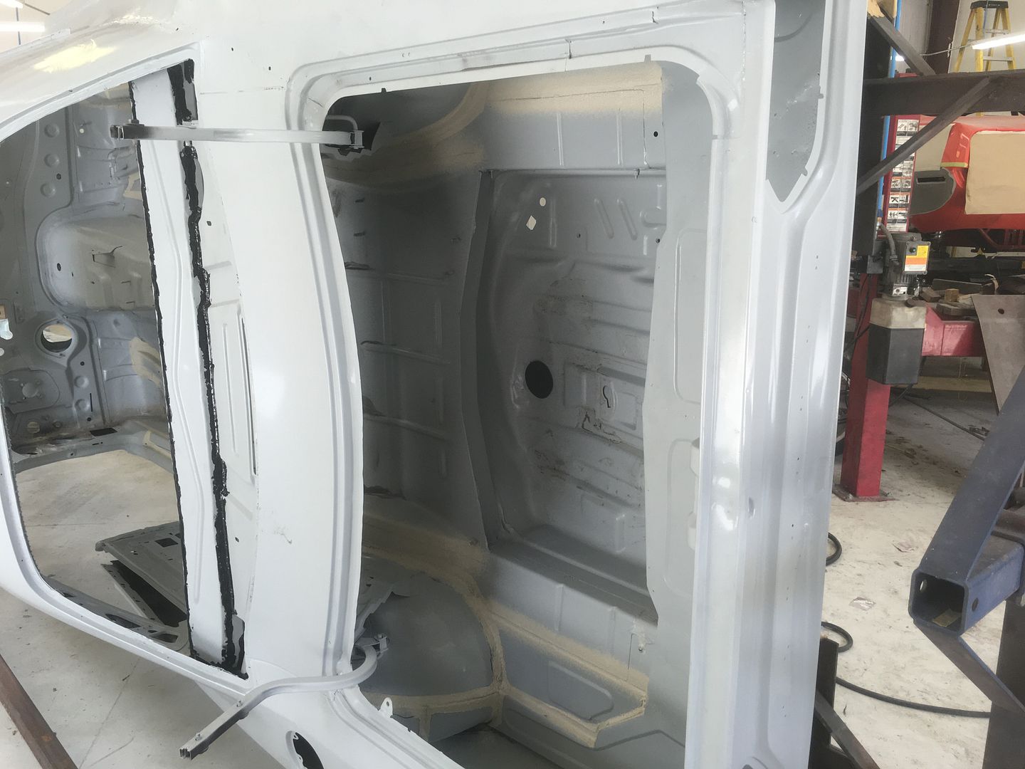

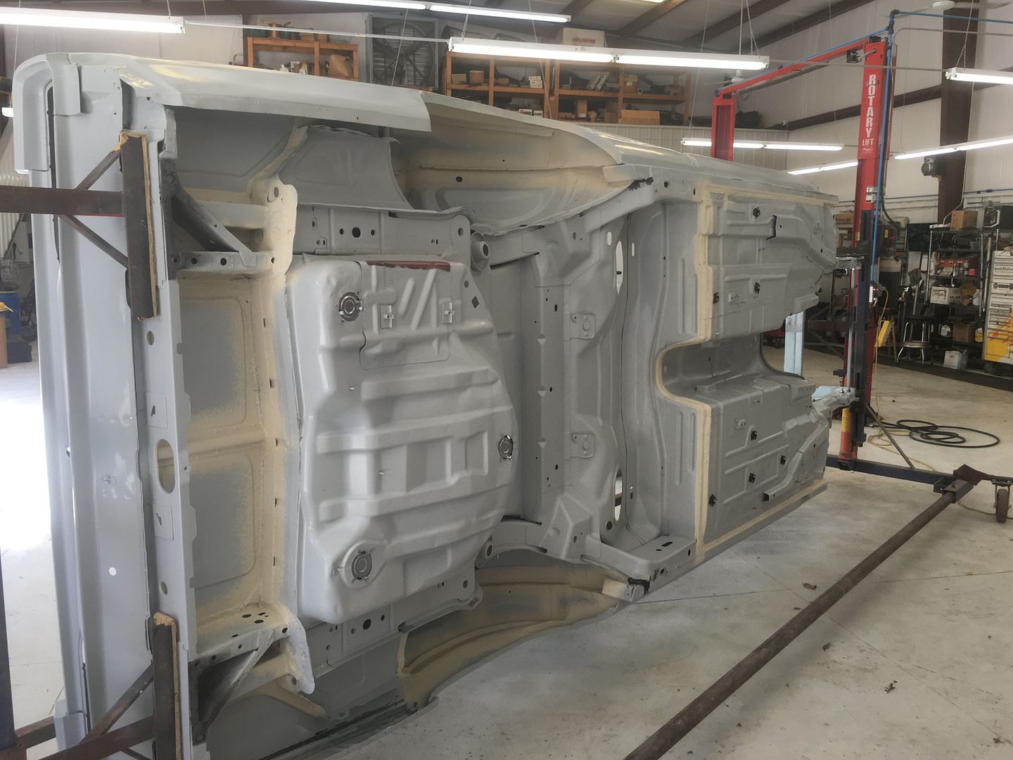

Thanks again guys! Finished seam sealing. Still fighting this damn media. Every time I turn it, I spend an hour vacuuming and blowing. Plan B on the interior. The media is plastic, so not concerned will rust, but I got to get it out and what I can't, needs to be locked down. So going to do a tinted spray bedliner on the interior. This will help with sound deadening as well. Going to spray the bottom with a flat black bedliner. The bedliner material will seal out any moisture and if any media gets in it while spraying, the texture will hide it. This is a driver, so I think this will solve many potential issues.
If you have not sprayed it yet, SERIOUSLY consider using Lizzard Skin. I used this inside and out on my GTX then sprayed 3M Body Shotz over that just on the exterior. Very quiet and crazy heat reflecting properties. Could fry an egg on the roof and have your hand on the inside bare metal and not feel the heat to a level of uncomfortable. Very quiet driving as well.
