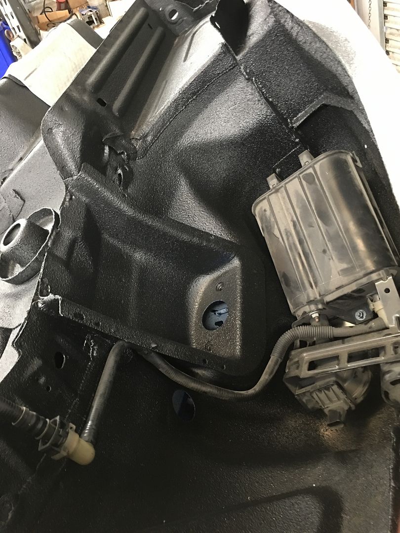

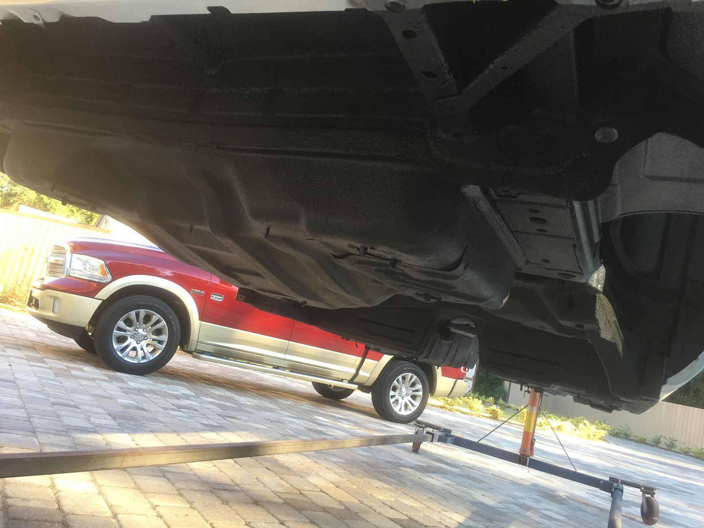

Thanks guys. The bottom. A little "sky dry" for the next few days. Yes, I'm in Florida!!

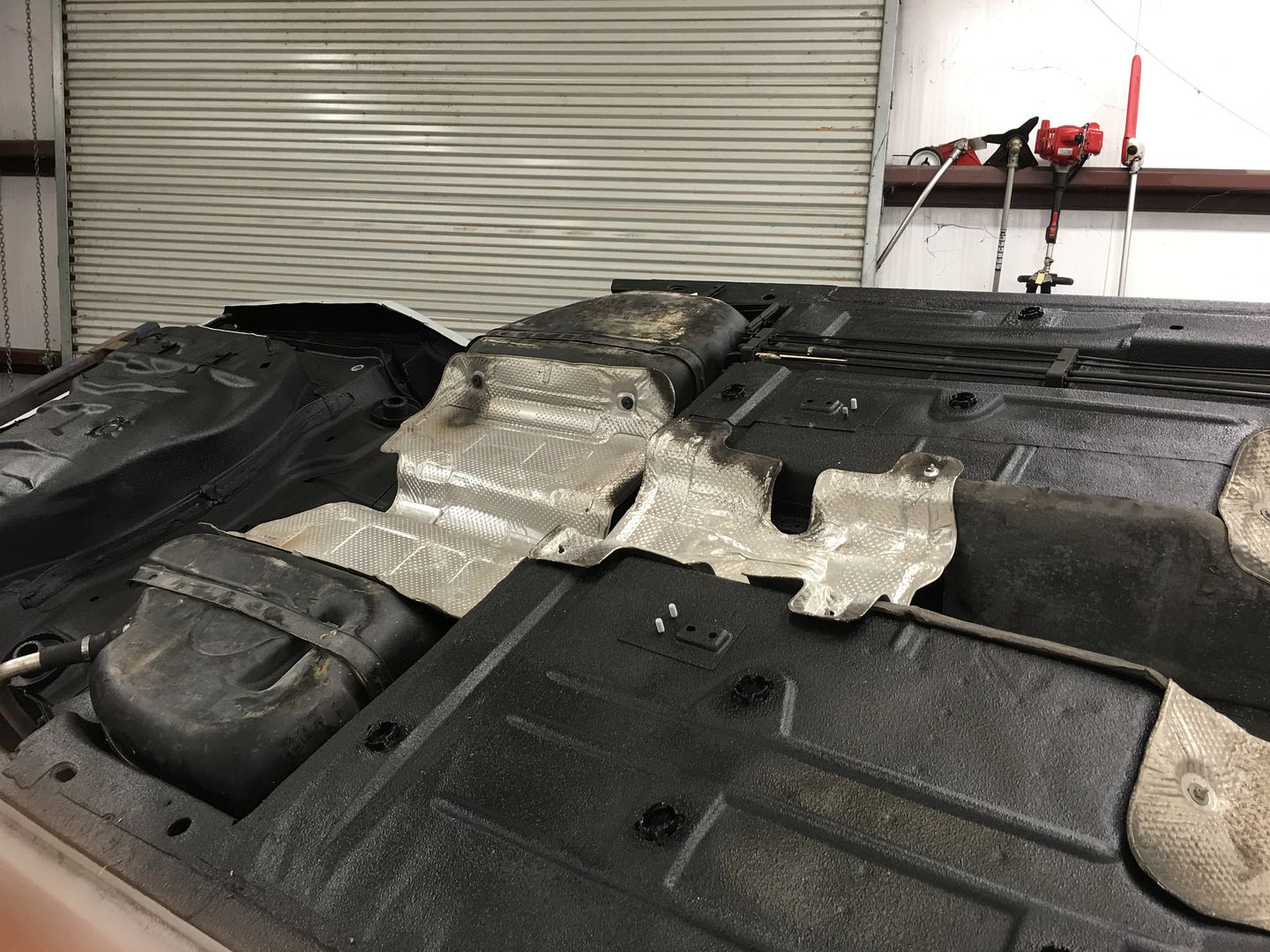

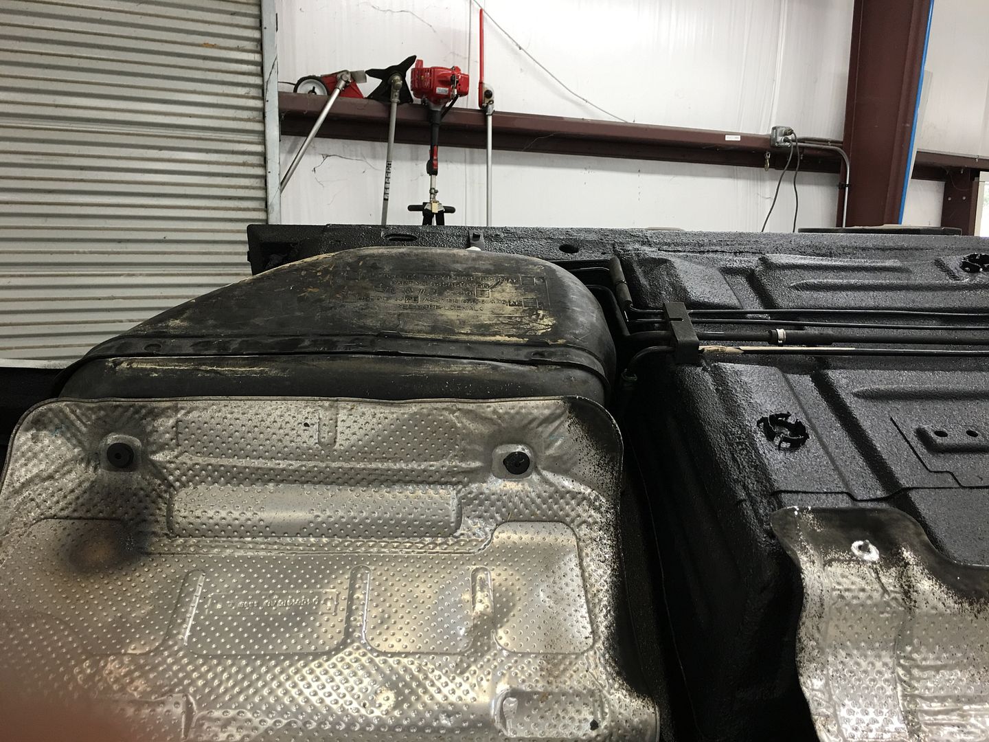

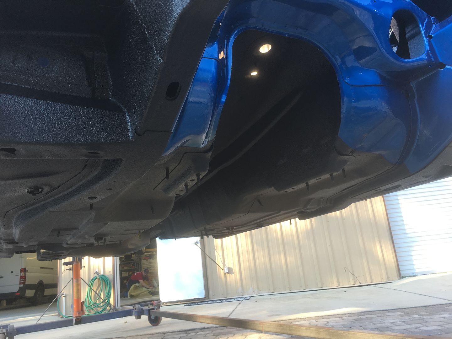

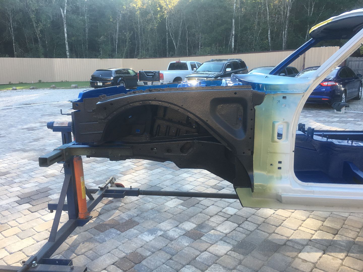

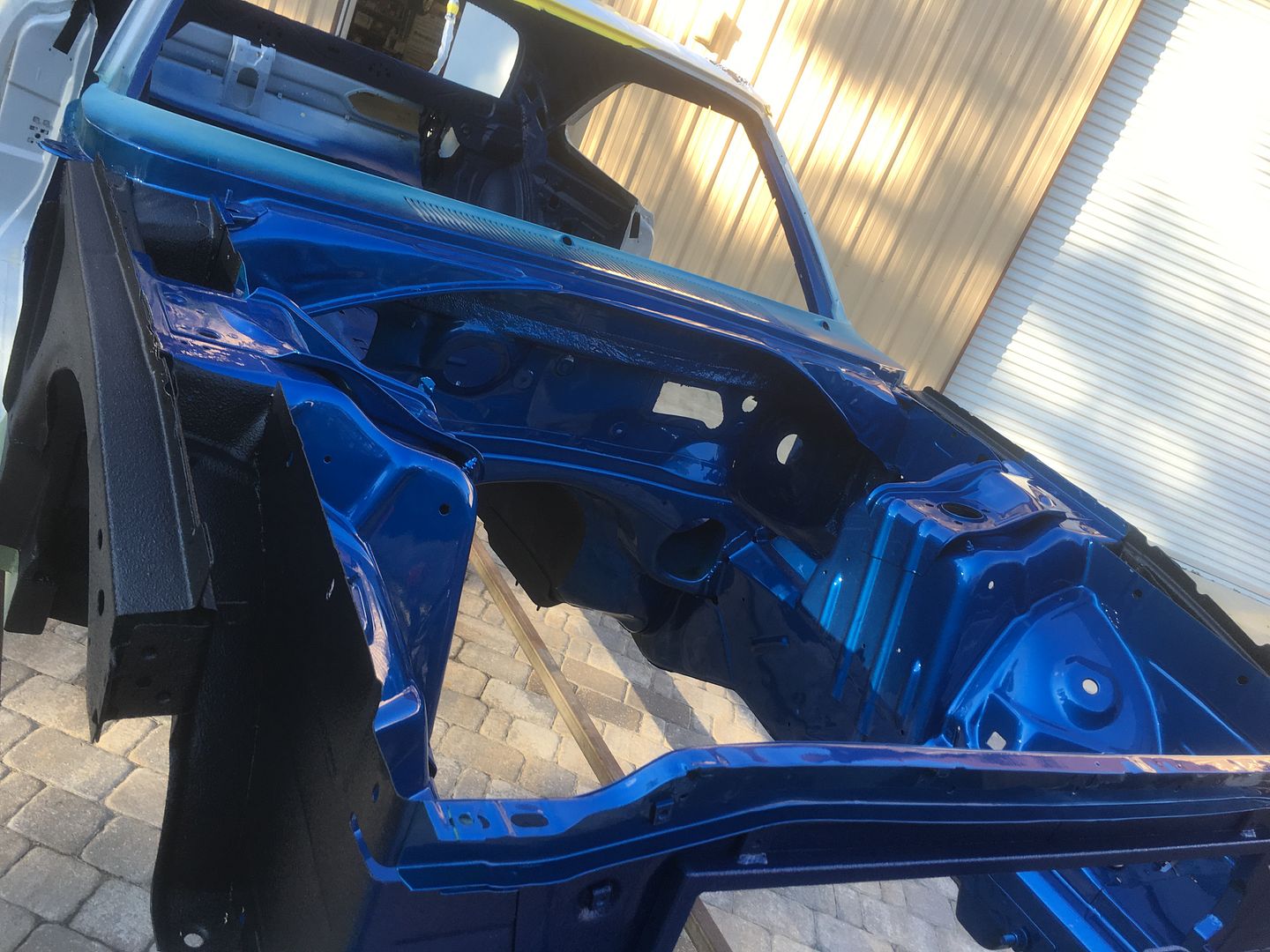

Okay guys, no pics, but an update FYI.
When I started this car, I had a plan to make all pieces be serviceable with OEM parts, so even the dealer could work on it. The RR is 116" wheelbase. The LX Charger is 120". I shortened the LX platform to 116", which is also what the new LC Challengers are. So the fuel and brake lines that run to the rear and driveshaft would come from a new Challenger. Lines, no problem. Driveshaft, problem. So, Chrysler switched rear diff suppliers in 2009 for all LC/LX platform cars to Getrag units. They are stronger, have LSD, etc., but they require a different driveshaft. If you own a 2005-2008 LX car, and need a driveshaft, it supersedes to a new differential and driveshaft. If you need a half shaft, you get the driveshaft and diff free, because your buying it all! The 2008 Challenger is a one year only car with an auto and the older LX platform. Finding a used driveshaft has been impossible. To make the car serviceable, I've had to get the updated diff, half shafts, and driveshaft for the 2009-2015 cars. I should have these next week and then I'll post up some pics.

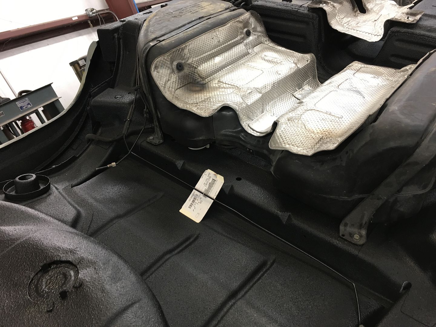

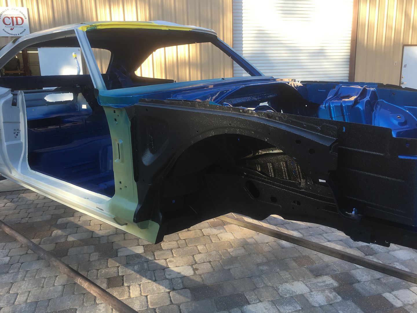

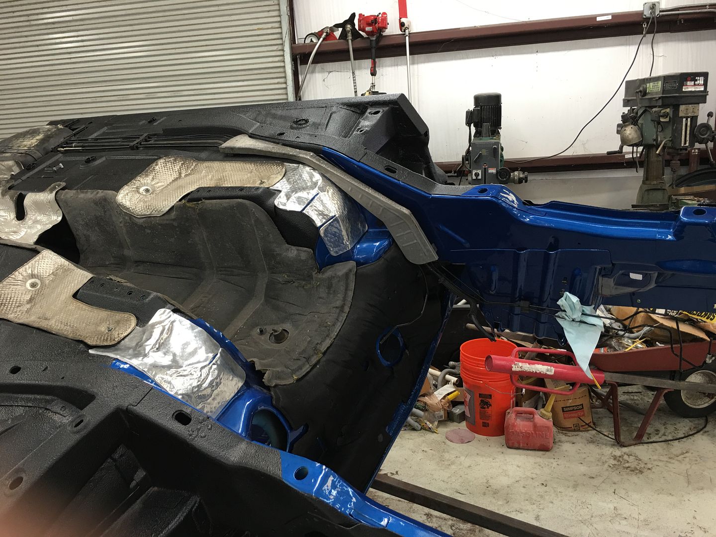

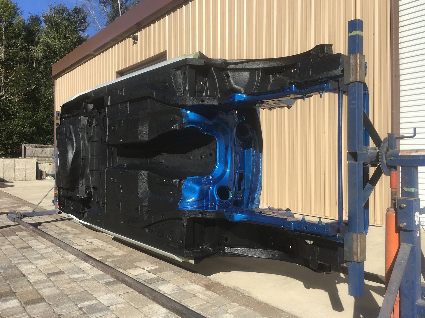

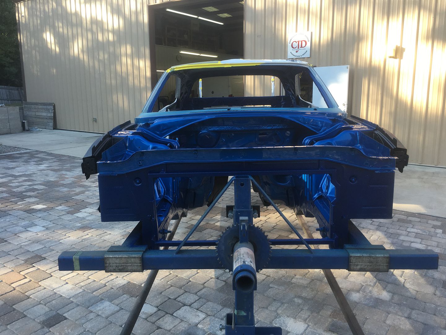

Okay, a few pics:

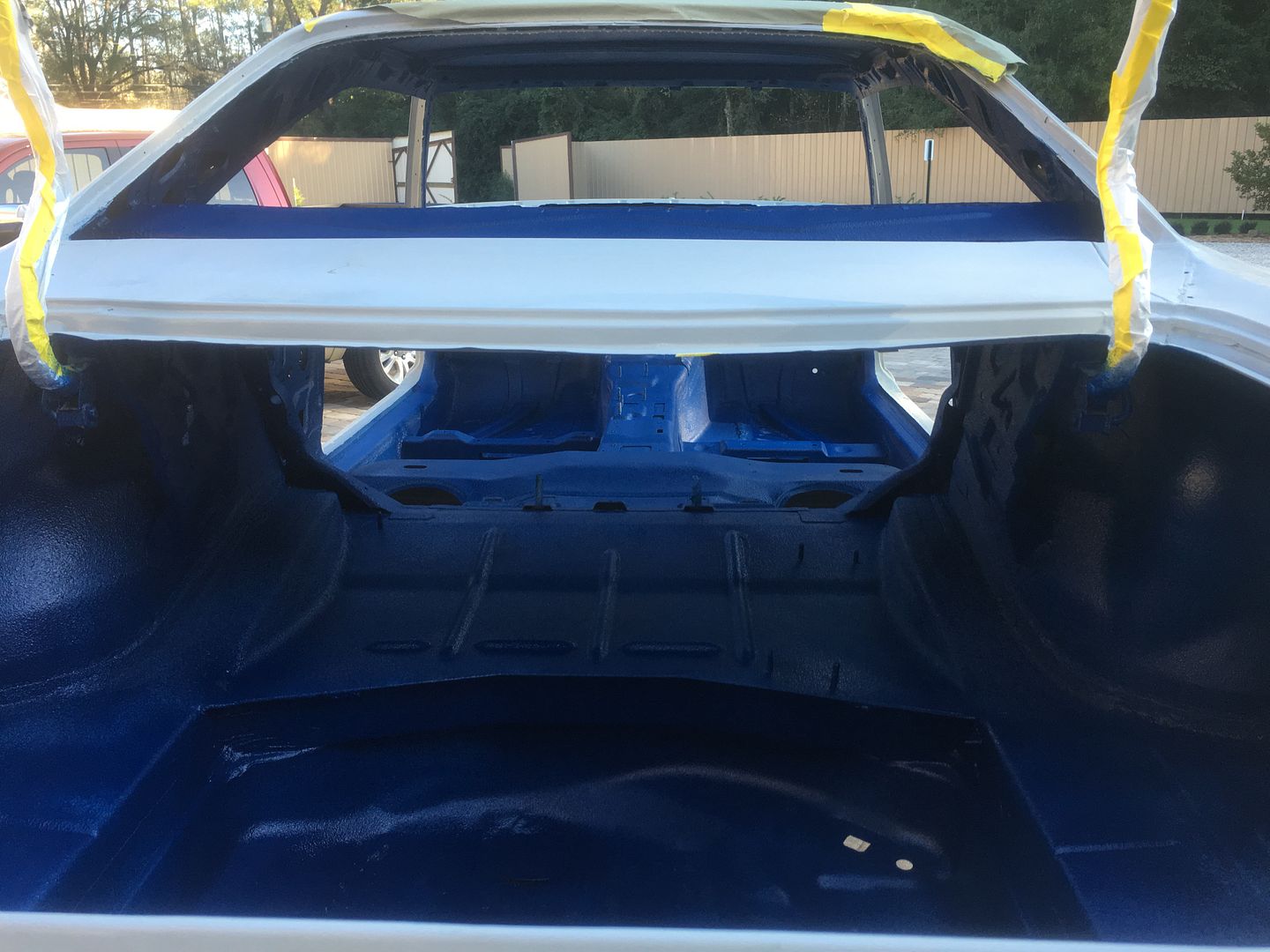

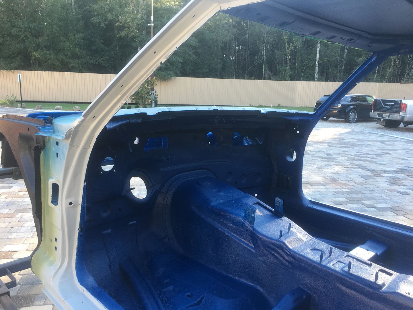

Hey Craig,
Are you actually able to mask off the underbody and engine bay well enough to not get any overspray at all during outer body topcoat? If so, I'd love to know how. I've always had crappy luck even with what I thought was a good mask job. The fine mist of either paint or clear seems to find any opening and leave a sugar coat just where I do not want it. I've taken to painting outer body first, then door jambs, trunk and engine bay. The outer body is masked off with plastic beforehand. Any mist or overspray gets taken off during color sanding.
I'm certainly open to other methods!
Thanks guys!
As far as masking, we usually "bag" the entire car and then cut open and mask the areas we want to paint. In this case, the outer shell. So you'll spend 3-4 hours taping and 20 minutes painting!! Wonderful world of paint and body!
