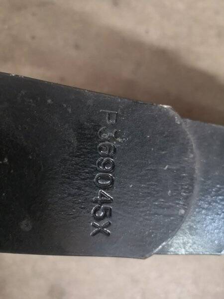

Mine have the chrysler "p" part #. It may be time to check other spring suppliers for a better quality equivalent .

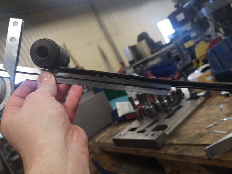

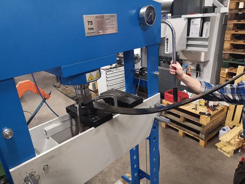

Well, I have a hydraulic press, so I will try re arc the main leaf before I spend my money on a new spring.
Sure worth a try. The main leaf and the next two leafs are most important for adding arch/ride height. I expect it may take more than one try to improve the arch to what you would like.

Will rearc the spring.

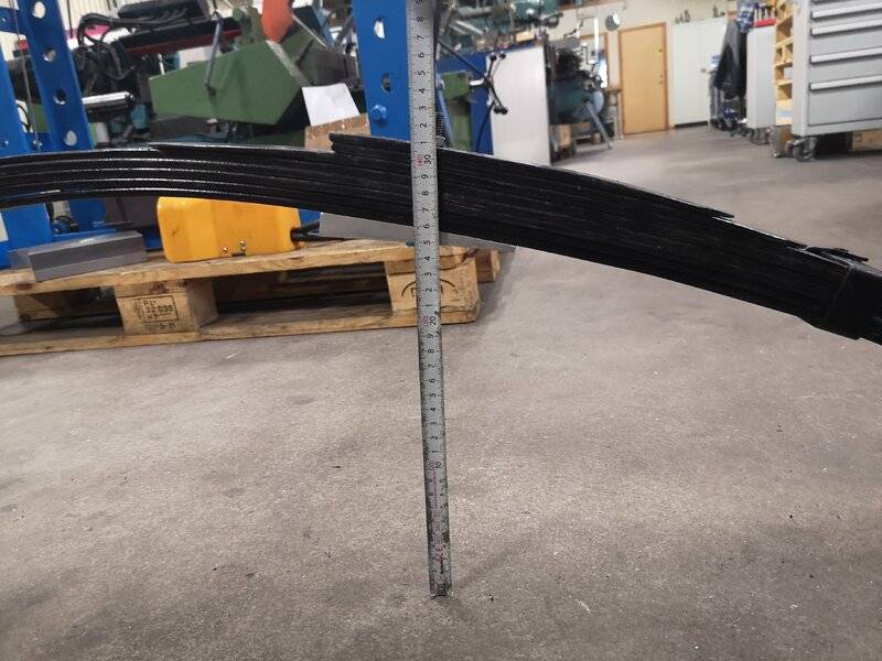

This is my bad 3400lbs ss spring.

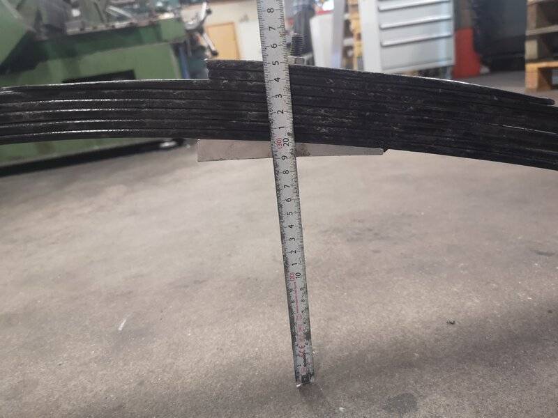

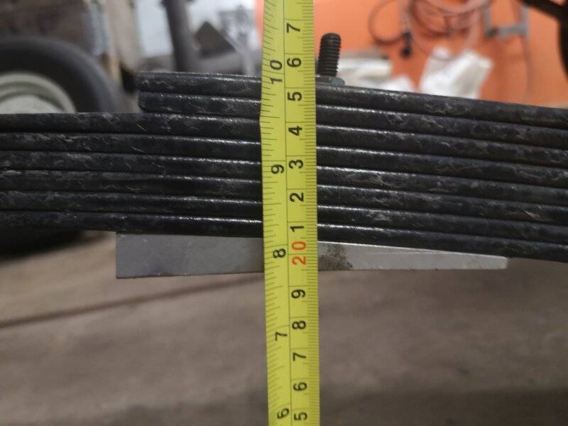

Does anyone have a spring they can measure for reference?
IMG_20201030_132024.jpg IMG_20201030_132039.jpg IMG_20201030_132039.jpg IMG_20201030_131859.jpg
I cant give you a measurement because i am away from my car, but i can tell you that my 3400 ss springs, 456/457 have five leaves plus two half leaves on the passenger side, and six full on the driver side. Made in mexico version, but they have been on the car for fifteen years. And i use the same wedge as
you, but maybe one degree more.
Six full plus two halves should have no problem holding your car up!
Edit: my passenger side is higher than the driver side by about an inch. I didnt know it till i measured, trying to prove that ss springs DON'T make it sit crooked. Oops!

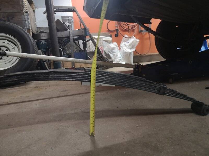

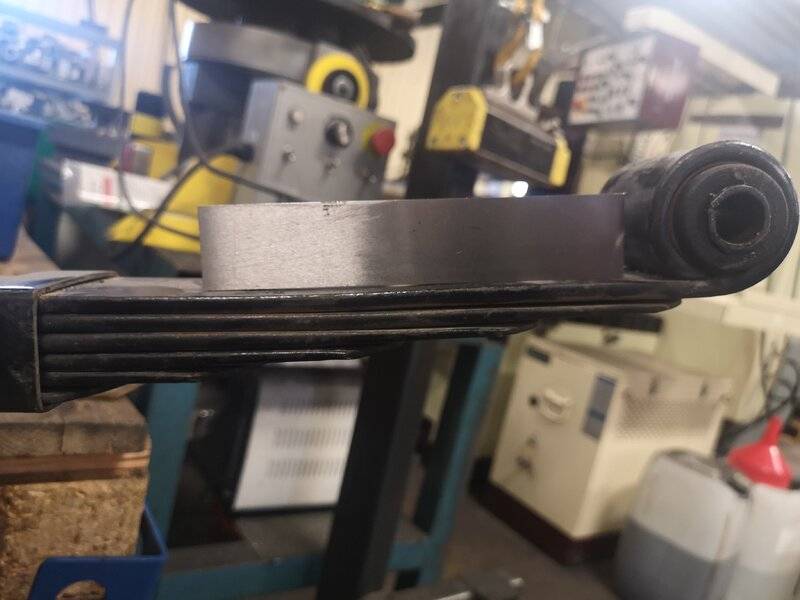

Before and after.
60mm more hight.
Was leaning 40mm with almost max preload on front right torsion bar.
Will keep you updated when I've got the spring installed.
That's much better than before, will lower the right torsion bar to level it out. Hopefully the leaf spring will hold its arc a couple of years.
