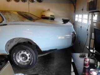

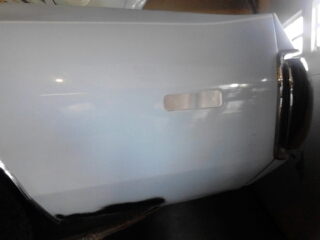

Maybe a cheap & reversible solution to those ugly school bus side marker lights. I used a stud gun to be able to bolt them in place of the marker light. They would blend in better if painted to match body color.

Why don't you grind the paint off and weld those plates in to make them permanent?
That Is the whole point of trying this. Its not much labor or skill and is reversible. The body panels have a curve to them and the plates are flat not to mention stainless steel which warps when welded even when care is taken. I think if painted same as the body they maybe near invisible Especially With a rallye stripe option.
Not everyone has welding and grinding skills, equipment, or money to have these tasks performed. I was just sharing with others this experiment and I am not sure I am in love with it myself But someone may like it and fit the needs for a project.
Was thinking of punching a hole in them and using amber and red dots as markers or using hidden lights in the area between the bumper and the body. Anyway the plug fits in the recessed area punched for the marker and is almost flush with the body. Less work than welding and is reversible. Just playing with ideas. Isn't that what this is about? I like to fabricate, Win or fail its still fun for me and an escape from life's problems you cant fix like relatives.
Yeah I see your point. I wasn't knocking it, just offering a suggestion.
