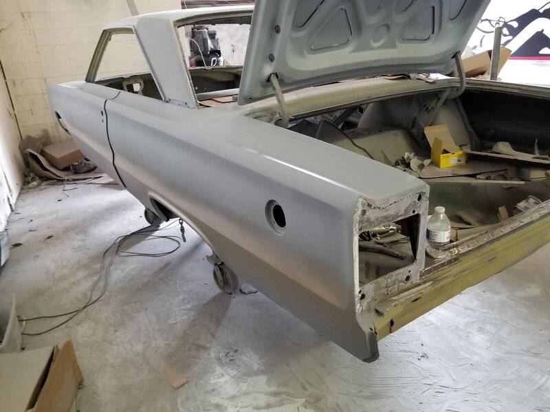

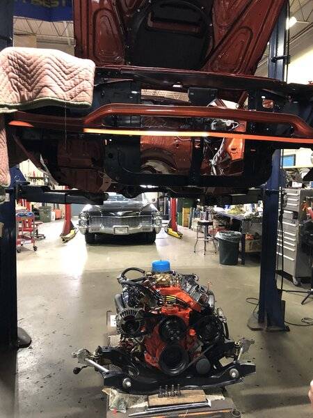

we've got a lot done in a week after getting the body back from paint.

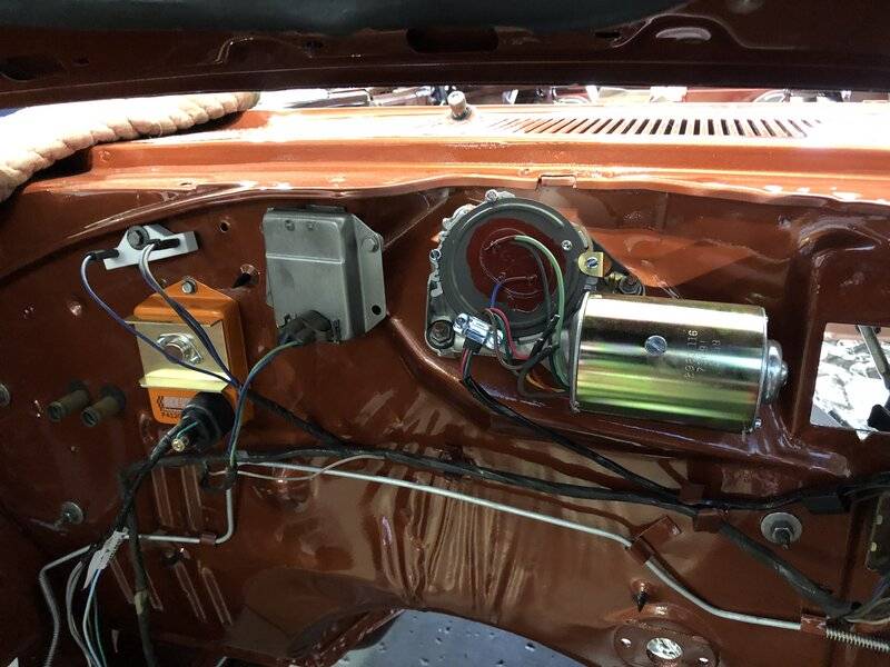

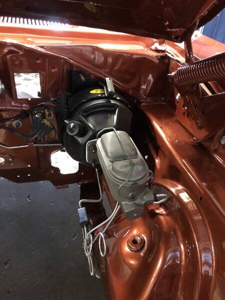

brake booster and master cylinder in with lines, windshield wiper motor mounted after being restored in quebec. Rear end in place and engine/tranny mounted on K member.

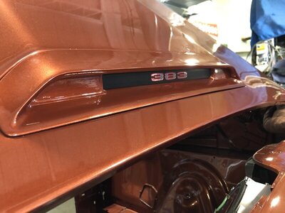

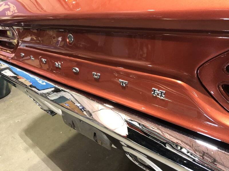

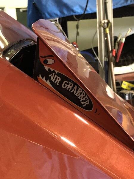

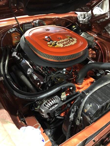

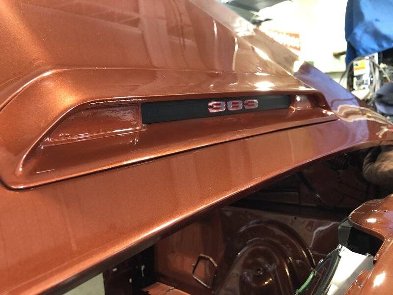

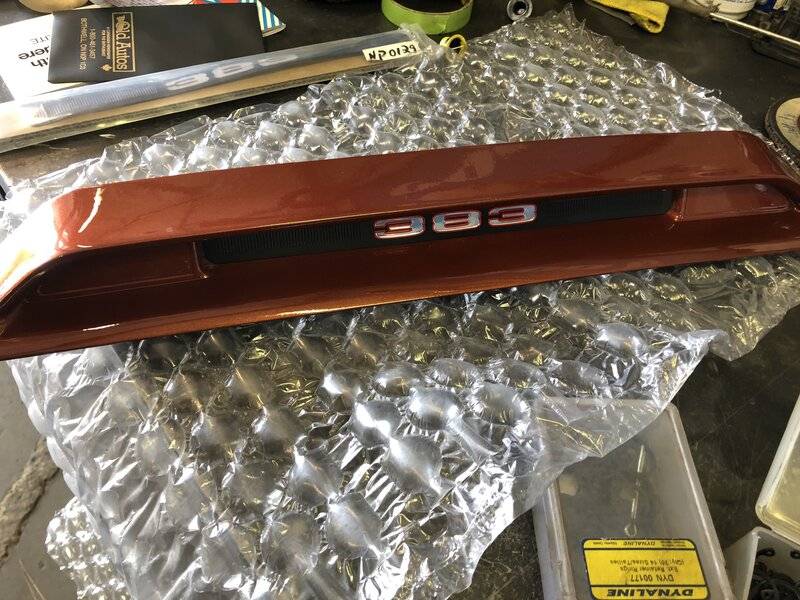

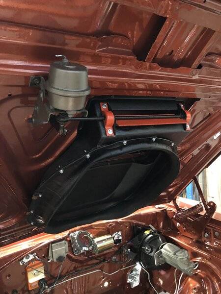

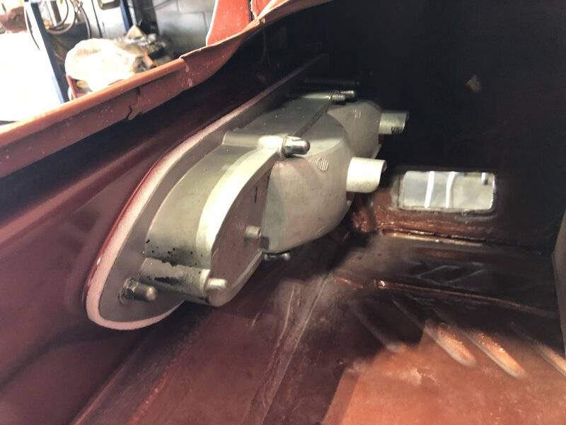

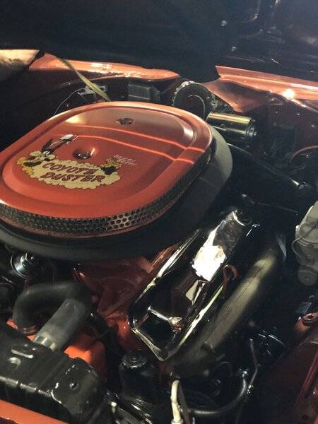

air grabber mounted after it was restored, tail lights in and 383 call out in hood assembled

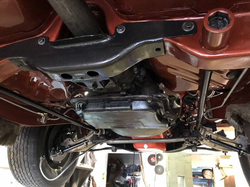

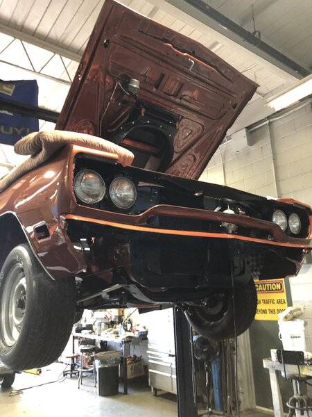

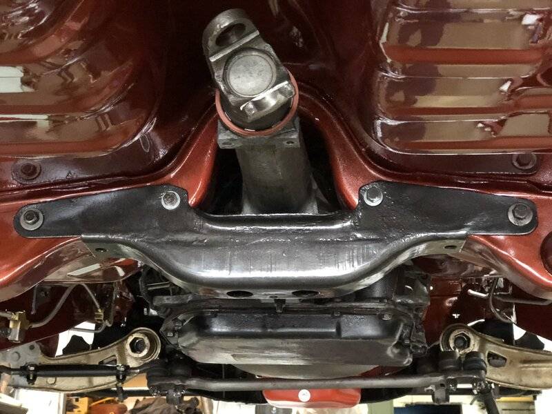

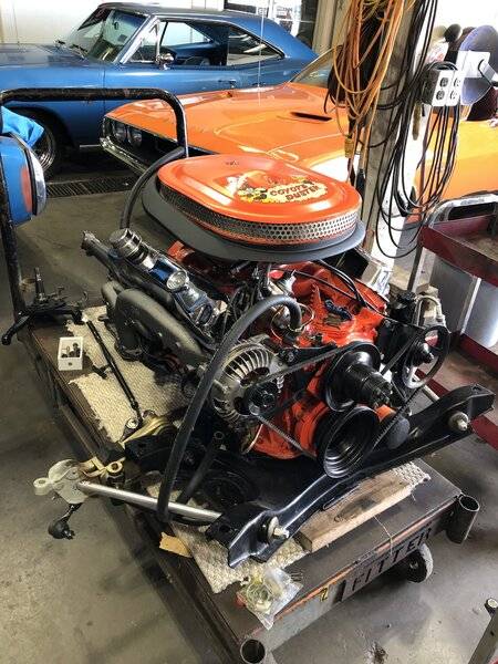

we put the engine,K member and transmission in today -rear end already in..
We're almost ready to start it up. -maybe this week,

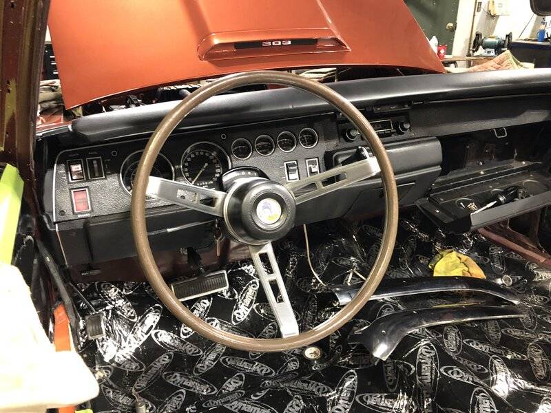

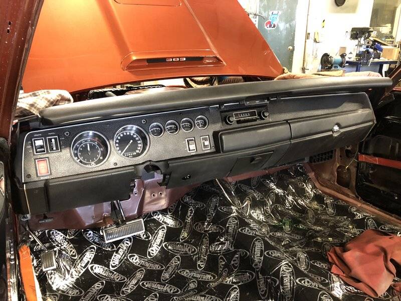

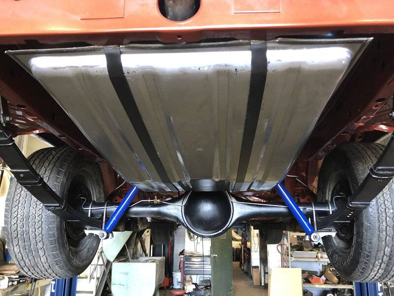

we just put the gas tank in, gas lines all in, brake lines done, torsion bars in, dash is in.

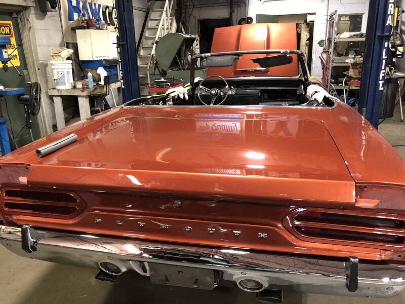

we've got the exhaust done--walker mufflers.
The chroming of the exhaust tips and bumpers and bumperettes all came out nice.
steering wheel is in.
battery and wiring done-hope to start it tomorrow if all goes well.

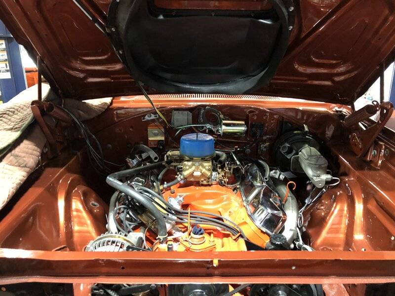

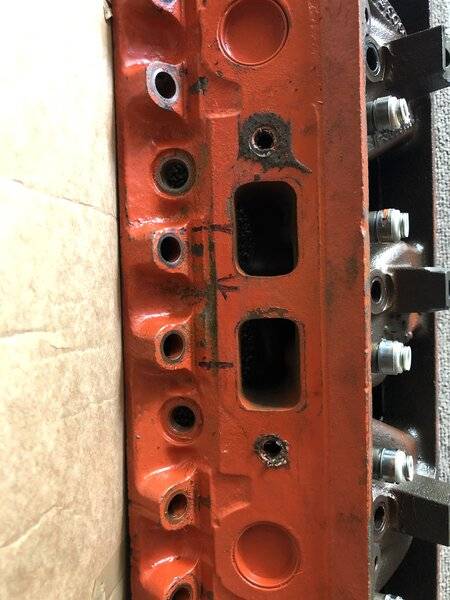

We were ready to start the engine after filling up the anti-freeze. It leaked out using a pressure tester. Cracked head. These 906's were beautful-new valves, guides, seals, etc etc and one was cracked. Don't know how it happened; see picture, I got them off a guy I sorta know. He was totally unaware and was going to use them himself at one time. They sat off an engine for 5 years before I got them. So we stripped the fresh rebuilt engine down and replaced the heads.
Then--I had a rebuilt holley 750 ready to go and was giving us lots of problems. We put on an edlebrock 750 w/electric choke and it worked well-the engine runs great. We broke in the comp cam no problem. Is edlebrock the way to go instead of holley? The model number I'm getting is 1411.
Then we couldn't bleed the front brakes, the rebuilt(for $335) original master cylinder wasn't working. Put on a $90 cardone and it's perfect. Then the original old air grabber red plastic switch broke while installing it. have you seen the price of those switches?

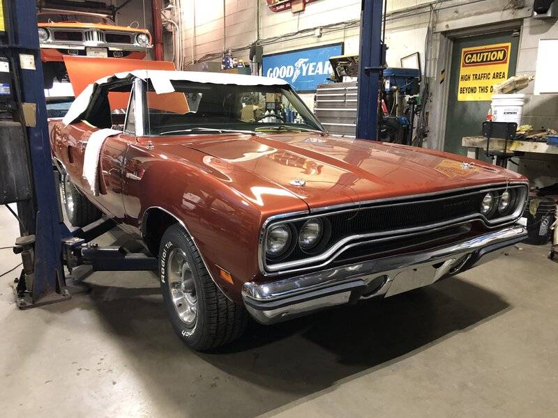

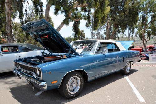

At least the car runs well, sounds great-roof is going on this week-end and maybe I'll be driving it next week. Started the restoration early this year so I should be pleased with how long it took I guess.

btw--I do have the proper 1970 centre caps to replace the darker 1971 caps that are on the wheels at the moment.
BF goodrich TA's are on back order most places-they were hard to get.

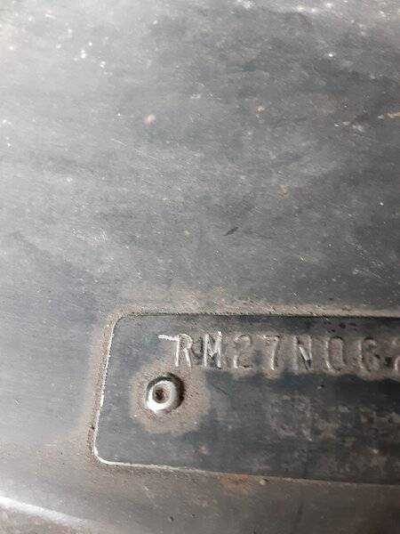

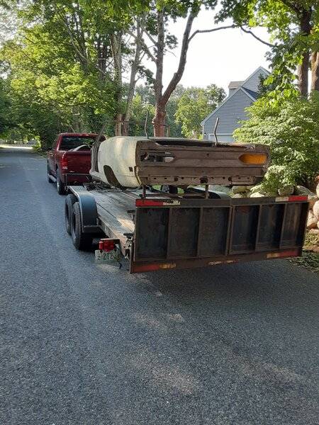

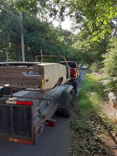

The car looks fantastic! I just bought a 70 Road Runner convertible project car,and I am just getting started on it. It's a major project, and everytime I look at it I find more issues that need to fixed. They are pretty rare birds,with only 824 of them built in 1970. I have a long way to go, but seeing this thread is great
inspiration for me! Great work.
keep at it--lots of work ahead but well worth it....I've had lots of issues with the restoration but as you know, you can overcome all of them. Whats the build date on your conv?
