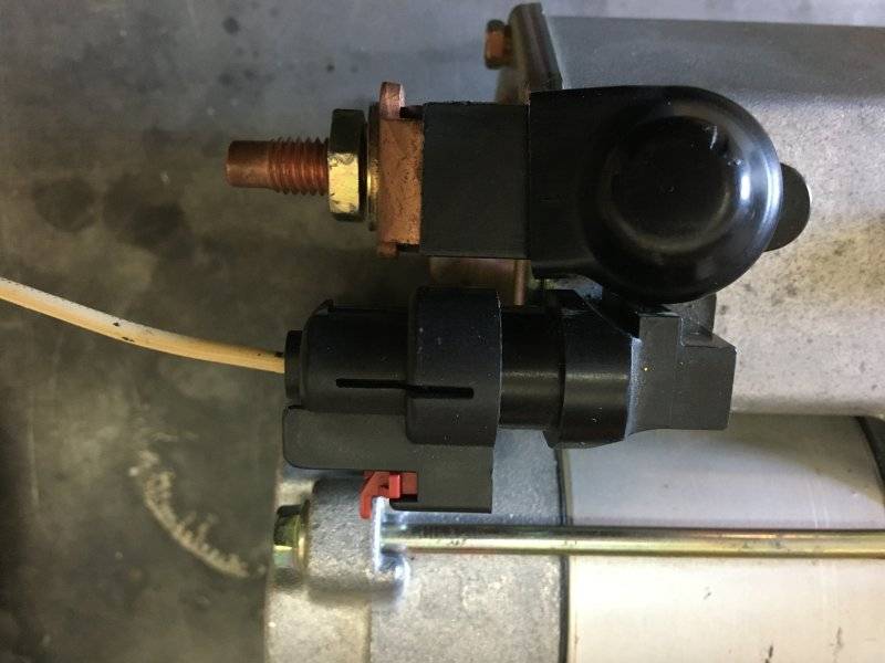

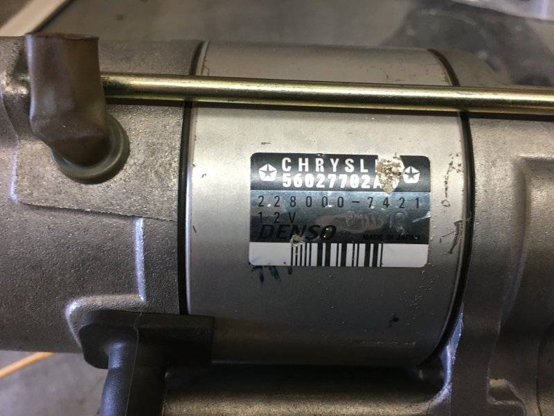

I bought a stock '90s Dakota starter. I cut about 3/16" off the terminal for better clearance from the block. I had removed the other terminal that comes on the starter.

About $20.00? My choice would be a Denso starter because they're very good quality.

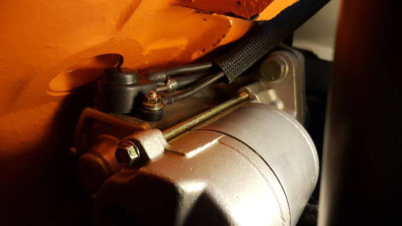

I've used them on everything.Trim the stud on a BB so its flush with the nut after attaching the cable. It'll clear fine. I just installed one with Dougs headers with no problem. Funny the only clearance issue other than the studs was on a 360 magnum. A little grinding on the block near the bell housing area fixed it. There's been a stock mini on my 580 15-1 motor for 12 years.

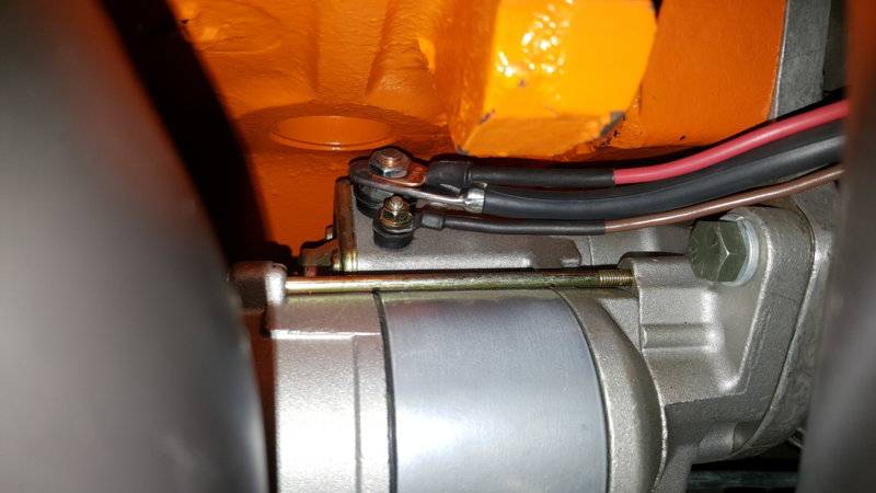

This one will fit with ZERO clearance problems. From a Dakota I believe.
Aslo - tough to see - but it clears Dougs headers with room to spare. I think you can even wiggle it in and out without loosening them !!
The main reason that the Denso starters work so well is that they have permanent magnets in them
and not field coils. No juice required to energize the field coils. They Kick ***!
