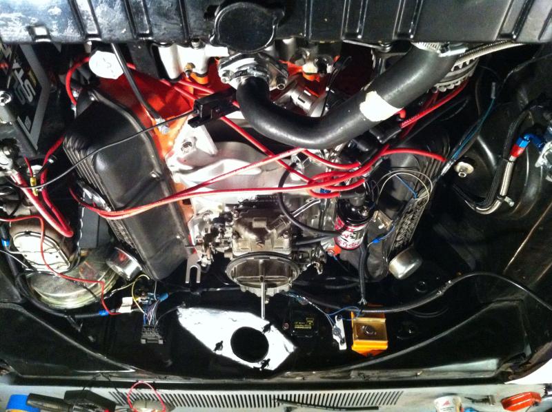

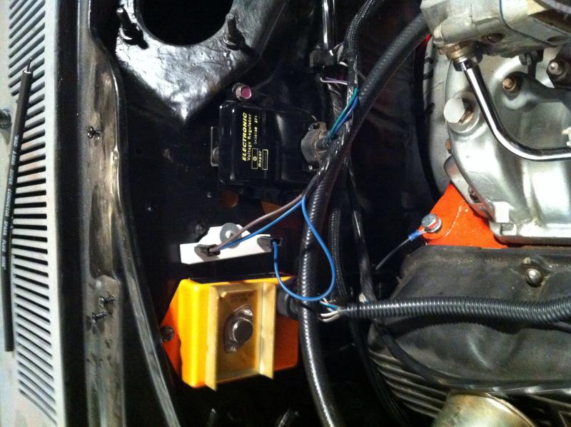

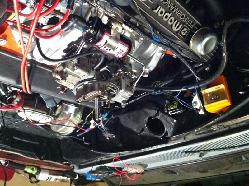

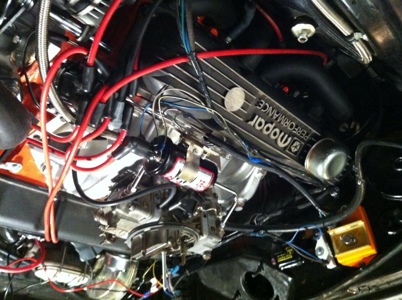

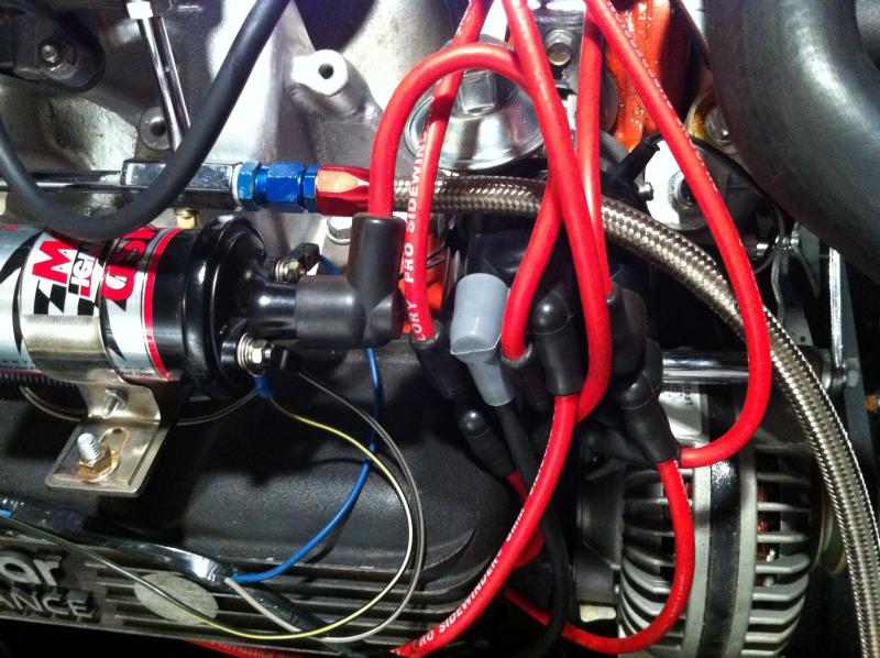

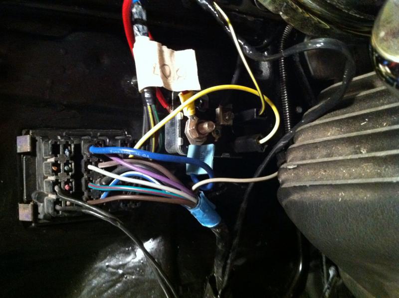

Just installed new neutral safety switch harness. Also installed new keyed starter switch and voltage regulator. Checked yellow wire coming from ignition switch and I am getting 12volts. Checked brown with yellow stripe, no voltage, that comes from the neutral safety switch and plugs into the bottom right side of the starter relay. Does the relay need to be grounded? Just to be sure we ran a grounding wire from the relay to the neg side of the battery. Still nothing. Looks like fuel pump relay died again when we were trying to start it. So we are done for the night. Just a general relay from the local auto part store, is there a fuel pump relay that you would would recommend? Here are some pics of the wiring, please let me know if you see anything I may need to fix. Appreciate the input. Sorry for the pics not sure why they came in upside down.

Just installed new neutral safety switch harness. Also installed new keyed starter switch and voltage regulator. Checked yellow wire coming from ignition switch and I am getting 12volts. Checked brown with yellow stripe, no voltage IT SHOULDN'T - THE NSS BASICALLY COMPLETES A GROUND OR NEG CIRCUIT TO THE STARTER RELAY IF THE TRANS IS IN GEAR THEN THE NSS IS DEPLOYED AND CUTS THE GROUND TO THE STARTER RELAY SO IT WONT START. WHEN IN NEUTRAL OR PARK THE NSS IS IN ITS NORMAL STATE AND THE GROUND CONNECTION AT THE NSS IS COMPLETE AND LETS THE STARTER RELAY ENGAGE., that comes from the neutral safety switch and plugs into the bottom right side of the starter relay. Does the relay need to be grounded? YES TO THE BODY OF THE CAR, THE SAME GROUND THAT THE TRANS AND ALL OTHER WIRING IS CONNECTED TO Just to be sure we ran a grounding wire from the relay to the neg side of the battery. Still nothing. Looks like fuel pump relay died again when we were trying to start it. So we are done for the night. Just a general relay from the local auto part store, is there a fuel pump relay that you would would recommend? Here are some pics of the wiring, please let me know if you see anything I may need to fix. Appreciate the input. Sorry for the pics not sure why they came in upside down.
ON 69'S THE NSS IS A 3 WIRE, 2 OF THE WIRES ARE FOR THE REVERSE LIGHT CIRCUIT AND THE 3RD IS TO THE STARTER RELAY
Hopefully this diagram helps you? OOPS THE NOTE IN THE PIC IS WRONG SORRY IT SHOULD READ IF IN PARK THE NSS COMPLETES THE NEG TO THE RELAY SORRY!
