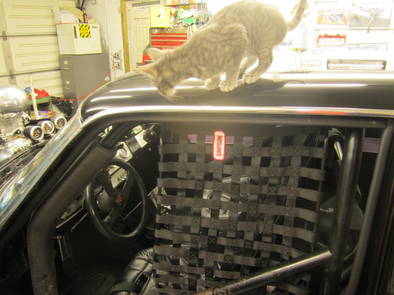

Depending how fast your street/strip car will determine what bar is needed.You can get creative and keep the rear seat.
