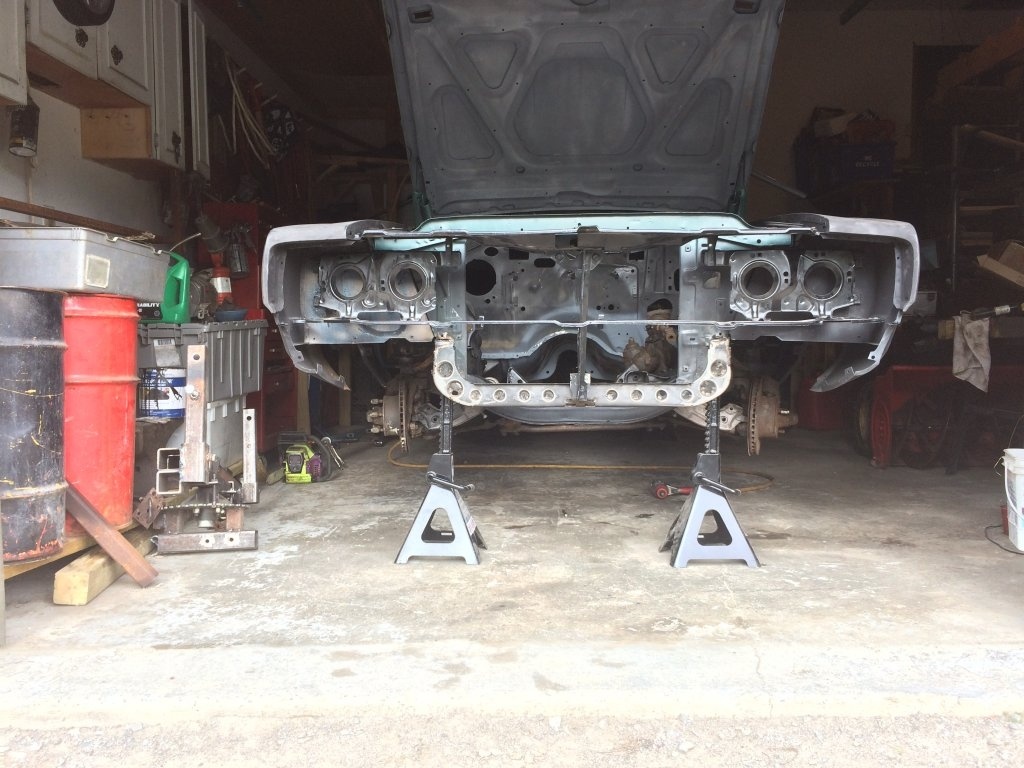

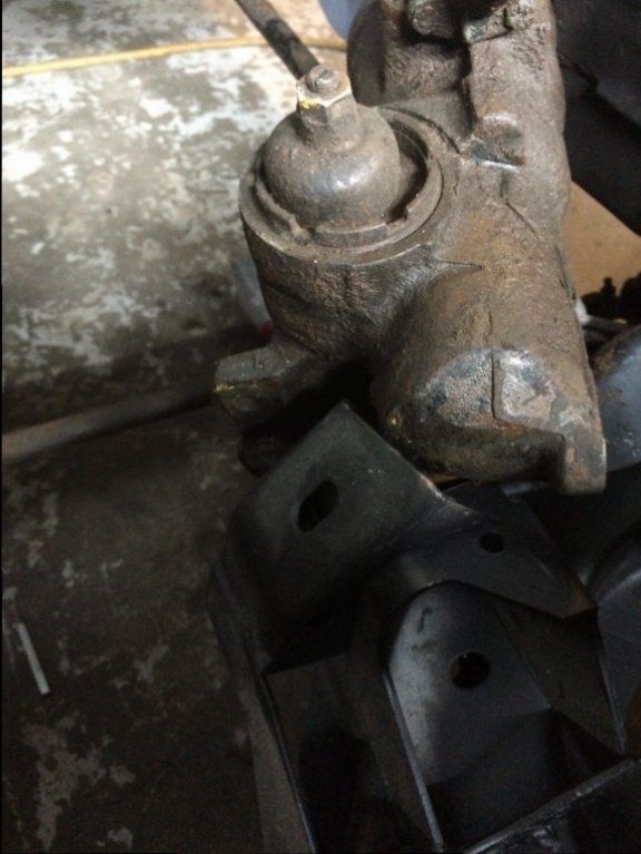

I am in the process of putting the suspension back together n went to bolt the steering housing on n have misplaced the 3 bolts to attach the unit to the k member,any picks or specs of proper bolts would be appreciated.
It's for the 69 charger,n its for the power steering type gear box, if there is a difference

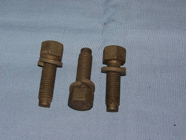

I can pull one tomorrow if needed. Easy to do at this stage.
If memory serves me correctly, i think they were 1/2-13 × 1.5". Try a tap to find the correct thread and bolt size perhaps.
