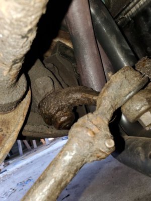

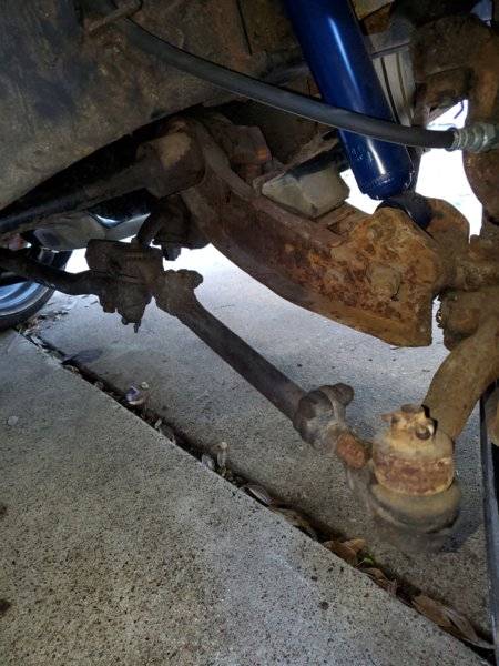

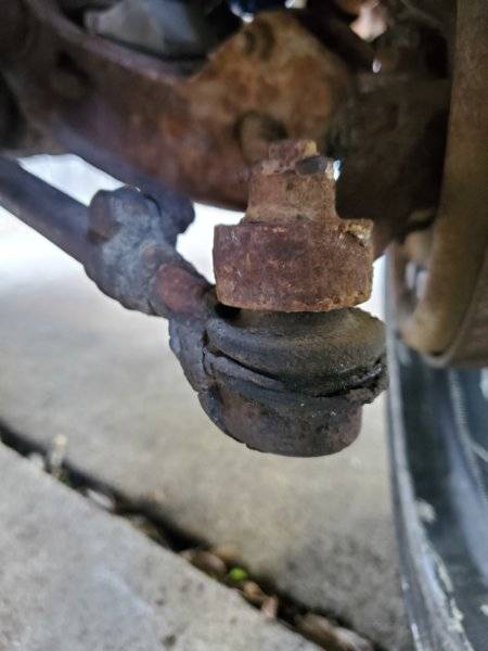

Maybe these photos will go to show the situation I'm working with, pretty ratty
20191230_152937.jpg 20191230_152802.jpg 20191230_152915.jpg 20191230_152746.jpg
I need to grab some PB blaster and scrap off some of this gunk, I got some big chunks off to show what I'm working with
