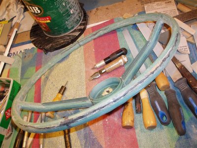

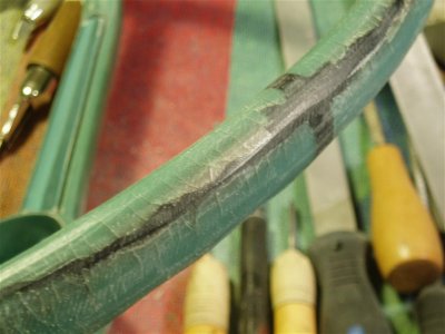

Thinking out loud - I wonder if fiberglass resin will work to repair the cracks? You'd want to open each one up a bit with a file to make a shallow groove to get it to stick. Then sand and finish.

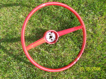

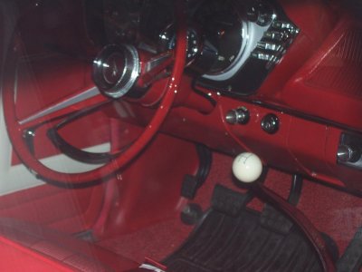

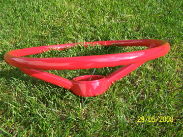

Here are a few pictures of an early 60's B-body wheel I did and a couple of links to a thread (on DodgeCharger.com) with lots of pictures showing my process and also my "The Steering Wheel Guy" Facebook page ... and of course my web site at: www.stwheelz.com

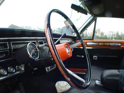

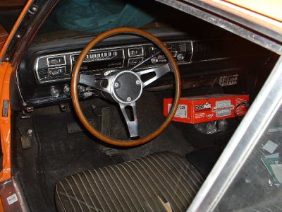

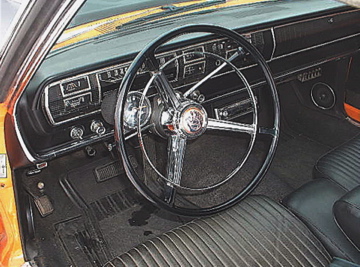

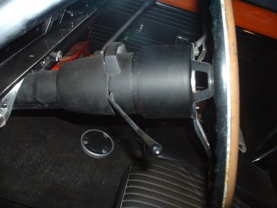

Here is a 70/71 rim blow wheel I mounted up in my 67 Coronet. After slightly modifying the A-body crush-can/adapter, it fit perfectly on the 67 steering column and located the wheel in exactly the same driving position as the original rim would have been.
I also mounted a Silver modified rim blow wheel for a while (the groove for the horn switch was filled in and the horn mechanism was mounted under the center cap)
The wheel that's in the car now is a 66/67 wood grain wheel that was finished in Black with an Orange stripe and a couple of Chrome stripes around the outer circumference.

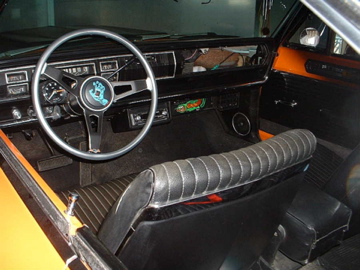

The last shot shows the original 67 Black wheel with a bit of airbrushing on the horn cap (my boys are skateboarders so I painted the "Screaming Hand" on the horn cap)
