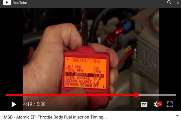

I installed an MSD Atomic EFI a few years back and set it up to control the engine timing. I used some baseline ignition numbers from an MSD Atomic install video which they set up on a Pontiac engine just to get the system running. I never went back in and adjusted settings for a 440cu.

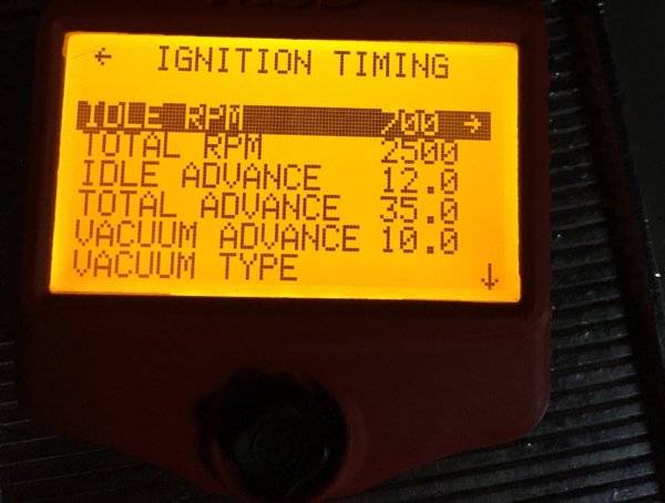

My settings:
Idle RPM 700
Total RPM 2500
Idle Advance 12.0
Total Advance 35.0
Vacuum Advance 10.0
I can change settings on MSD computer. Also, I can set Vacuum Advance to zero if it is not needed.
I’ll attach a pic of my settings and a pic off the MSD youtube vid.
Any help is appreciated.

I have a 440 in my 69 r/t that always runs on the "warm" side. engine is stock and my advance curve is very similar to yours. I've played with advance curves in every direction possible and never found any cure for engine heat playing with the timing. my problem is a 22" radiator and all cast iron. the exhaust manifolds will run 700+f. i'd look for the cooling issue some place besides timing.
A couple questions and suggestions:
1. Were you seeing 207 just driving around? Or stopped after driving at highway speeds?
- You really don't need a fan driving at 50 or 60 mph, I have an electric fan using Atomic and it stays off
2. Have the heads ever been off the motor? When I took my 383 apart years back the cooling passages through the head
had a layer of scale covering the holes.
3. Are you sure you set the initial distributor advance according to the MSD recommendations fixed at -20 degrees?
I would suggest a couple things:
1. Check that the fan blades are centered in the inward edge of the shroud. Too far in negates the fan functionality
by short circuiting the air in the shroud.
2. I've heard that high flow water pumps can possibly be worse since there is less residence time in the radiator.
Lastly a couple suggestions on the timing but these would be for starting, performance and economy:
1. Try initial timing at 20 degrees or so, it should start better. If the starter labors when warm and nearly stalls go back a few degrees.
2. Jack up the vacuum advance as far as you can and listen for predetonation. This will make it snappy.
3. I run total at 39 degrees, you might go up a couple here 906 heads with a big bore take a while to propagate the explosion.
To try something simple,
If you're using antifreeze, try diluting it to around 0 degrees, the more water that you can get by with really helps with the cooling. (I'm not sure where you're from for your climate)
The Water Wetter product really helps. Even Kool-It will help.
So "hot dogging" it got up to 207....So I assume it came down appropriately? I take it your running pump gas with ethanol?
Your numbers seem fine if those are the actual numbers for timing.....If the temp goes up while sitting at a light or dogging it but quickly comes down when driving....Then Welcome to a BB....
As KK said improve on the cooling side of things.....
Also, is your gauge accurate? Use a temp gun at the water neck...
The Atomic measures inlet air and cooling jacket temperature, if they are the same at ambient then it's working correctly.
I was surprised at how accurate my old gauge in the 66 was compared with the Atomic.

207 is not a problem. New cars with aluminum heads run over 220. Keep in mind that the number could be artificially high. Stock gauges were merely "guidelines", not exactly precision instruments! Even some aftermarket gauges are not 100% accurate. A mix of water and anti=freeze raises the boiling point of the coolant. Once you go beyond 50% anti-freeze, the boiling point actually gets lower.
The higher the pressure in the system, the higher the boiling point too.
Given your electric fan setup what you are seeing is exactly correct.
When you are driving the air from moving cools the radiator.
When you stop the built up heat in the system is still there, but no fans when you initially come to a stop.
The temperature rises and the fans kick in, but you have not been removing the heat for some period of time until the temperature rises above the setpoint. So even with the fans on the temperature will rise above the setpoint.
It's not a big deal as long as it comes back down in a couple minutes.
You can scroll and see if the fans are activated on the handheld.
As far as the timing:
1. Yes try initial at 20 degrees.
2. Try raising total advance 1 degree at a time.
3. The vacuum advance is controlled by the MSD it's electronic since it knows manifold pressure.
This is why they have you set the distributor up with 20 degrees advance. I think the Maximum is 42 degrees
which is unfortunate, because a big block can take up to 55 degrees depending on the engine configuration.
Try 15 or even 20 degrees of vacuum advance.
Again the timing recommendations are just for starting, performance and fuel economy.
Have fun.
Sorry correction, you set the distributor timing to 15 degrees BTDC after you lock it out, not 20.
But you can actually cheat here and get more advance out the system.
You just have to keep track of how far you advance beyond 15 degrees and adjust your settings accordingly.
