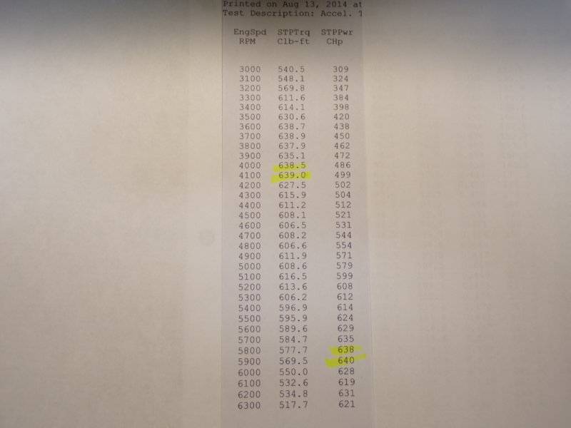

600+ lb-ft? Hmm, maybe....................okay yes.......
.040" overbore 440 block
ProGram 4-bolt mains
4.15 Eagle Crank
6.76 Eagle H-beam rods
Diamond dished pistons 10.3:1
Lunati 60333 solid roller 249/255 @ .050" .585/.600 lift with 1.5:1 rockers
Edelbrock Performer RPM heads ported to 309 cfm @ .600"
Ported Edelbrock Performer RPM Dual Plane Intake
950 cfm Quick Fuel
As it was a street engine I was mostly impressed by the ported RPM dual plane. However we did other intake tests on the same engine.
Ported Torker II and a @ 2" HVH 4-to-1 spacer.................634 lb-ft @ 4,900 rpm, 650 HP @ 5,800 rpm & 643 HP @ 6,000 rpm. For some reason we never tested this combination beyond 6,000 rpm.
Plenum blended and gasket matched Victor w/ 2" HVH 4-to-1 spacer................629 lb-ft @ 5,000 rpm, 656 HP @ 5,900 rpm & 650 Hp @ 6,200 rpm.

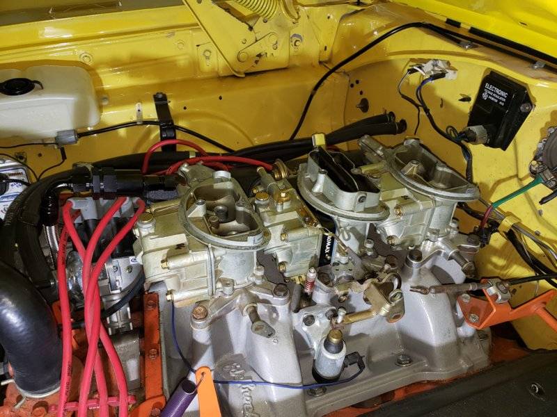

I have been planning some modifications for my 6 Pack engine and ran into these 240 Trickflow heads viewing a 440 stroker build on Youtube. Since you mentioned the 6 pack, maybe you can provide some real insight for me. I do have the original stock 10:1 pistons and heavier duty rods. I was thinking about the Trickflow heads to reduce detonation and add horsepower. I tend to hesitate using the hydraulic roller setup on the street. Seems like more that can go wrong. I am not sure about the longevity of roller rockers for cruising and/or traffic. People have also mentioned extended idle problems with the hydraulic roller setup.The cam I use now is a Purple Shaft 284-484 cam that produces 11 vacuum and I was wondering if you consider your build just for the track or can be driven on the street. I like the numbers you have but wonder if the motor will last if HP increased at such a rate without changing my connecting rods or crank will handle the stress? Trickflow said they bolt their top end kit onto a stock engine. I am still getting advice on a cam for the engine given I want to get the most out of the extra flow but keep power brakes. I need at least 11 vacuum. Anything you can provide is much appreciated.
Since you didn't mention it, I'll assume you have the 6 pak steel crank as well?
ARP rod bolts are what I've seen suggested numerous times, and if your budget dictates keeping the cost down, then just change those out to the ARPs, cheap insurance and peace of mind. That will take the weakest link out of the reciprocating assembly.
TrickFlow 240s on that engine are going to make a world of difference, and yes, they should be an improvement over iron heads regarding detonation.
I defer to those with more experience and knowledge as to how the combustion chambers of the TF 240s are going to affect your compression ratio, but if they raise it to 11:1 you should still be fine on premium pump gas.
