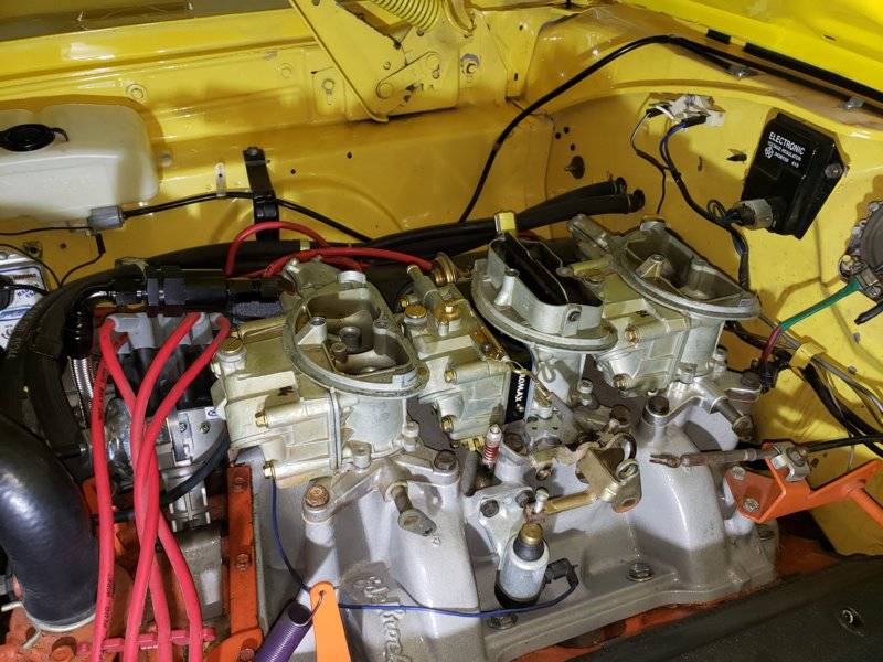

From the members in this forum as well as some research I decided to go with the TF240s. Considered the 270s but I think for my lower levels it’d be more than enough. Just like any heads that claim they can be run “out the box” there was a little shavings and some areas that need to be hand ported when we recurved them but otherwise they are pretty impressive.
After cracking open my block some of my rods were shot. I’m surprised there wasn’t a hole in the side of the the block. Goes to show you can’t trust an engine from someone else you’ve never been inside of... so i went with a 512” Stroker kit from 440Source. (block was already bored .30 over).
It’s crazy - I came to ask advice about making power out of a standard stroke and ended up going for a full rebuild!
The TF 240s will work fine, even with the 512 stroker. My plans, if I live to see them come to pass, are to use a BME aluminum block, so I also want to go to 540 cu in.
If that all gets shot to hell, I'll drop a pair of TF 240s on my 440 6bbl and go from there.

Going with dished pistons. We are decking the block this week but compression we are going for is 10.7:1
Cam is a Lunati 263/271. Solid flat tappet 3-Bolt. I think it’ll be good for the street. In about a year I’m getting stationed overseas for 3 years so for now I’m just gonna have a blast with the car and when I get back it’ll probably come off the street and go into full race trim.
Howard’s .904 lifters, Melling high volume oil pump, Pro-form 950 Carb w/ vacuum secondaries. Staying with the M1 performance intake with a 1 inch spacer. Rockers are the 1.5 Harland Sharpe’s that TrickFlow recommends. Ordered a conveyer from Frank Lupo @ Dynamic’s. 9.5 converter w/ a 4K flash stall. Last night put on some M&H 275/60/15s and gonna keep my 4.10 gears.
Finally have everything ordered for the block, just waiting on my Kilduff shifter and we’ll put it all together. Wish I had enough money left for a Dana. I suppose that stimulus check is coming in :rolleyes:
Like you said any build tips would be appreciated!

I have what I and others believe is the 292°/.509 cam, it's definitely a purple stripe Mopar cam, and some have said the sound gives it away, but I stand on the performance as to why I'm as sure as I can be without actually knowing the specs of the cam. My 440 6bbl demands that I let it spin up to 6,200 max, and my shift light is set at 5,800, limiter set to 6,200. That all came into play when I replaced worn valve springs and iffy hydraulic FT lifters. I put in new stock pushrods, and Comp Cams hydraulic lifters, springs, locks, and retainers and where the engine used to feel like it was coming on to the first 1/3rd of some serious power, around 5,200 RPMs and then fell on its face because of valve float, well now it's a BEAST all the way to "redline" and I have to attribute that to the cam.
I can only imagine the improvement of the TF 240s, and those were going to be THE choice for me, no question about it, but I hope to build a stroker motor, and that has me looking at the 270s.
Thank you for the post. I do have the original crank for a 6 pack engine and the heavier duty rods. I would like to get the most out of the heads and keep the power brakes working properly. When Trickflow sells a top end kit that they say you can bolt right onto a stock 440 and make ridiculous 550 to 620 HP that just sounds a little crazy and everyone knows when you change one thing it drastically effects another. I want HP but don't want to here that horrible sound of an engine blowing up. The 284/484 purple shaft cam I have now produces 11 vacuum. I am not familiar enough with roller hydraulic cams and how an engine reacts with different grinds for them. Cam manufacturers don't provide vacuum specs with dyno tests but it is a good indicator for how an engine will idle and react in traffic. Years ago I could look into my Direct Connection book and follow a performance list of components to produce a results using recommended parts. I don't have that source anymore using the newer stuff but I would like to take advantage of whats out there today.
