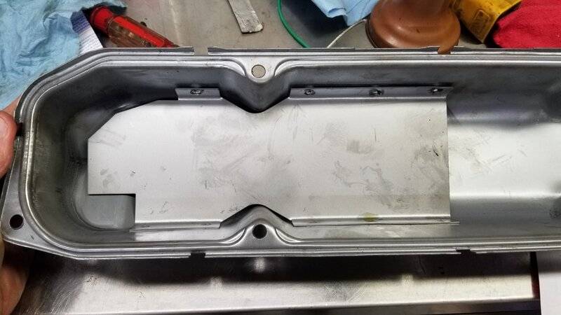

I wanted stock looking valve covers too for my 500 inch B based stroker (to look like a stock 383).
Anyway, I bought a set of reproduction valve covers. The baffle looks like this when stock:
I drilled out the spot welds and then put a light bend in the baffle right where the rockers hit.
Here is the baffle back in the valve cover (but before welding)
At the moment, my stroker engine project is on hold while I work on my 73 Road Runner, but when the engine is done I will use these valve covers for a stock appearance with clearance.
