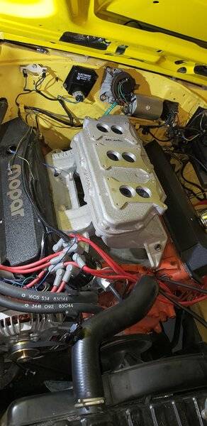

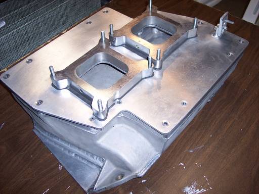

about the Edelbrock Cross ram STR style intakes
this one is an example with a modified top & spaces
2 4bbls inline & with a valley cover welded in too

there's a lot of them out there that have been modified
some are better than others
there's a couple mods that should be done so you don't get
dead spots & fuel puddlings & foul #7 plugs IIRC
I had one for a while on a hot street car back in the early 80's
with a 950cfm 3bbl, mid 11 second car
it'd pull hard to 7000rpm + (engine wasn't really built to spin that high)
I didn't feel any flat spots or bogging at all or ever
I think the RPM limits are more valve-springs & camshaft selection
or how the carbs are tuned
than it is the intake capabilities
I think it does better than a tunnel-ram for street driving

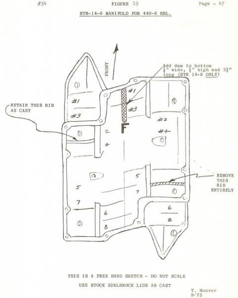

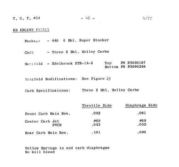

I had a STR-14-6 too, also street driven on my daily driver, 4 speed car
not much different than the OE manifold,
except
but far more seat of the pants torque/pull feeling down lower RPM's
great throttle response too
I Loved it on both cases
& did al the Tom Hoover 1975 bulletin suggestions
Intake 413-426w-440 Edelbrock STR-14-6 Cross Ram Tom Hoover 9-1975  jetting.jpg
Intake 413-426w-440 Edelbrock STR-14-6 Cross Ram Tom Hoover 9-1975 modification bulletin drawing.jpg

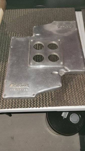

Anybody need this top plate ?
Not doing me any good.
