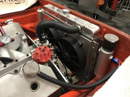

I had Wizard build one for my 65 Belvedere. I did set the engine back though.

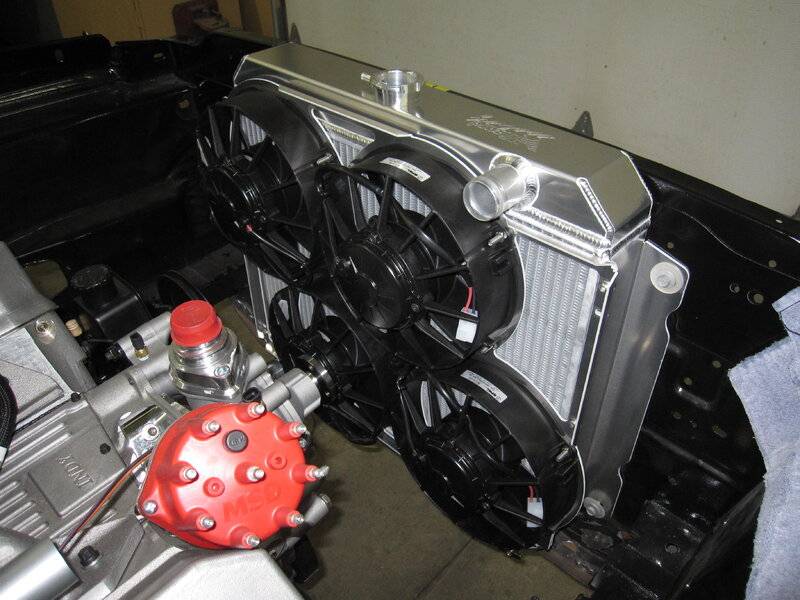

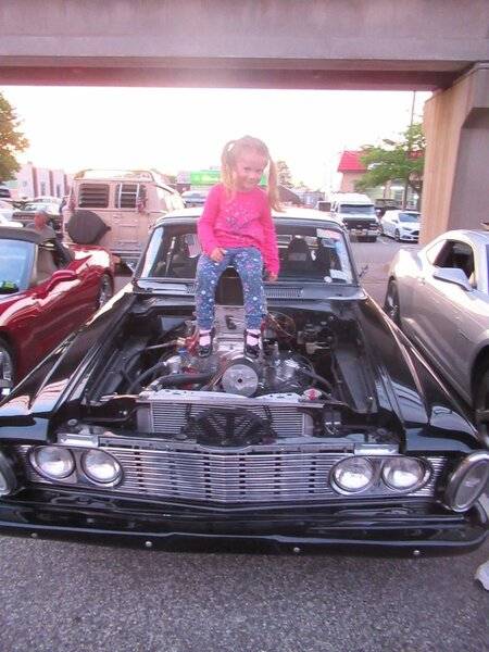

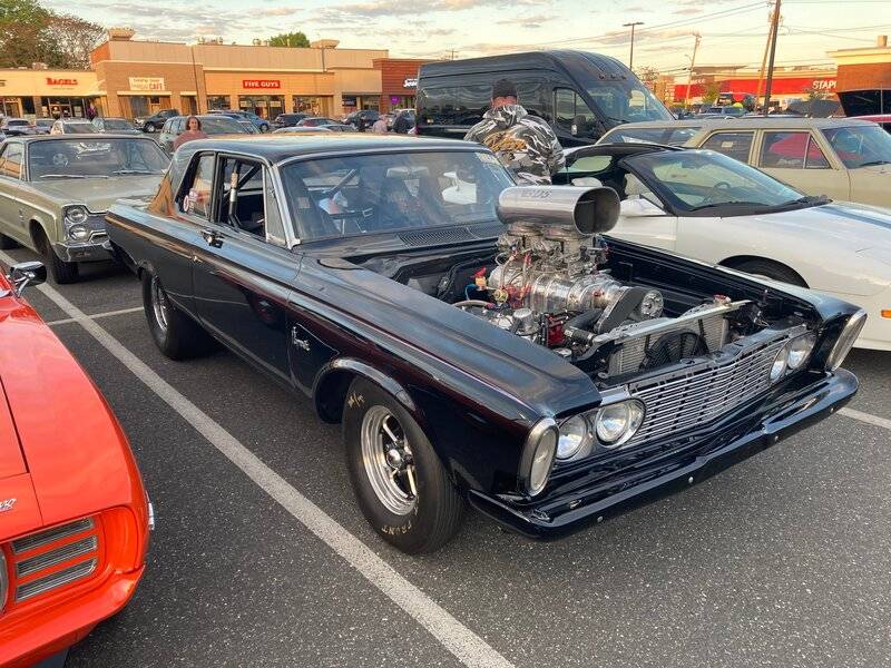

A BeCool radiator with twin pusher fans keeps my blown big block cool

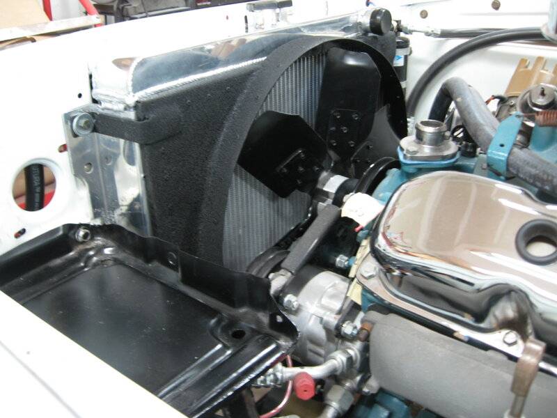

I used a Champion in my '64 Polara and a home made fan shroud. Keeps the 440 running at 180* even in the Texas summer heat.

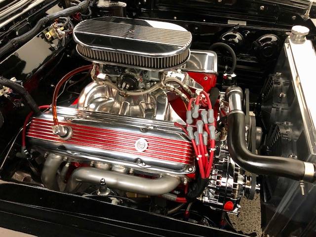

in my 63 savoy i used a griffin radiator and dual fan combo with shroud ,27 inch crossflow
Did you use a later k frame to move the engine back?. Super clean looking btw

I agree with a Wizard radiator and I have one for my 68 Barracuda but my fan is a front mounted pusher that cools very very well and its a street strip car with just shy of 1000 hp N/A
