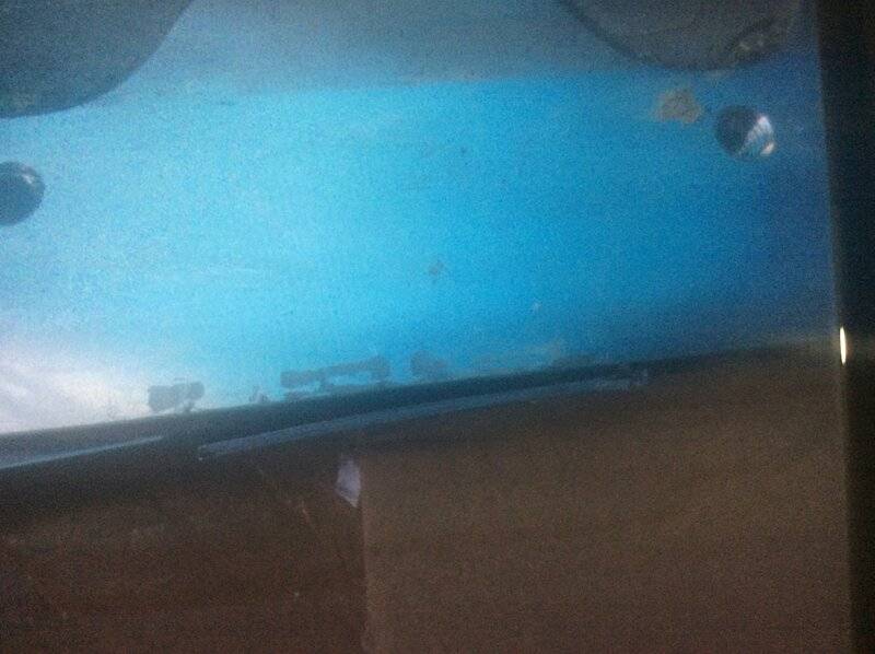

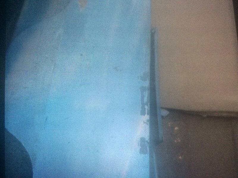

And found my problem
The head gasket tab was not cut back or the valley pan tab should have been installed between the head and head gasket so the tabs would run flush along the bottom of head the way it was designed to do
