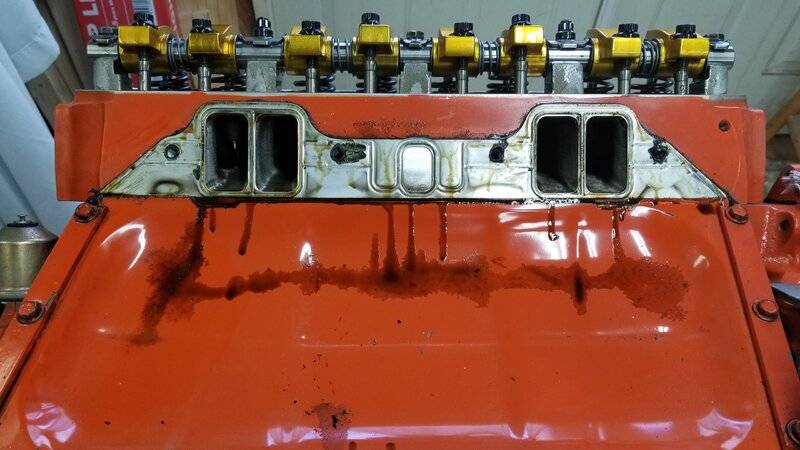

On top of my clutch issues which is on the burner right now I have some other serious problems. # 1 Stroked 383 to 450cu. Motor has less than 100 mi. on it. Seemed to developed main seal leak (I will follow the forums on this ) I took the car on expressway and got into it just a little got back to garage and the top of valley pan intake was covered with oil front to back. My other issue is every time I cold start the car it takes 4 or 5 seconds for oil pressure to come up and my roller valve train makes noise after 4 seconds all is fine 60 lbs. pressure. I have a Mellon volume pump. Why is my oil bleeding down? Called Mellon they said faulty oil filter. Changed it not the problem.Anybody have any ideas what is going on?

Valley pan oil is likely coming from the top corners of the intake/valley pan where it seals to the block. Could also be wicking up through the intake bolts too I suppose. Hard to say without seeing it

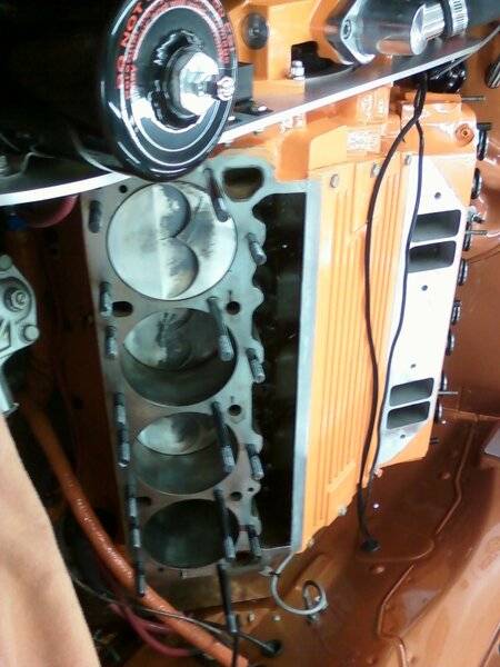

OK I started to rip into the motor
I used the 440 source valley pan with the cut out for the rpm performer intake manifold and individual intake manifold gaskets because my heads are cnc ported and was told u couldn’t use the oemstyle valley pan. Also to note I did not build the motor I had someone else

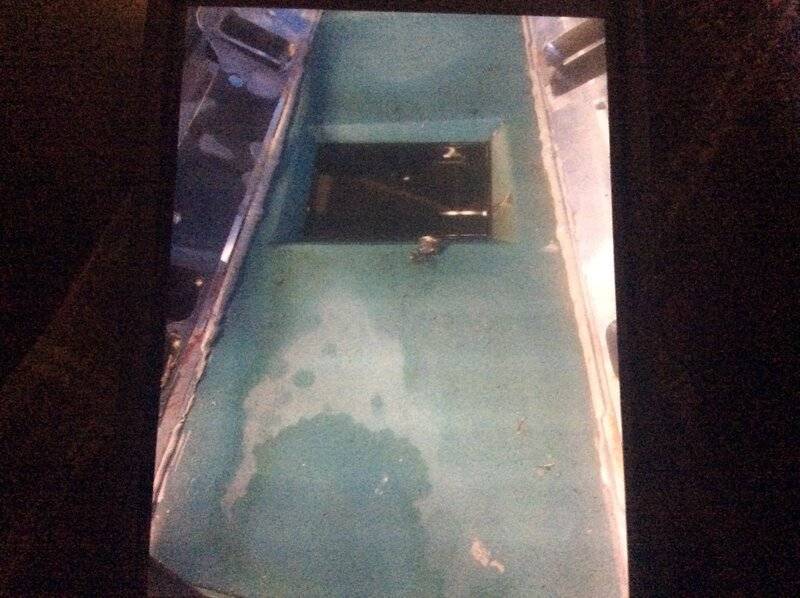

So I remove the intake and this is what I saw a pool of oil sitting in the cutout
Called 440 source and they said I have to remove the head to install and remove this type of valley pan. Didn’t want to hear this I have roller rockers and lifters so due I just unbolt the rocker shaft or is their a specific sequence I have to follow

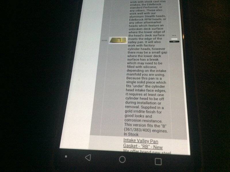

I used 440source one of the heads has to b off to install and remove this type valley pan because there is a lip on both sides that goes under the heads

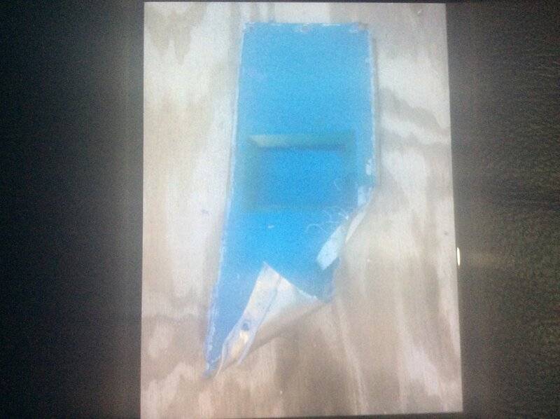

The Indy goes under the heads also. Two pics here. Once you slide it rear ward it drops into the valley.

So how do u seal along the lengths of the heads?
I suspect that is where I was leaking oil

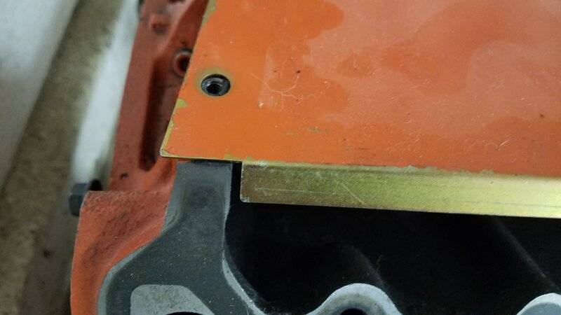

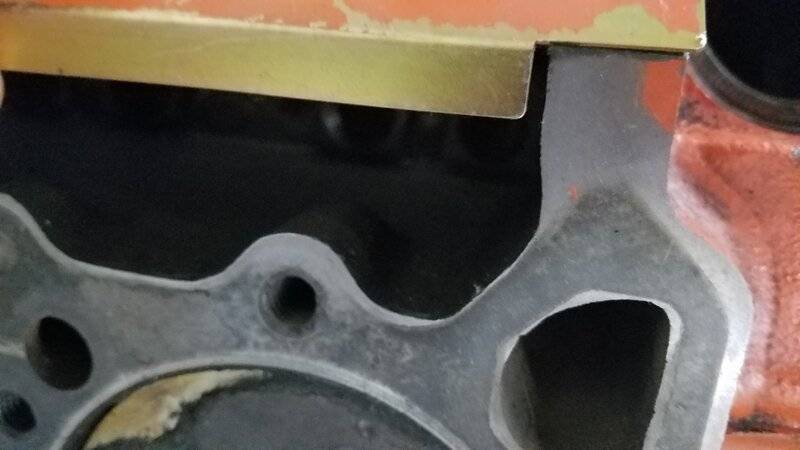

The 440 source pan is your problem...unfortunately they can't seem to make the edges that fit under the heads long enough.
Every one I've seen is like this:
Sure you have some wiggle room with the bolt holes but closing the gap at one end simply makes it bigger on the other end. I can't understand why they don't make them a little longer and let the end user file/sand/grind them to fit snugly if they end up being a little long. Silicone has it's limitations.
I like 440source but their valley trays are junk.
Oh...Hughes makes a two-piece stainless one that can be installed with the heads on, and it's edges are short at the ends as well. WTF people!
