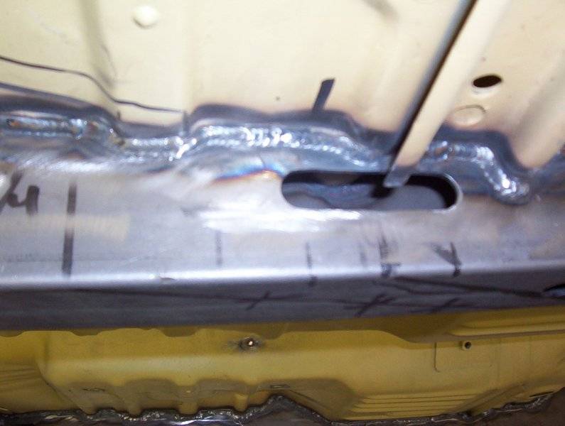

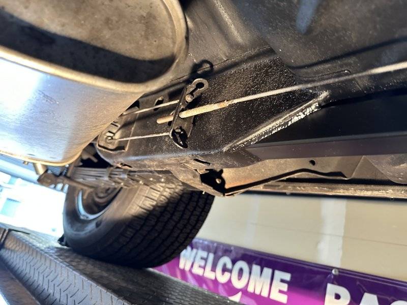

Here are my US Car Tool welded in connectors. I fit the emergency cable. I would of made some changes for brake and fuel line install if I was to do it again.
Im going to venture a guess that Pnora's frame connectors shown in post #101 above are probably stronger than both round and retangular versions by virtue of the continuous weld to the structural floor.... I would think this design is what the factory would have done, if they had deemed them necessary for street use, or at least folded over a flange so they could spot weld them in.

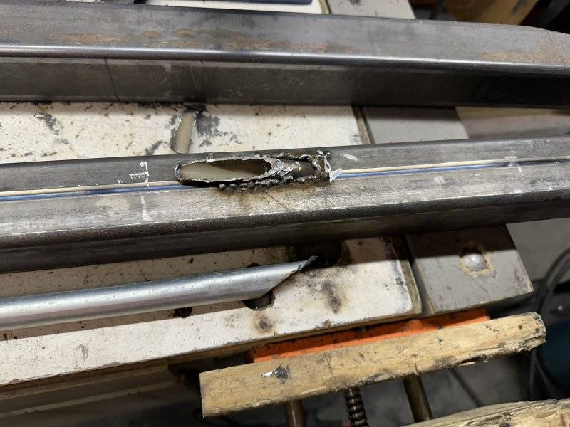

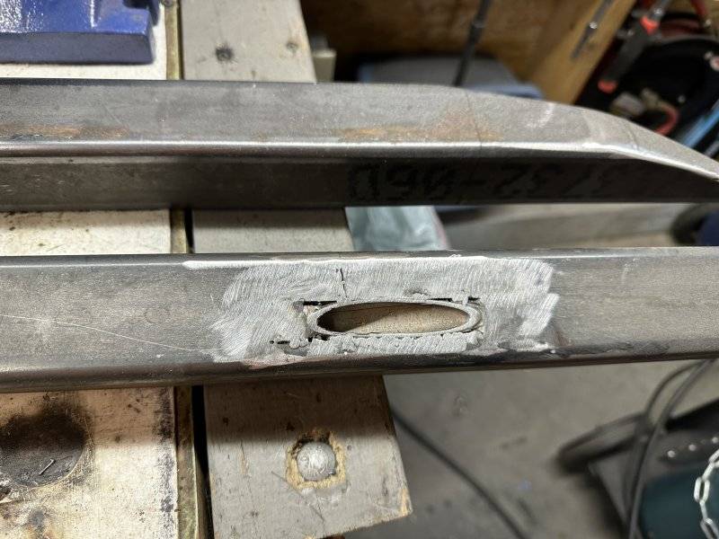

I closed up the ends and added a sleeved hole for the emergency brake cable:
(I cleaned up the weld after taking the above picture so it looks pretty :) )
your car is a 71? The underside looks a lot different than our 68-70 cars. Do you even need these added pieces? It looks like the stock floor already had subframe connectors built into the design? I'm just ignorant on this for your year car and just looking at your photos. After it's on the ground and driving, please let us know if you can feel the difference. I sure could on my 68.
It's a 68 Coronet. I probably don't need the subframe connectors since my current plan is to stroke the 400ci that the car came with) but wanted to play around a bit. And since I never actually drove the car before ripping into it, I won't have a before and after comparison (unless I can remember what my original 68 Coronet 500 felt like 45 years ago :))

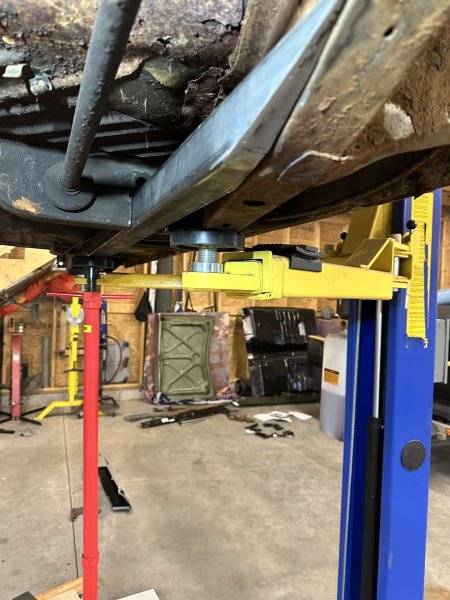

I just added these 2” sq steel tubing to my ‘68 Charger. I’ve done this subframe on other b and e bodies and it is an inexpensive alternative that greatly improves the solid feel of the car. I actually cut into the cross-brace and rear subframe, slide the steel tube into both and then weld it in. IMO this is better than a bolt on or butt-welded subframe.
