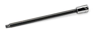

So i am close to firing up the 440 and wanted to prime the oil system. I have a pressure tank which i filled with oil and attached to the sender fitting and pumped the oil in the engie. All went well
the i figured i would prime the pump but i couldn't find my primer. so i though i would cut a 5/16 allen wrench weld to it and all that that hassle.
But, my extended torx bit that is used for the Ford 5.0 plenum to go down between the middle runners has a 5/16 hex shaft Well what do you know it worked like a champ.
it is a 3/8 drive snap-on torx bit especially designed for the 5.0

But how many of us here have one of those lol
There are a lot of Mopar people that took beginner Ford classes.
Yeah, my first engine rebuild er overhaul was a 289.....but no one ever said I needed to prime that thing lol.
Never owned a pherd. Only mopar. I made a priming tool by brazing an allen wrench to a piece of round stock. That was 40 years ago and still in use. ruffcut

When I used to work we had a number of 5.0 in the cop cars and some light trucks. All the heavier stuff were diesel Cummins and cat so I had to buy a lot of oddball stuff like the plenum torx bit
