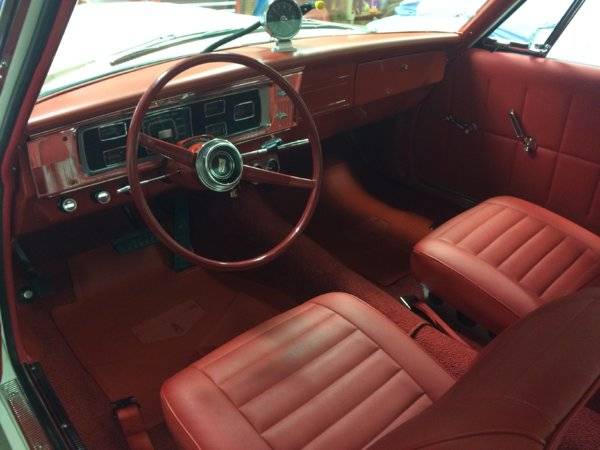

If your local Paint shop cannot locate the original formulation, do they have access to a paint colour spectrometer? If you have a sample, it could be analysed for a mix - I have done this before and it does work.
I approached my dash paint colour a little different. I colour matched the upholstery, to minimize to different shades of red, and flattened the paint for the dash top to get the suede appearance.
