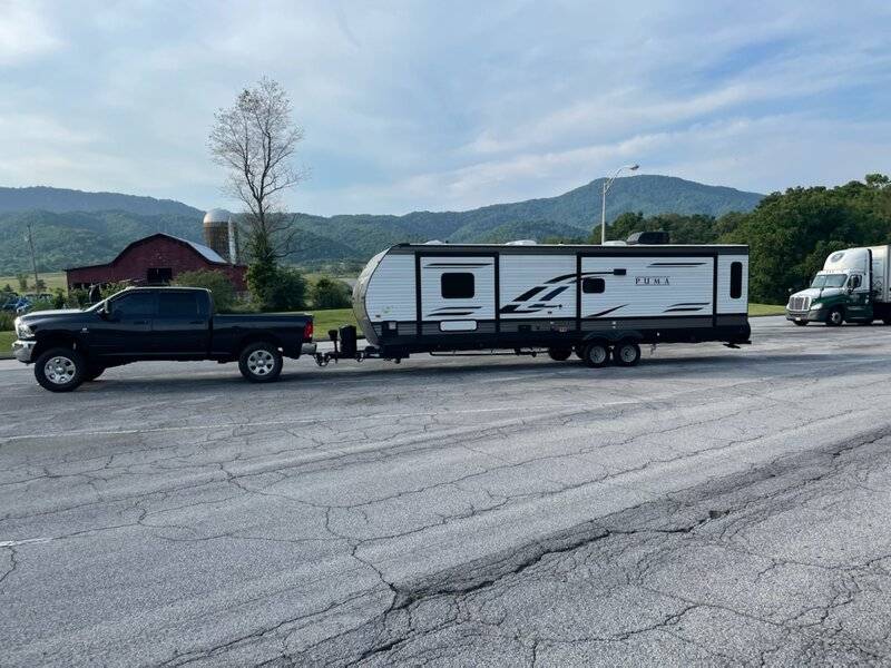

Update my friend got the sway control and a new hitch. He sent me this picture and said his friend's 2500 Cummins pulled it like a dream. He's trying to convince his wife that they need a 3/4 ton so he can trade in his 2017 1500 Silverado lol. Thanks for all the advice and help.
