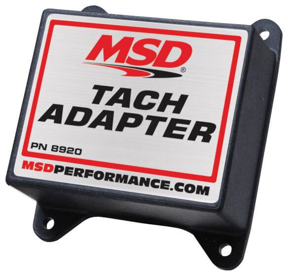

You need one of these.....
https://www.msdperformance.com/products/accessories/tach_adapters/parts/8920
ok bought the tach adaptor and still no dice. cant figure this out. any ideas why this wont work
