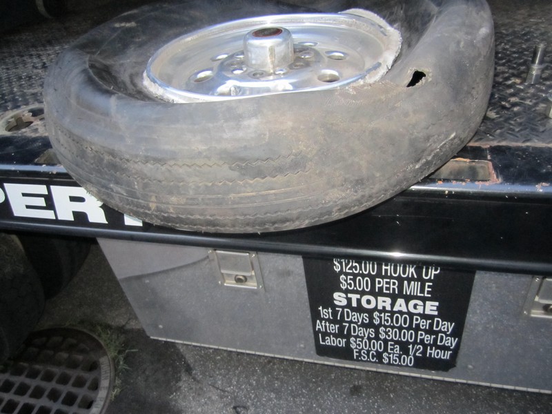

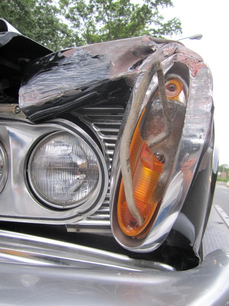

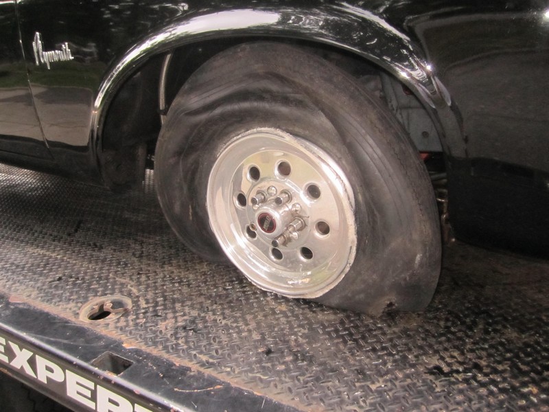

Tagged the wall at 125+ MPH,,,,,,,,,,,,,,,,,,,,,,,,
Are you sure those wheels are street strong?
My buddy had them and he bent the fronts.they didn't last 2 seasons.
I have been using Weld Draglites for over 20 years.They stoop up to everything except unusual punishment:rolling:

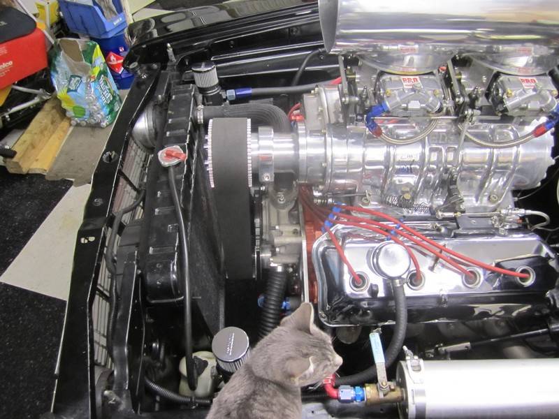

Cool pieces, are you getting allot of blow-by at boost ??, no vacuum pump or evac-exhaust nipples in the collectors, I take it, but it's a really good idea to have a puke tank anyway, especially when you pressurize the cylinders... I'll look forward to photos... Looks good
I had a evac valve go bad pressurizing the crankcase and blowing the push on breathers off the valve covers sometimes getting oil on the headers making me look like a crop duster:angry9: After I installed the puke tanks the problem was solved.

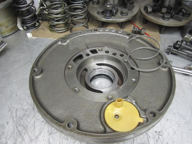

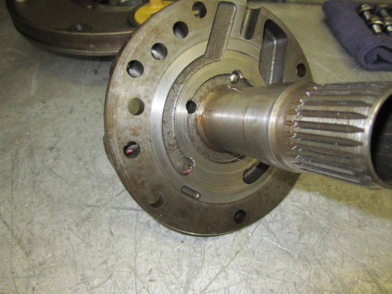

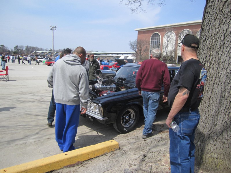

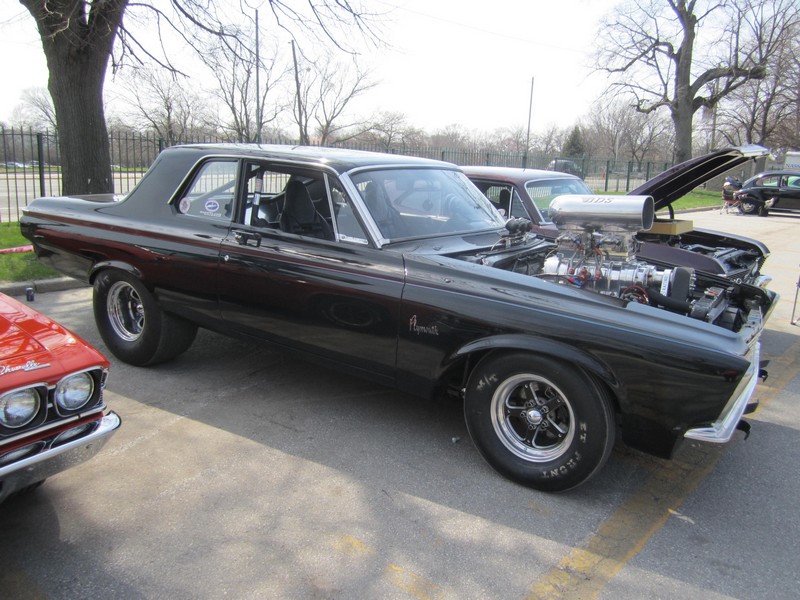

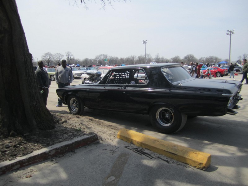

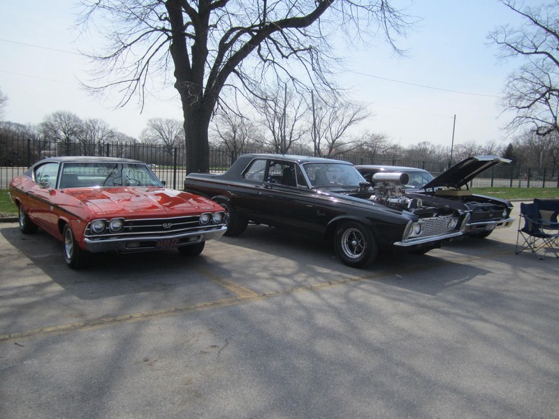

My transmission guy took the unit apart.The the stater got chewed up a little causing a pressure leak.Installed another stater and went to a car show at Belmont Racetrack. New tires hook pretty good on the street.:blob1:

as always Al looking very good glad to see your back on the road :headbang::headbang:
THanks guys,go going into the chassis shop next week then I can ordrer shocks and then I'm closr to a track date.
The loss of trans pressure meant I was operating at about 60 to 70 % of full pressure,should make a little difference.I was going over te strip at 7300RPM
She looks awesome as usual Hemi-ItIs, also the repairs look great too, I like the wheels/tires & good luck at the chassis shop, I look forward to the seeing the future runs....
