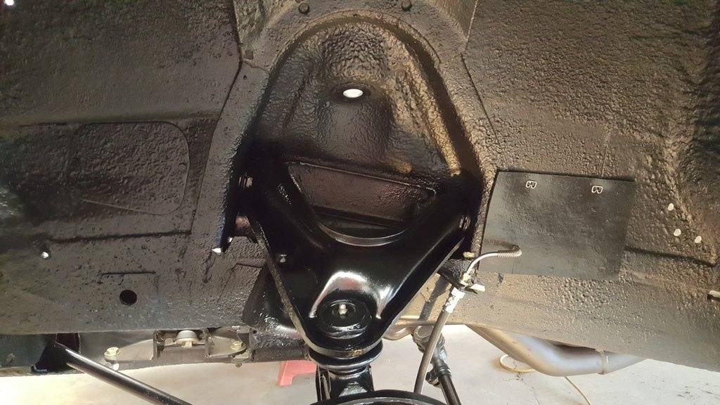

Doing the engine compartment, it looked like it was hit with a shotgun from all the chips and nicks that were in the paint. Most likely from stones entering through the rear A arm adjustment hole. 1962 didn't have the rubber covers like the later years. This one has them now.

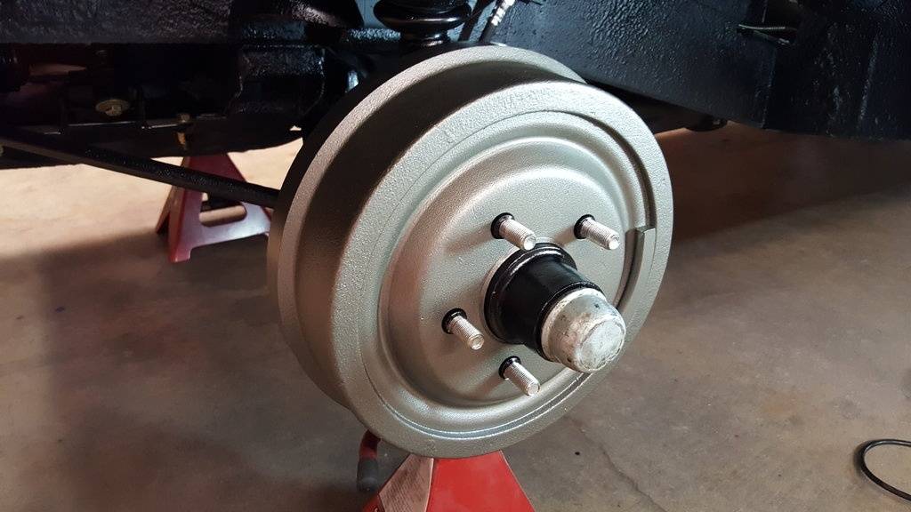

Ordered brake shoes and received these. The same as the rears but this set they decided to reline the rearward cores for the front half. The slotted hole won't work for this spring setup.

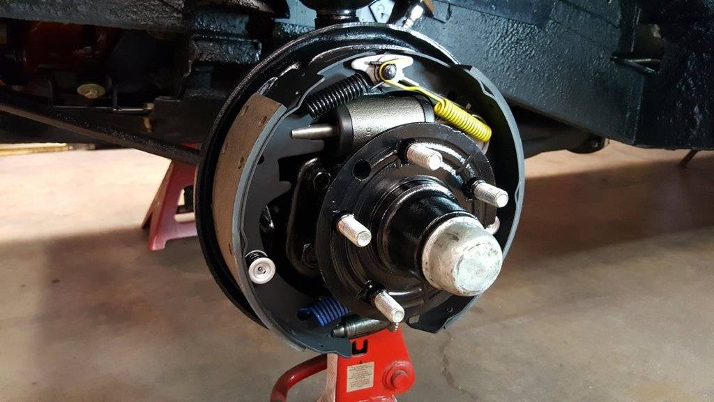

So I refurbished the new set that was already on the car. They just had some surface rust.

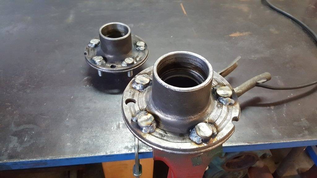

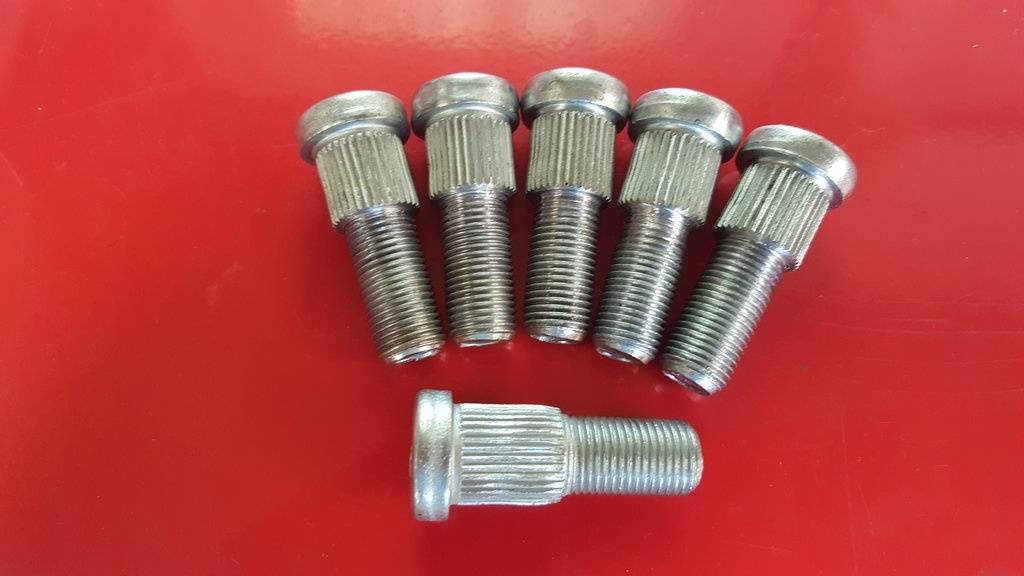

Continued on the hub upgrade and had a hard time finding the right studs. I needed a 1/2 x 20 thread, .625 diameter knurl, 1/2" long knurl. I found a couple listed here and there but they weren't available. So I got the next best thing and machined them to size.
Some of the studs fit tight, some went in tight but were loose when seated. Some of this comes from the fact that the original studs were swedged and the holes aren't perfectly round. The other factor is the knurled part of the stud isn't consistent. (See pics)
So fire up the Welder!

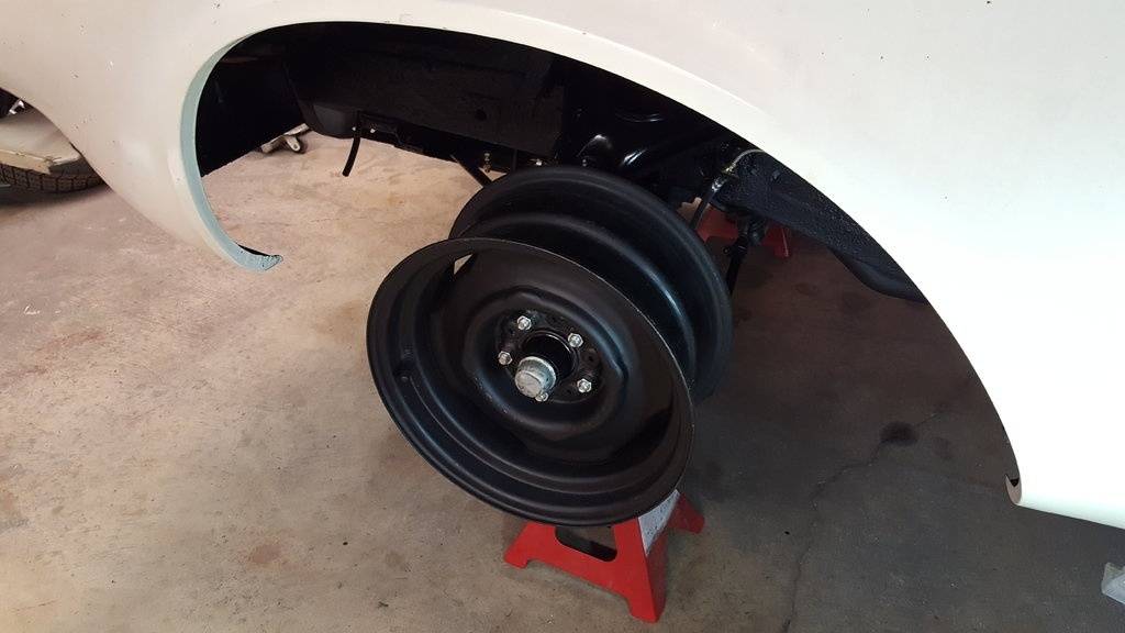

Checking the 7 x 15" wheels for clearance.

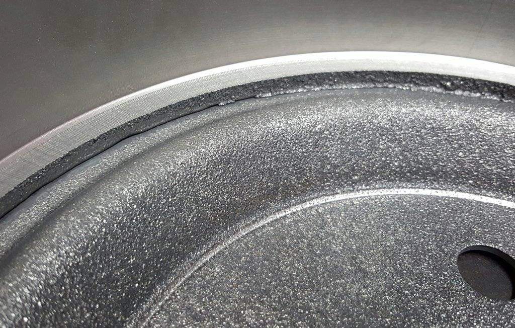

Here's the last set of drums I ordered. (Check out "Rant" thread. Damn things are cracked.
Well anyway I did use them to bleed the brakes.

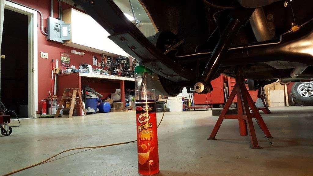

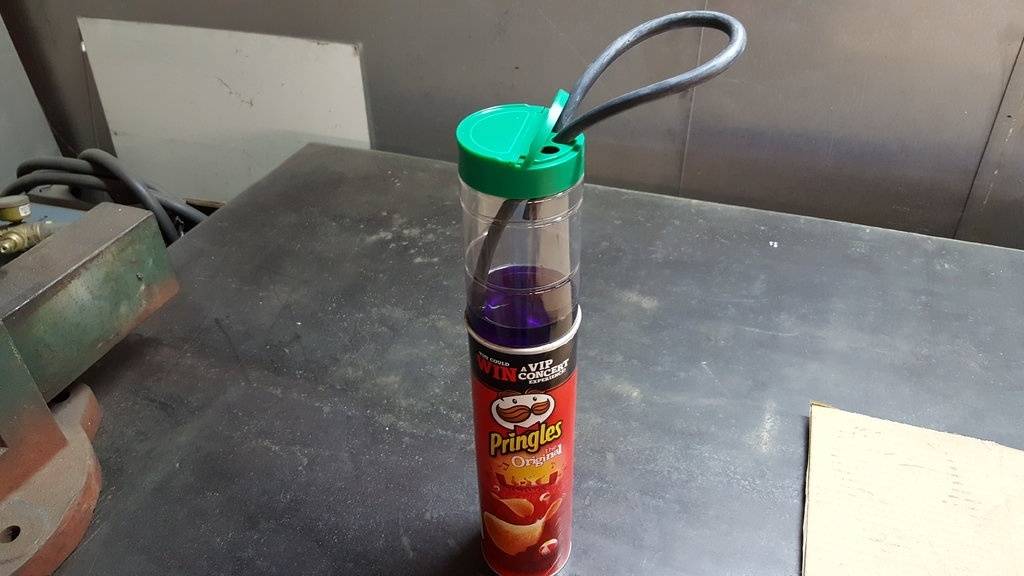

Here's my helper. Stinky cheese container, Pringle can with a section of chain inside for weight, section of hose.
Make sure the hose is submerged in fluid. Right rear, left rear, right front, left front. One time for each wheel and I had a solid pedal.
I ordered tires today. Next I'll be painting the wheels so they'll be ready for the tire shop.

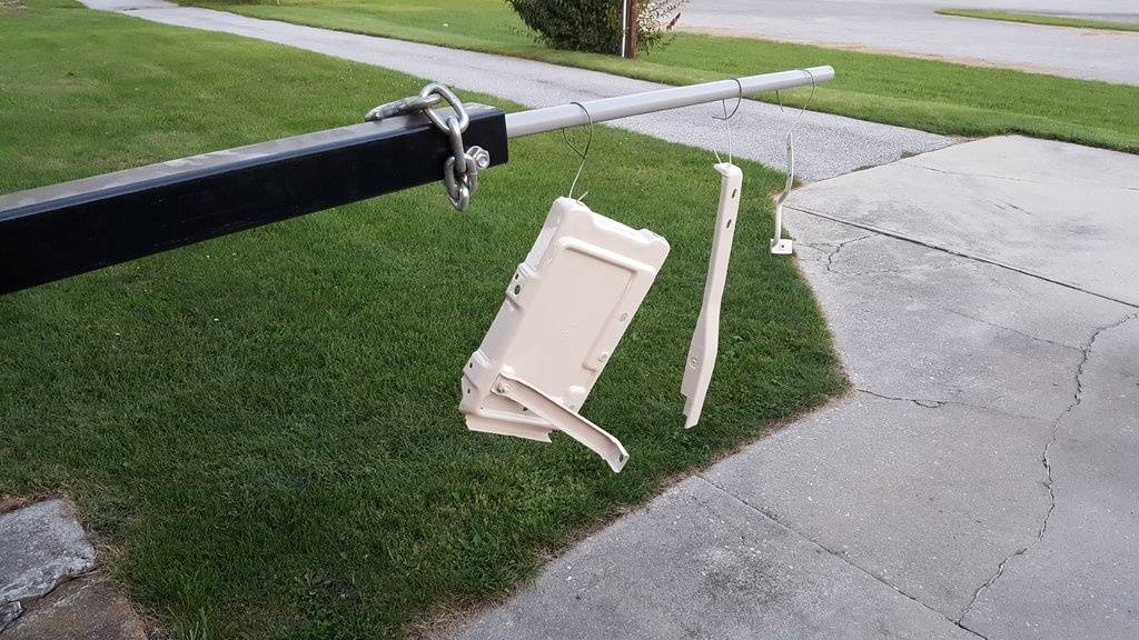

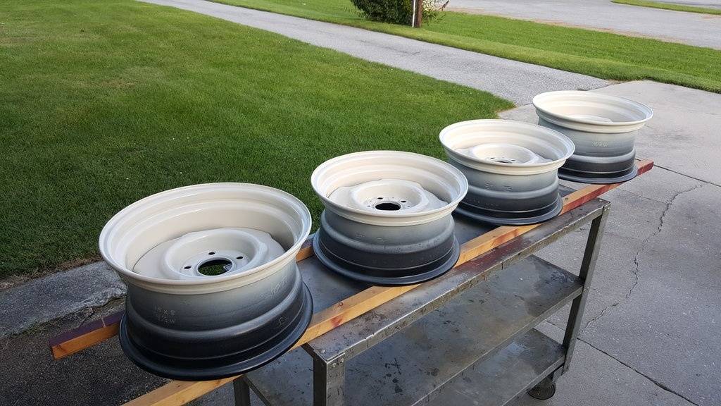

Sanded all four wheels, primered, sanded again, painted the insides black, painted the outsides body color. Shop's a mess. I'm beat!
I was getting ready to clean the spray gun, still had about a half pint left, then remembered I had some miscellaneous parts that were prepped and needed paint. Glad I remembered!
Hopefully the tire shop will call Tuesday and I can get them mounted. I have the heat cranking to 80 degs in the shop. Another set of front drums suppose to be at the parts store on Tuesday also.

Kid.. Looks like you are wrapping things up! Wheels look factory fresh! ...Lawn looks Fantastic Too! Freshly Cut?? LOL
Cant wait to see your car completed KK. Hope to see it in person one day. Wheels will look great. Love the painted wheel look.
Getting closer for sure. But you know how it goes, you're never done. I might take the day off, or not. Need to get the shop back in order at least. I need to refurbish the drive shaft. I have a new boot and u-joint and of course it needs a little paint. So we'll see.
