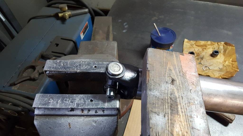

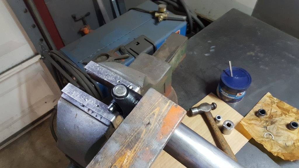

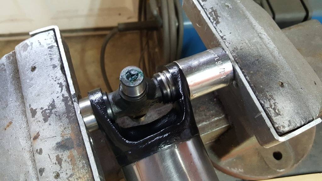

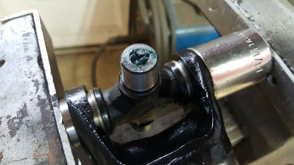

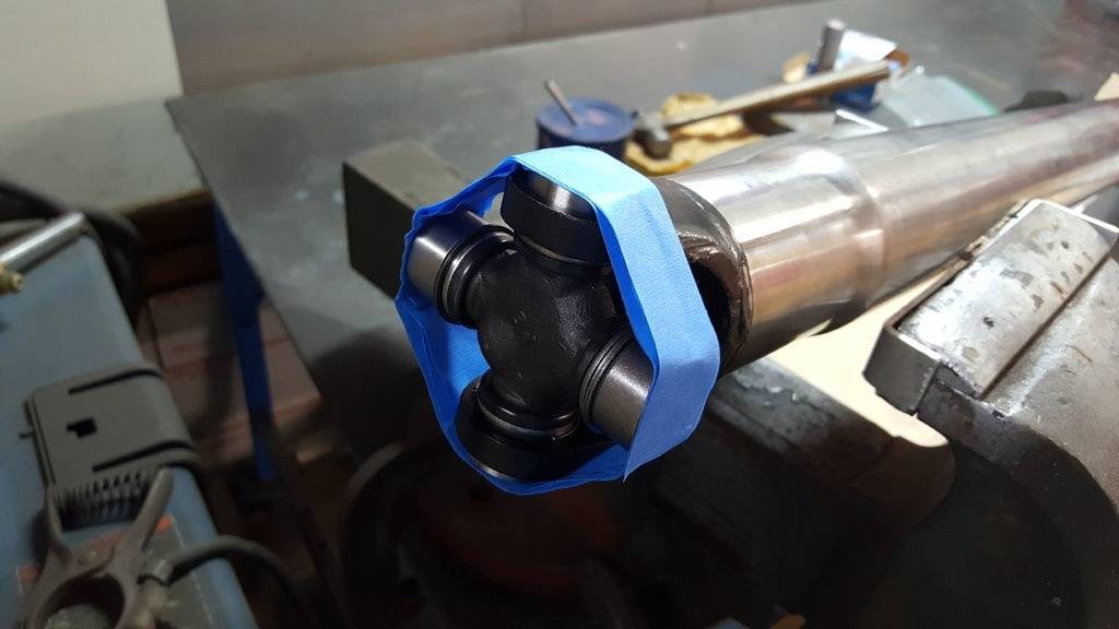

Install a c-clip on the other cup and press everything back till the clip touches. Then install the other clip.

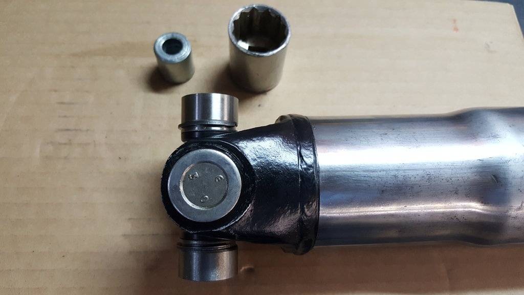

Useing aluminum under the exposed cross, take a block of wood and hammer and send the cross back to where you just pressed it from. That will seat the last cup and clip, taking any strain off of the cross from when it was pressed.
Tape up the u-joint so you don't loose anything.

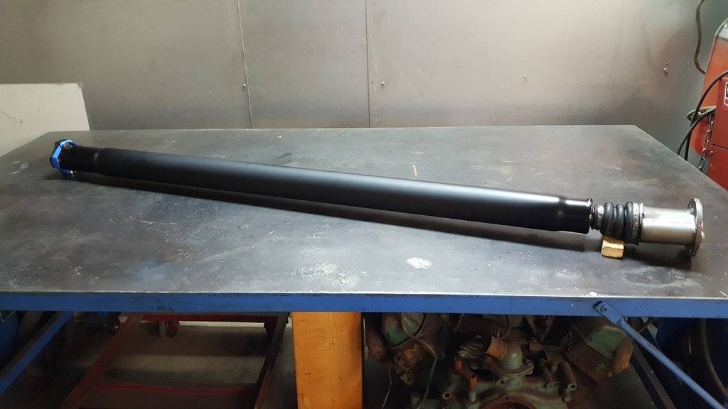

A little paint and I'm ready to install.
