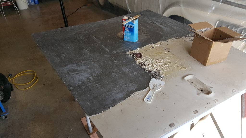

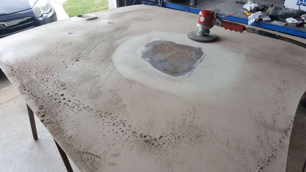

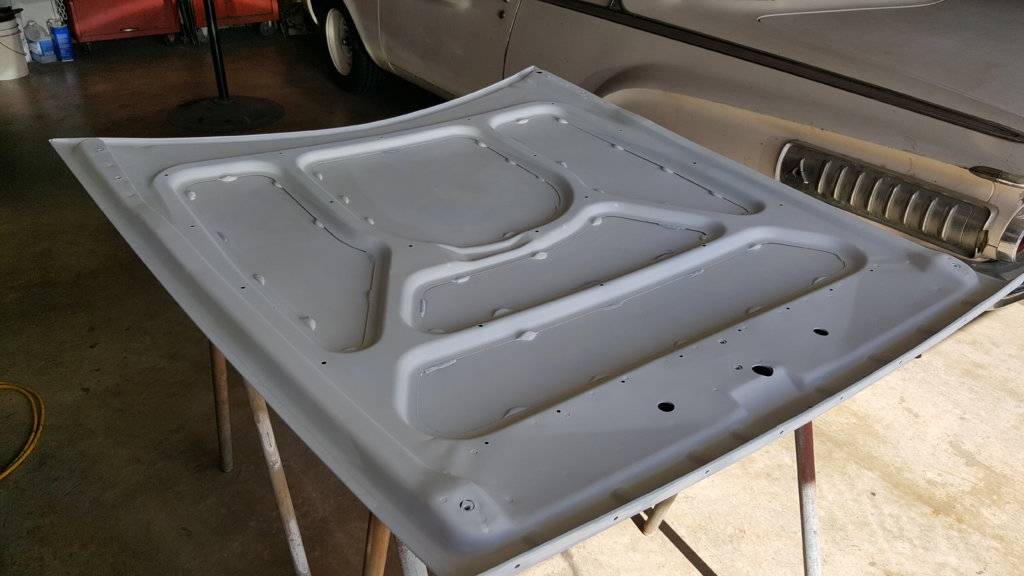

I figured that I need to get the hood presentable so I started on it. It was rougher than I thought.
It has pitted rust where someone had a tarp on it, then probably sat a five gallon bucket on the tarp. Then there are a half a dozen dents coming up from underneath. On dent was from the top down right over the frame. I tacked a bolt to it and used my sliding hammer to help it out.
I ended up useing stripper on it. Paint was quite thick and it was just easier than sanding.

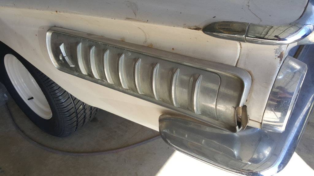

Here's the original one still on the car. No fixing pot metal.
Check out the hardware. They used these all position (I really don't know what to call them) behind the stamped nuts.
The replacement is a good "driver" piece that's better than what was on it. I'm not painting it like the factory did.

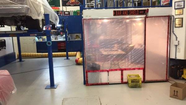

I've got a number of things to paint too so this is what I did. Temporary booth! 6 mil poly, 1" sq. tubing and a roll of tuck tape. Oh and a few furnace filters.

Thats what I would like. I thought about making a portable wall, with filters, to place in the garage door opening and a filter frame in the back service door. It's a good size, two car garage, that's deep but not enough room for a makeshift booth. So I'm just winging it when I have too. Paint early in the morning or late at night so the neighbors don't catch wind!

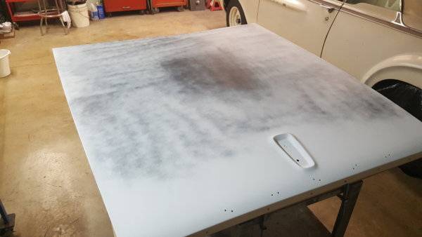

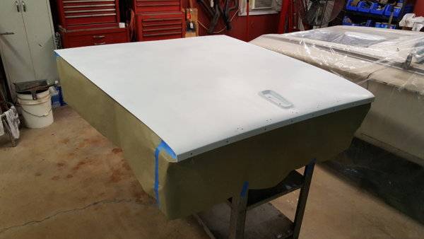

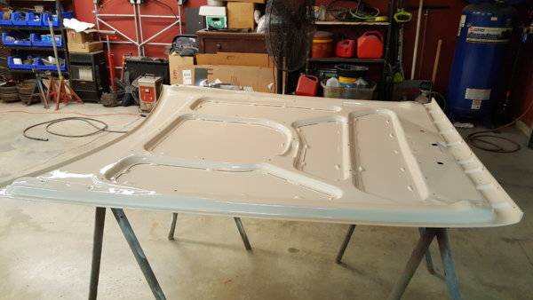

Been goofing off a little but back into it this week. Man I hate bodywork. The hood looked like they had a barn dance on it. Broke out the paint gun early this morning to beat the bugs. Especially the gnats that have been everywhere this year.
Made up a hood carrier so the underside doesn't get marred.
Turned out ok, no gnats but I got a little dirt this time from somewhere. Wet sand and buff!

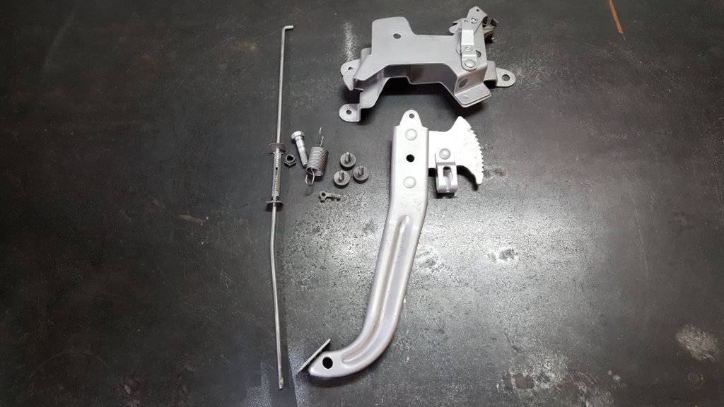

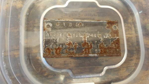

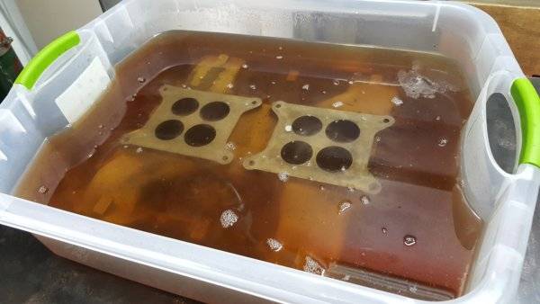

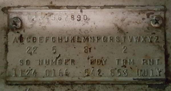

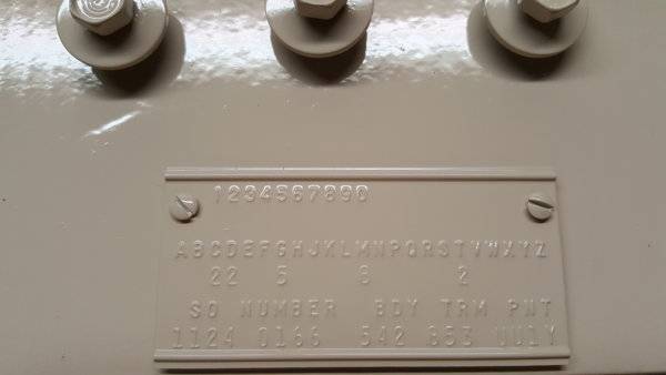

Did the old vinegar dip on the fender tag. I used stripper first to remove the paint then gave it a bath. I didn't want to dull the letters and numbers with sand paper. The tag was in good shape to start with. Painted it along with some misc hardware today. It's the little things!

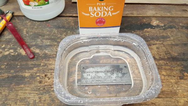

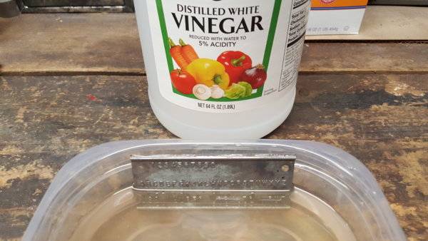

Kid.. just curious, are you using good old fashioned enamel, or base, clear? Also explain the vinegar soak recipe. I could use that one! Everything looks Great!!
I'm useing PPG single stage. Shop grade is about $36 a quart. It's the factory look in my book. Some cars just don't look right useing BCCC. Useing hardner in the paint, it's easily repaired or touched up. Being a solid color it's forgiving to chips, small scratches and can be wet sanded and buffed.
The vinegar bath is probably a lot slower than EvapoRust but it's cheap and works in a pinch. Just pour some in a container, drop in your part. You have to remove any paint first. I'll use a brush to agitate the surface every now and then. Keep a loose lid on it to keep the oder down. When it has done it's job to your liking, rinse with water then place it in a bath of clean water with baking soda added to neutralize the vinegar's acid. You'll need to dry your part right away after removing it to keep it from flash rusting.
I did my two four bll manifold, took about four days and every time I rinsed it off and dried it, it would flash rust. So I ended up dusting it in the sand blaster, blowing it out real good, then sprayed it out with parts cleaner, then WD40.

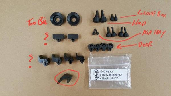

Who makes up these packs of parts that don't have what you need? Idiots!
The hood bumper in the red circle is my original. Don't see anything even close.
The hood adjusting rubbers are too big for the screw head.
The ones above the circled one look like the ones that go on fenders to keep hood away from fenders? Picture shadow can't tell, look like the ones on my 65 Dodge.
Thats the ones that I needed, between the hood and fender like the one I circled. There is only one on each side, near the back. I was thinking this set is for something newer. I'm researching again.

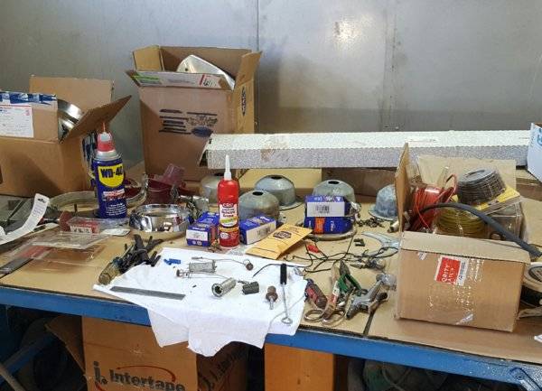

I need to replace a couple of lenses so I worked on the stash that I've been gathering over the years.
Replacing a couple of lenses leads to a total refurbished taillight system.
Cleaned all of the lenses that I needed. Cleaned and painted the taillight housings with aluminum. Cleaned and polished the best bensils.
Replaced all of the sockets with aftermarket ones. Had to break off one of the fingers to fit the tab that's in the housing.
Wiring is pretty simple. Just match up the socket with the original for the correct bulb pin orientation and color of wire.
